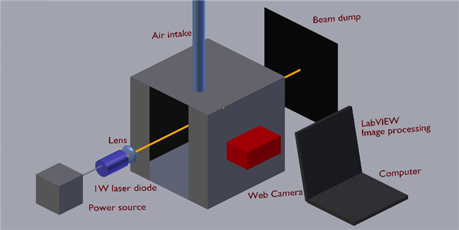

About a year ago we vave installed a HEPA cleanroom box in a university optics lab and wanted to know if it really helps to filter air. Commercial cleanroom airborne particle detectors use a laser, cost thousands and can get polluted if used in dusty rooms.
I had a 1W output 445 nm blue laser diode lying around and togather with my student gave a try. LED would be better to use thinking about eye safety. Light output from a 10W LED measured with a laser power meter was 0.25W. So 10W is the electrical power, not the optical. In the case of laser diodes 1W is optical power and consumed power is just 2W. Laser diodes are more efficient than LEDs and can be focussed much tighter visualizing smaller dust.

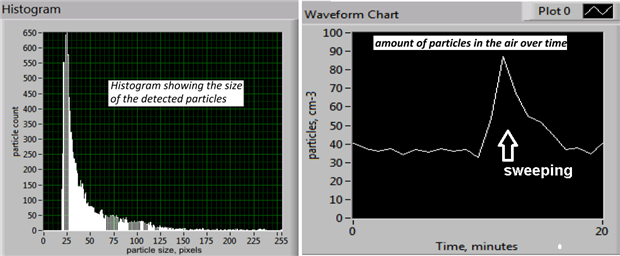

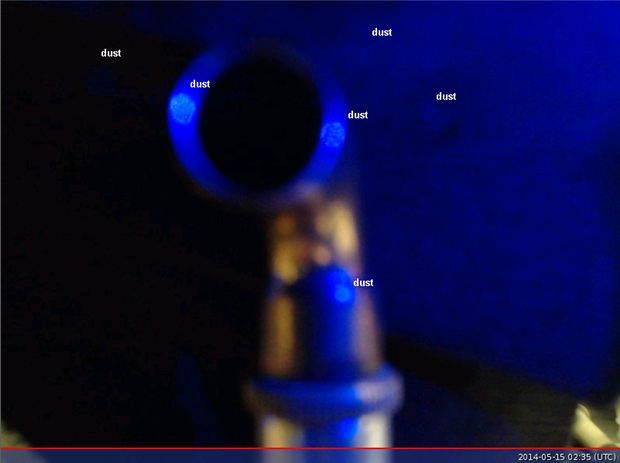

We directed laser light into a darkened chamber and recorded scattered light from dust with a webcam. Using image processing tools allows to count the number of particles in air and determine their size from the scattering intensity. The light beam has to be terminated on a bent dark surface without causing too much scattering from surface. We used LabView 2012 for image processing. LabView .vi file is attached to this post. Camera lens was defocussed, to make circle detection easier.
We can clearly see increase of particle count after dry sweeping the room. 50 particles/cm3 is actually 50 million/m3. Quite a lot!
Inside a cleanroom flowbox after a HEPA filter air is clean. Recently Electrolux has started to use HEPA13 class filters stopping 99.95% of particles in vacuum cleaners keeping air fresh after cleaning.
There are also mechanical wirpool filters, electrostatic filters and active coal filters. Latest can remove cigarette smoke odor. Odor molecules are smaller than dust but larger than air molecules.
We got some limitations. Camera frame rate of 15 fps was not enough and when some air flow was present particles smeared out from circles into lines. Smearing into lines was more pronounced when using a macro lens because  particles quicker crossed the small field of view. But macro lens was esential to be able to see small size particles. I would say that human eye is still superiour to a webcam.

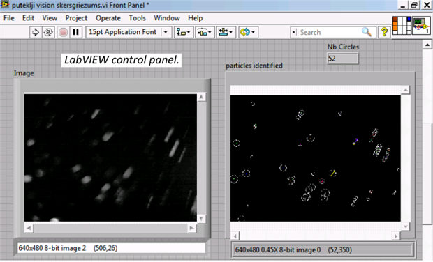

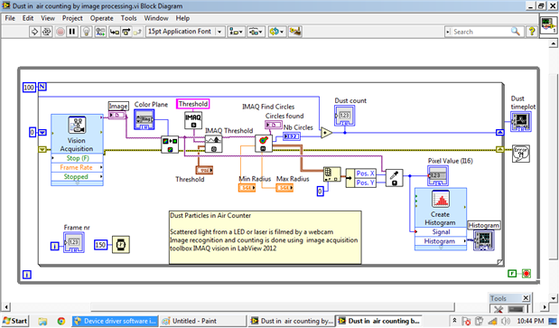

    Hello Linas!
    Thanks for your interest.
    I added a screenshot of Labview screen to the blogpost and attached a LabView vi file used to count particles.

    I tried now a 10W LED as a light source. I can see dust by eye but not very well by a webcam. With a narrow laser beam dust particles are much more visible using a camera. And it makes difference if a 50 mW or 1W laser is used. If a 532 nm laser is used one could put 532 nm interference filter in front of camera to suppress ambient light.  As a beam dump for laser I am using 30 rasor blades stacked todgather. The knife edges make light go in and it does not come out.
    Webcamera needs a macro lens as dust particles are small. Macro lens is larger than webcam lens and collects more scattered light. Such lenses can be bought on Ebay for Iphone: "3-in-1 Universal 180°Fish Eye Fisheye & Wide Angle & Macro Lens for iPhone 4s"
