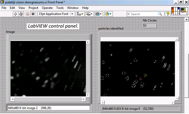

Dust particles in air scatter light when illuminated by a powerful LED or laser, floodlights or flashlight.  I have done dust counting in webcam images on a Windows PC using LabVIEW. I wanted to give a try and use  BBB for that purpose.  Particle identification and counting on BBB I planned to do using OpenCV. While OpenCV is ready to use in Processing on a Windows PC, it appeared that one needs to compile OpenCV for BBB and it could take hours and result with some error code meaning that your day has been wasted. Another approach could be used to send pictures from a BBB to a Windows server that is doing image processing and particle counting.
Home-built airborne particle counter using image processing
From your childhood probably you remember seeing dust flying around in a room in sunny days. Nowadays one can see dust flying in a dark room using a mobile phone LED. Physicists distinquish several types of scattering. Sky is blue because of Rayleigh scattering from air molecules that are smaller than the wavelength of light. Blue light is scattered more than red. Mie scattering is from particles comparable to the wavelenght of light. Unlike Rayleigh scattering Mie scattering is not strongly wavelength dependent. Geometrical scattering occures from larger particles.
About a year ago we vave installed a HEPA cleanroom box in a university optics lab and wanted to know if it really helps to filter air. Commercial cleanroom airborne particle detectors use a laser, cost thousands and can get polluted if used in dusty rooms.
I had a 1W output 445 nm blue laser diode lying around and togather with my student gave a try. LED would be better to use thinking about eye safety. Light output from a 10W LED measured with a laser power meter was 0.25W. So 10W is the electrical power, not the optical. In the case of laser diodes 1W is optical power and consumed power is just 2W. Laser diodes are more efficient than LEDs and can be focussed much tighter visualizing smaller dust.

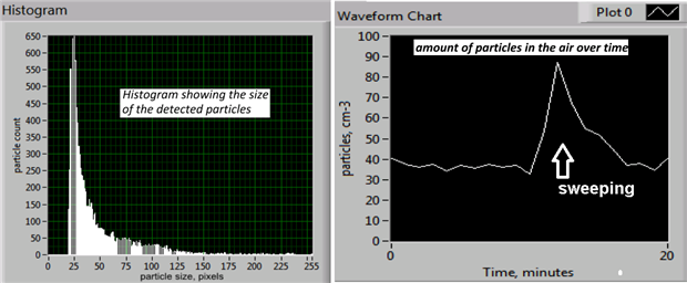

We directed laser light into a darkened chamber and recorded scattered light from dust with a webcam. Using image processing tools allows to count the number of particles in air and determine their size from the scattering intensity. The light beam has to be terminated on a bent dark surface without causing too much scattering from surface. We used LabView 2012 for image processing. LabView .vi file is attached to this post. Camera lens was defocussed, to make circle detection easier.
We can clearly see increase of particle count after dry sweeping the room. 50 particles/cm3 is actually 50 million/m3. Quite a lot!

We got some limitations. Camera frame rate of 15 fps was not enough and when some air flow was present particles smeared out from circles into lines. Smearing into lines was more pronounced when using a macro lens because  particles quicker crossed the small field of view. But macro lens was esential to be able to see small size particles. I would say that human eye is still superiour to a webcam.

  • Kilohercas
    Kilohercas over 11 years ago
    Hey, can you give my more info ( maybe .vi) how you implemented camera on labview ?
    I have a project where i need to process data from sensor, and right now i am stuck with microprocessor for image processing. I hope i can use Cypress FX3 interface to read data from camera, but for now, i am stuck with solution i have
  • janisalnis
    janisalnis over 11 years ago in reply to Kilohercas
    Hello Linas!
    Thanks for your interest.
    I added a screenshot of Labview screen to the blogpost and attached a LabView vi file used to count particles.
