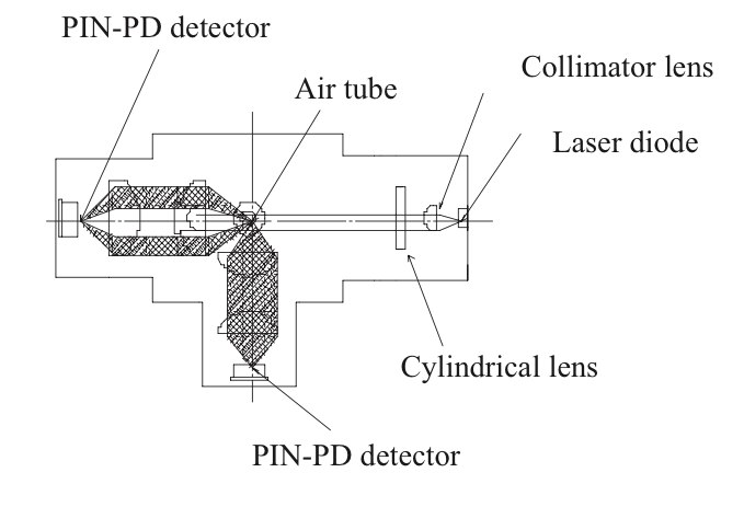

As my plan is to detect pollen, I did some research and discovered a paper on pollen sensing that proposes an idea which seems feasible (Shigeto Kawashima et al. - An algorithm and a device for counting airborne pollen automatically using laser optics).
This task would require very much hard work and could easily turn out to be a failure but I can still try. Some optics would be required - hopefully I will be able to obtain all the necessary parts to build the prototype.
Figure 2. Pollen sensor
Authors propose that red laser should be used but I think that maybe green or yellow laser would be more appropriate because pollen colour is usually the same (i.e. it reflects green or yellow). I bought the green (532nm) one locally to be used for this purpose.

    Unless you have a good stable workbench, the laser based detector will probably be too much of a challenge.
    You will need to eliminate all vibration and adjust your optics to very tight tolerances.
    Take it from me, I used to work with lasers in a laboratory setting and it takes a long time to setup and calibrate the optics.
    So I would suggest a commercial unit rather than a DIY sensor.

    So, I'm turning to my own sensor + regular dust sensor. This will be a huge effort but if I succeed it will be a huge satisfaction too image
    As for the stable workbench, I don't have an active stabilisation but I was hoping to make a sensor which will not be affected by vibration at all (optics should be very simple and shouldn't require too much precision).
