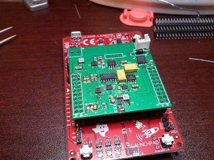

I made a video showing the population procedure. I've only placed the components I have thus far.
Here's a photo of the board BEFORE cleaning up the extra solder from the reflow process.
Here are two pictures showing the board after removing excess solder. I've plugged it into the launchpad to show how it will look in the end.
I have not powered my board yet because I was only able to sample a single piece for some components. If I destroy the component, it's game over for me! It's also possible I would damage the launchpad. I lack a current limiting power supply, so I'll have to come up with a solution.

    Thanks. I went through 4 inductors getting the board to power on without destroying anything. Seems stable enough now to test.

    That's a good looking board!
    I should be making my first surface mount soldering attempt (of my much simpler board) this week. Your posts and videos will be useful image
