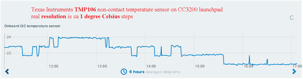

TMP106 sensor is non-contact but that sacrifices resolution. In the plot below you can clearly see that resolution is in 1 degree steps.

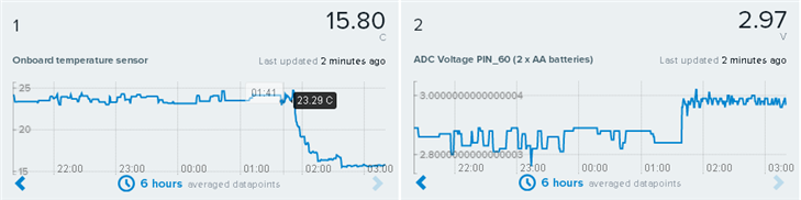

Plots of 4-channels of live data are here: https://xively.com/feeds/39457629
Plot 1 is onboard I2C temperature sensor value.
Plot 2 is battery voltage via resistor divider.
Plot 3 is conductive moisture sensor. It takes residual voltage from ADC input ca 0.6V and shortens it to GND. Soil moisture sensor from Ebay is a small PCB with 2 stripes plugged into soil. I omitted amplifier to minimize current consumption. I use a piece of shielded  cable and ADC input has a 1uF capacitor to GND.
Plot 4 is ambient light sensor. It is a 5x5 mm photodiode loaded with 1k . Photovoltac voltage that develops across the photodiode should not reach 0.6 V as there the photodiode response becomes quite nonlinear. There is a 1uF blocking capacitor as well.

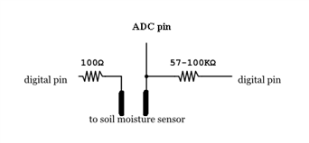

Soil moisture sensor for CC3200
Measuring resistance with a multimeter showed that it is increasing within a minute and swaping multimeter polarity showed decreased resistance that increased too. So DC probing is not a correct way. Electrolysis/electroetching takes place and oxyde resistance increases with time (capacitor get's charged)
Need to run the current both forward and reverse like in electrolytic capacitor and switch off voltage between measurements.
http://gardenbot.org/howTo/soilMoisture
I use two zink-coated nails. Sensors made of gypsum have a problem that they like to attract water, resistance drops to very low level and saturates and never really gets back. Conductivity of materials and also soil is affected by the soil temperature. This could cause a false "dry" effect. So it is adviceable also to measure soil temperature as well. Note that different soils have a different resistance. Also, sometimes, watered soil will continue to have a high resistance until the soil absorbs the water with a delay of about one hour.
  There was a problem with nails measuring moisture. Resistance had a slow tendency to steadily increase during several weeks even if the soil was watered. This is because there is permanently 0.6V DC voltage on the ADC input coming from inside the CC3200 chip. One can imagine nails being like electrodes of a battery. When battery is charged full the charging current decreases.  Another view is from chemical viewpoint that ions travel to negative electrode and polarize it so external current decreases.  A solution to this problem would be to use an external analog switch chip with  MOSFETs disconnecting nails from the circuit while not measuring. Best would be to implement AC capacitive measurement technique described here.
