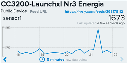

  • WiFiHivelyClient  Works nicely, but if once the connection to Wi-Fi router is lost (it happens after some hours) it does not reconnect and stops sending data. analogRead(6) measures from PIN_59.
Attempting to connect to Network named: OpenWrt ..  You're connected to the network  Waiting for an ip address.  IP Address obtained  SSID: OpenWrt  IP Address: 192.168.1.190  signal strength (RSSI):0dBm  connecting...  HTTP/1.1 200 OK  Date: Sat, 13 Sep 2014 12:18:06 GMT  Content-Type: text/plain; charset=utf-8  Content-Length: 0  Connection: close  X-Request-Id: ebabd5c32aa8091805293a803012d80cd172fbdd  Cache-Control: max-age=0  Vary: Accept-Encoding  disconnecting
After getting TMP006 to work it was easy to combine it with Xively client example.  Live feed with temperature data is here https://xively.com/feeds/363176112
Zip file with code is attached to this post.

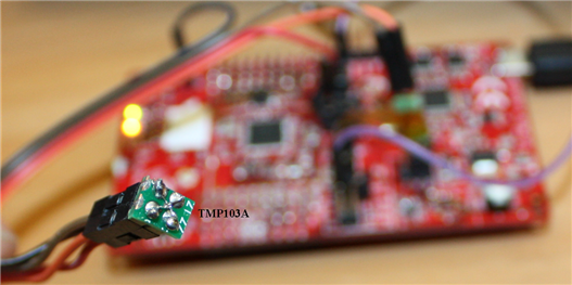

  • I2C temperature sensor TMP103A connected externally
For several applications it is desirable to have an external temperature sensor like inside a beehive or earth. It would be practical to use some I2C sensor. I got advice to use TMP103A from Texas Instruments. Different label letters have different addresses so it is possible to use several sensor in parallel.
Sensor has 8 bit resolution meaning that temperature steps are 1 degree. Tiny 4-pin BGA package I soldered using thin wires onto a 4-pin prototyping board under a magnifier glass.
It was tricky but doable. I melted some solder on the tip of the thin wire first and then touched with it the BGA pin. Note the dot on the opposite side before soldering. After soldering I could not see the dot and could find pins blindly by using a multimeter in diode mode. Connection between 5V and GND produces large resistance. Low resistance means that internal protection diodes are open.
For reading the I2C bus there is an example  Wire master_reader in Energia CC3200
It is a good idea to look on the oscilloscope at SDC and SDA signals. There should be 3.3 V present. Jumpers on J2 and J3 have to be closed as they are generating pull-up voltage.
With closed jumpers TMP006 sensor and accellerometer should be accessible.
TMP103 datasheet mentions that the sensor can be called at I2C address 0 as well. It worked as could be seen on the scope there was a reply.:
  Wire.requestFrom(0, 1);    // request 1 byte from slave device o
TI datasheet states that TMP103A address is 1110000 being 112 in decimal. Reading a byte from this address also returns the actual temperature.
Serial.print did not work and showed some strange ASCII character. Had to change the line:
    char c = Wire.read(); // receive a byte as character
    int c = Wire.read(); // receive a byte as character
Now the Wire example program printed on serial terminal temperature value in degrees Centigrade.
23  23  24  25  ...
