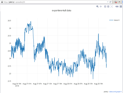

Real-time temperature upload to Plotly with date as x-axis
I was uploading from a Linux PC every 5 min. Future improvement would be to count data points: 288 for 24 hours or 2016 for 1 week and to start a new plot afterwards.
https://plot.ly/~janisalnis/20

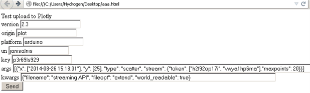

Plotly upload from a html page
Another possibility is to compose such a html page and open it in a webbrowser.
It will not work on CC3200 because no webpage will be open. But it is a good try for syntaxis.
<html> <body>Test upload to Plotly
<FORM action=" http://107.21.214.199/clientresp" method="post">
version <input TYPE="text" name="version" value="2.3"/><br>
origin  <input TYPE="text" name="origin" value="plot"/><br>
platform <input TYPE="text" name="platform" value="arduino"/><br>
un <input TYPE="text" name="un" value="janisalnis"/><br>
key <input TYPE="text" name="key" value="p3r69ls929"/><br>
args <input TYPE="text" name="args" size="150" value='[{"x": ["2014-08-26 15:18:01"], "y": [25], "type": "scatter", "stream": {"token": ["h2f92op17i", "vwya1hp6ma"],"maxpoints": 20}}]'/><br>
kwargs <input TYPE="text" name="kwargs" size="100" value='{"filename": "streaming API", "fileopt": "extend", "world_readable": true}'/><br>
<INPUT type="submit" value="Send">
</FORM></body></html>
Server response printed on a web browser screen was:
{"stream-host": "http://stream.plot.ly", "stream-status": "All Streams Go!", "url": "http://107.21.214.199/~janisalnis/19", "filename": "streaming API", "warning": "token not in streamObj or len(token) != 10", "error": "", "message": ""}

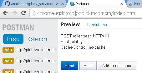

Postman - REST Client app for Google Chrome
A very useful application. It allows to see what data are sent in GET and POST requests.
It was very important to verify what POST message actually needs to be sent (Length of the message is not shown, that needs to be calculated manually when programming in C code).
POST /clientresp HTTP/1.1
Host: plot.ly
Cache-Control: no-cache
