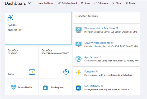

Choosing A Platform
To connect my bike lock to the Internet of Things, I needed to find a platform which allowed me to easily upload and control the data that I push from the STM32 Nucleo board to the Internet and eventually the users device. After looking into multiple options, such as Amazon's AWS, Microsoft's Azure, and IBM's Watson/Bluemix. Based on my experiences with the sign up processes and amount of documentation I chose to use Microsoft's platform moving forward. After making this choice I was also lucky enough to have $100 in free Microsoft Azure credit given to me at a tech talk I attended.
You can find more information about all 3 platforms with the following links:
IBM Watson/Bluemix
Amazon AWS
Microsoft Azure
Microsoft Azure and IoT Capabilities
I started connecting to Microsoft Azure by following the documentation. I first created an IoT Hub, and Event Hub and a Device Provisioning Service, and linked the three services/hubs together. Once this was done I went into the IoT Hub and added a device, which allowed me to get my connection string and keys which I will use to connect the STM32 Nucleo to the IoT Hub.
I will now be focusing my work on linking my STM32 Nucleo, sending data from the sensor board, and pushing that through to my Ionic application.

    I was lucky enough to get a tutorial of the Azure platform when receiving my credit, so I am finding it useful. Also the fact that ST Micro has a library that allows the STM32 L476RG board to communicate directly with the platform is also part of the reason I went this direction.

    Just a word of caution on using Azure IoT, I was also one of those lucky folks who was given 100$ credit to try out Azure IoT about 3 months ago and can only advice you to keep an eye on the dashboard, and have the things that you don't need shutdown as I have seen the credit get used up at an exponential rate after a couple of weeks..
