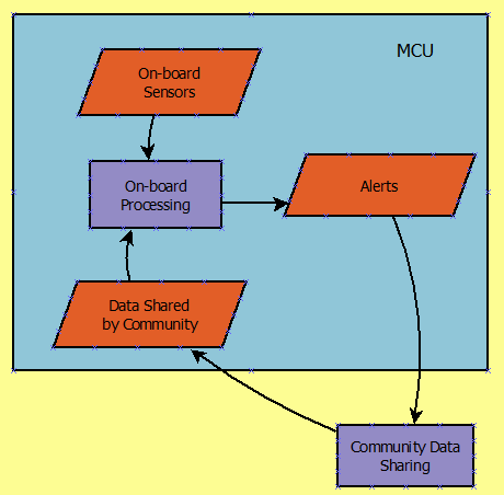

I'd like to build a collaborative system, that will connect different participants on the wheels. They will be able to share data collected during their travels, Especially valuable will be data related to events like emergency breaking, collisions, crashes, this data will be linked to the position, speed and other information collected from the sensors.
Description - What and Why
There are different types of wheals on the road. You may ride your bike, drive a car, commute by bus/train or getting around in a wheelchair. The road may be full of surprises. Not all of them are good for you.. It will be great to be prepared for unexpected. How about to be advised by a friend or community in advance?
These drawing illustrates a high level idea of sharing information with community, where all participants going to benefit from the shared data. On-board Processing component is using on-board sensors and data shared by community to generate real-time alerts. These alerts then get passed to the community.

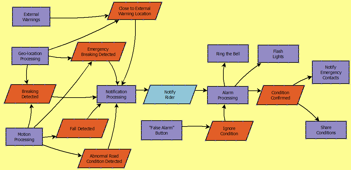

How
These drawing illustrates how real-time processing should work. The real-time processing is enabled by on-board components.Once a condition is detected the notification will be created. In case of "false alarm" it will be manually suppressed. In addition to sharing valid alerts with community emergency contacts may be notified in case of dangerous situations.
The components provided by Element14 and the sponsor will be complemented by a GNSS receiver, a buzzer, lights, rechargeable battery and a button.

    Thank you very much for clarification. I have some additional question about the Fall detection still. This MotionFD library was designed to detect the falls when a person is walking, standing and suddenly…

    Thank you very much for clarification. I have some additional question about the Fall detection still. This MotionFD library was designed to detect the falls when a person is walking, standing and suddenly falls down (e.g. social alarm for elderly people). In your case I believe you consider it for bike riding fall detection, maybe for the wheelchairs but not at all for cars. It will be quite interesting to see how the MotionFD can handle these cases while you experiment, I would expect much different dynamics of a bike rider vs. MotionFD capabilities. Thank you for additional comments and looking forward to see your next blog post.

    Thank you for the feedback. I've described my exploration of Fall Detection in the following post: IOT on Wheels Design Challenge - Smart Drive - Exploring MEMS board X-NUCLEO-IKS01A2 with Unicleo-GUI - Blog #3
    I still need to explore breaking/emergency breaking detection options as I can use X-NUCLEO-IKS01A2 sensors as well GPS velocity data. I hope to detect abnormal road condition by reading data from X-NUCLEO-IKS01A2.
