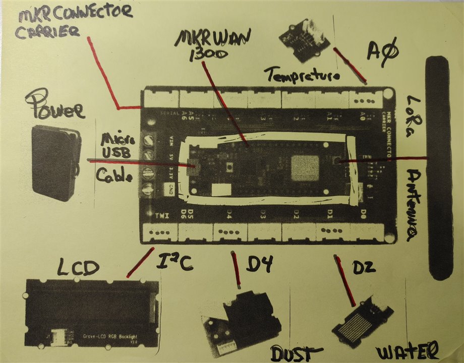

  • Wiring Diagram
    • All the sensors mentioned in the previous section are connected to the Arduino Connector Carrier with a Groove Cable connected to the designated connectors.
    • One end of the cable is attached to the Grove sensor and the other to the Grove connector on the Carrier.
      • The LCD Display is attached to the TWI ()I2C) connector
      • The TEMPRATURE sensor is attached to the analog A0 connector.
      • The DUST sensor is attached to the digital D4 connector
      • The WATER sensor is attached to the digital D2 connector
    • The Arduino MKRWAN 1300 Is attached to the Connector Carrier in the relation shown below
      • For POWER, the AdventureMax 10000mAh is attached to the USB connector on the MKRWAN 1300
      • The LoRa Antenna is attached to the antenna connector on the MKRWAN 1300
    • BLOCK DIGARAM
      • Here is a diagram of components:
        • image

    This Sketch, will be used to transmit LoRaWAN packets to the MKR2 LoRa Receiver board.
    it will have 3 Grove sensors and 1 Grove LCD display connected to the Arduino MKR Connector Carrier.
    a MKR WAN 1300 (MKR1) is attached to the Carrier.
    one by one, each sensor is read.
    after each sensor is read, a LoRa packet with the sensor value is sent
    In the packet send function the value is displayed on the LCD display.
