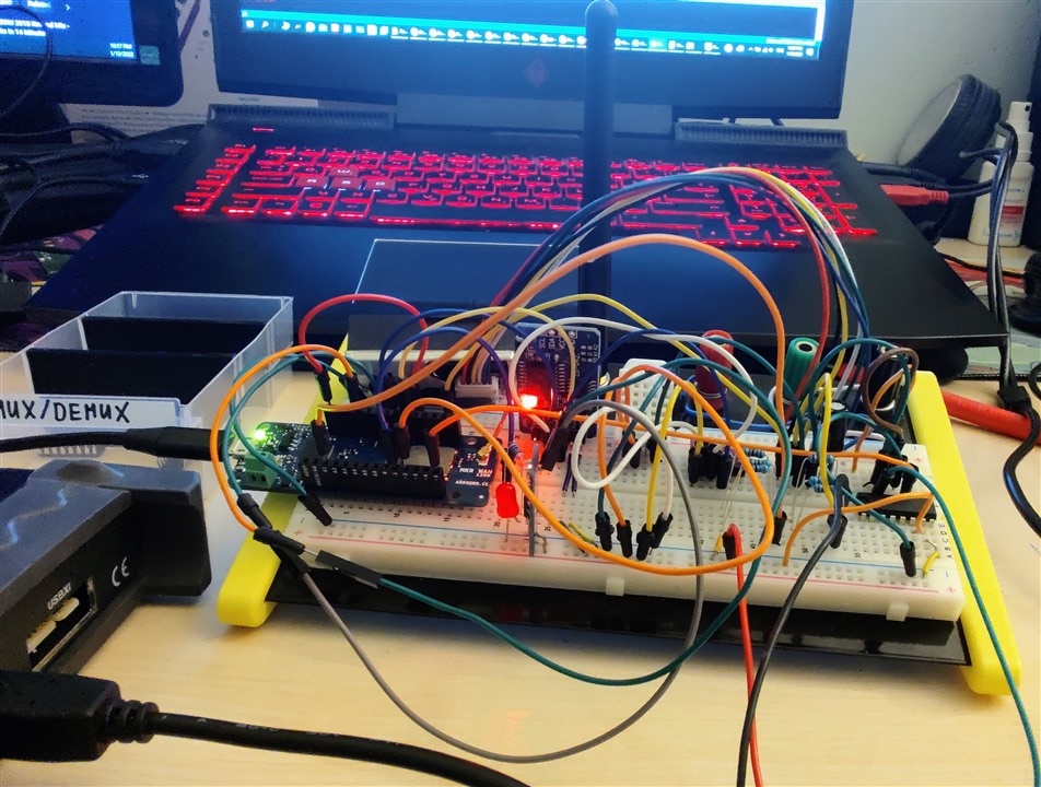

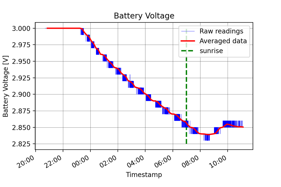

I gathered the sensors I will be using in the SensorBox (DHT22, BMP280, HL-83, and an RTC) put them all on a breadboard with one of the Arduinos, and using a USB power bank, I had my first Sensor Box prototype!
Besides the components I've mentioned above, I added a small red LED which would blink every time I tried sending a LoRa message. To conduct the experiment, I took the sensor box prototype and started walking from the house, while someone in the house was monitoring if the messages were received on that Arduino. That was easy to do since every message besides readings had a counter for the number of each message sent from the sensor box, so it was just a matter of looking if the message numbers were consecutive. The other Arduino was placed just outside the house on a 2m USB cable. With the setup sorted out, I started going through the yard and then through the neighborhood carrying the sensor box prototype.
Everything worked great! My idea with this test was to see what kind of range I could get with that setup. Looking at Google Maps once I got home, I determined that the max range at which I was able to send and receive messages was around 150m by air (but there were around 6 houses in the direct line of sight since it is a pretty tightly packed neighborhood). For the beginning, I was planning on conducting tests in my yard for the most part, so these were some awesome results!

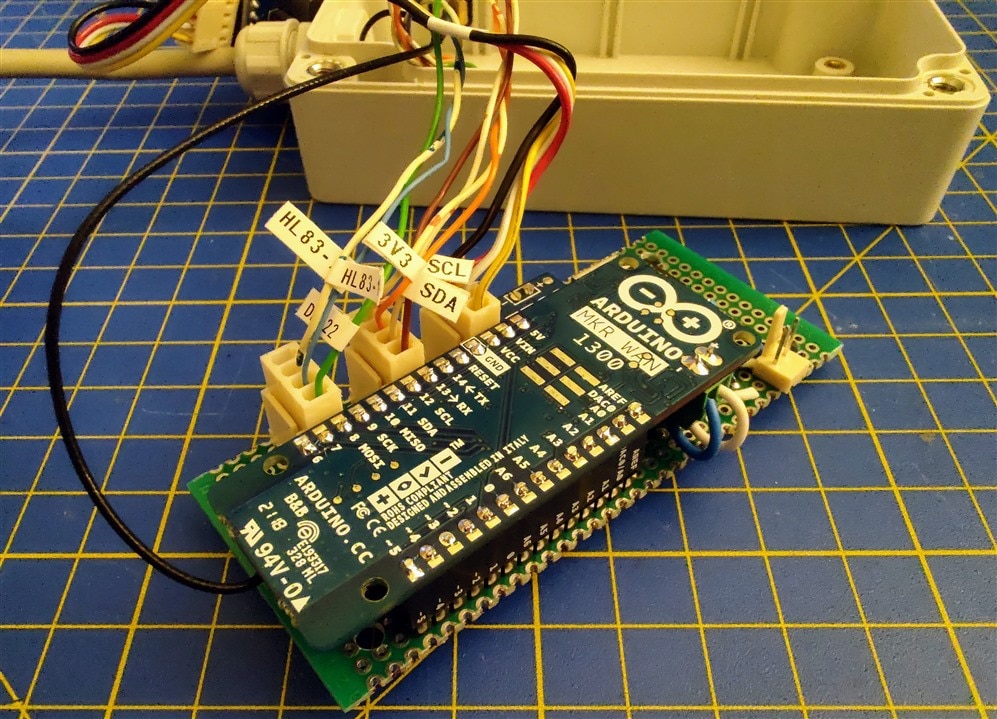

My initial idea was to have everything connected to power via the MOSFET so I can turn ON/OFF the sensors to save more battery life, but that didn't work out as planned so I had to abandon the idea for the most part since I'm running low on time. RTC and the BMP280 are connected to the Arduino using I2C, while the HL-83 sensor is just connected to an analog pin. DHT22 is connected to one of the digital pins. Another thing I'm measuring is the battery voltage with the built-in voltage divider on the Arduino.

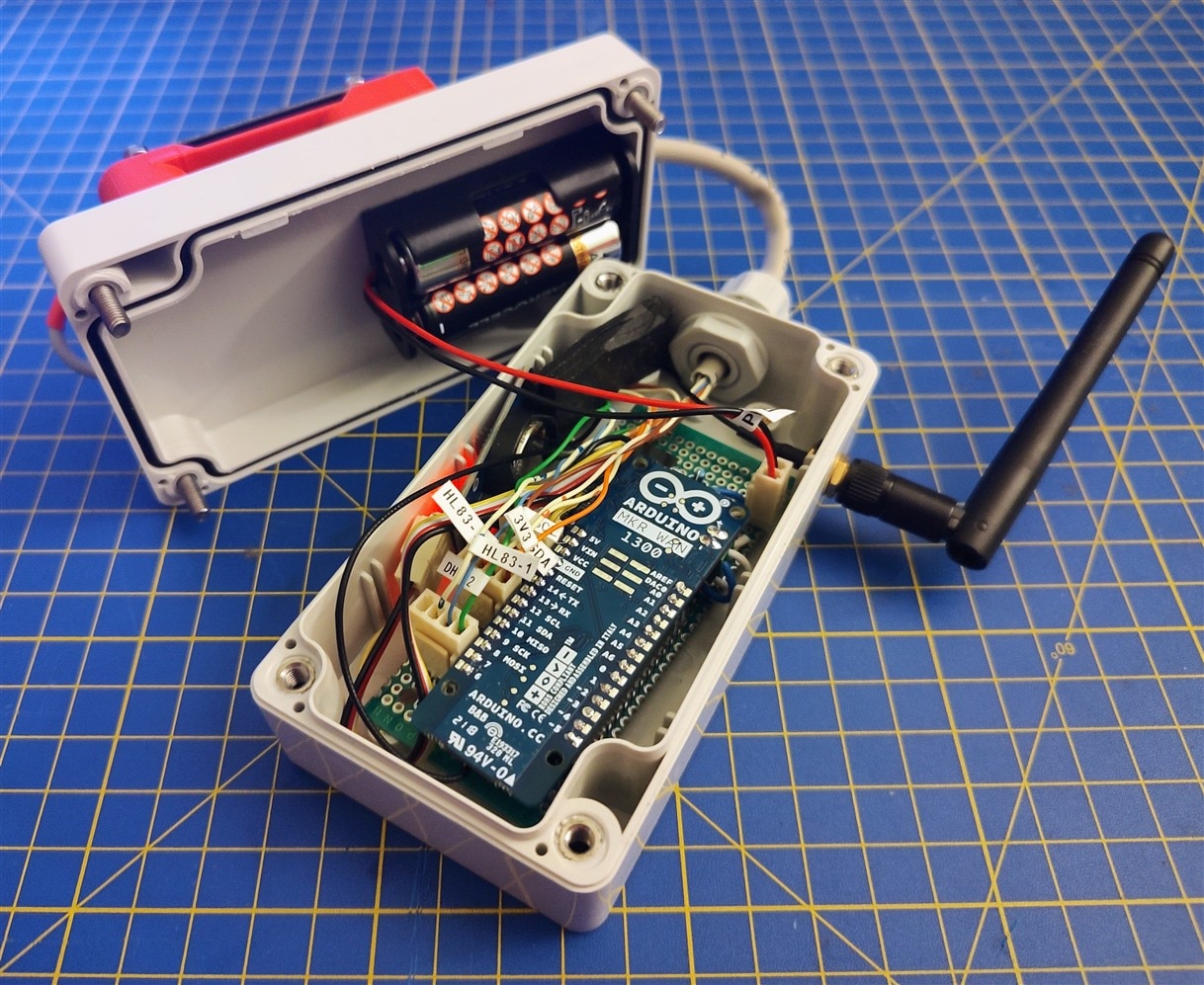

Design

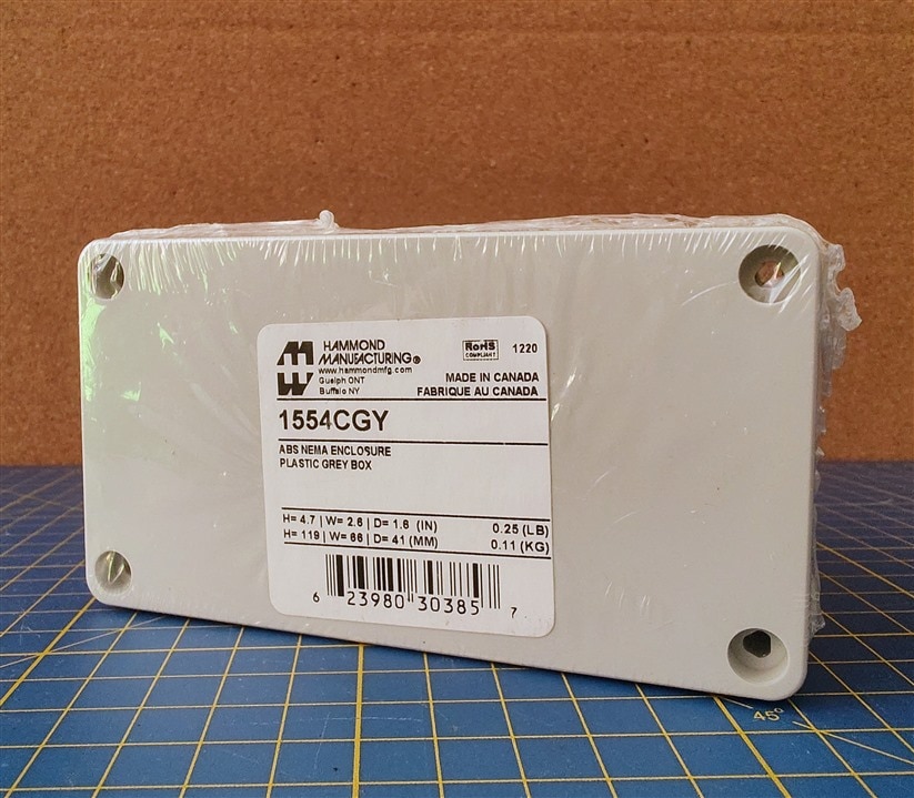

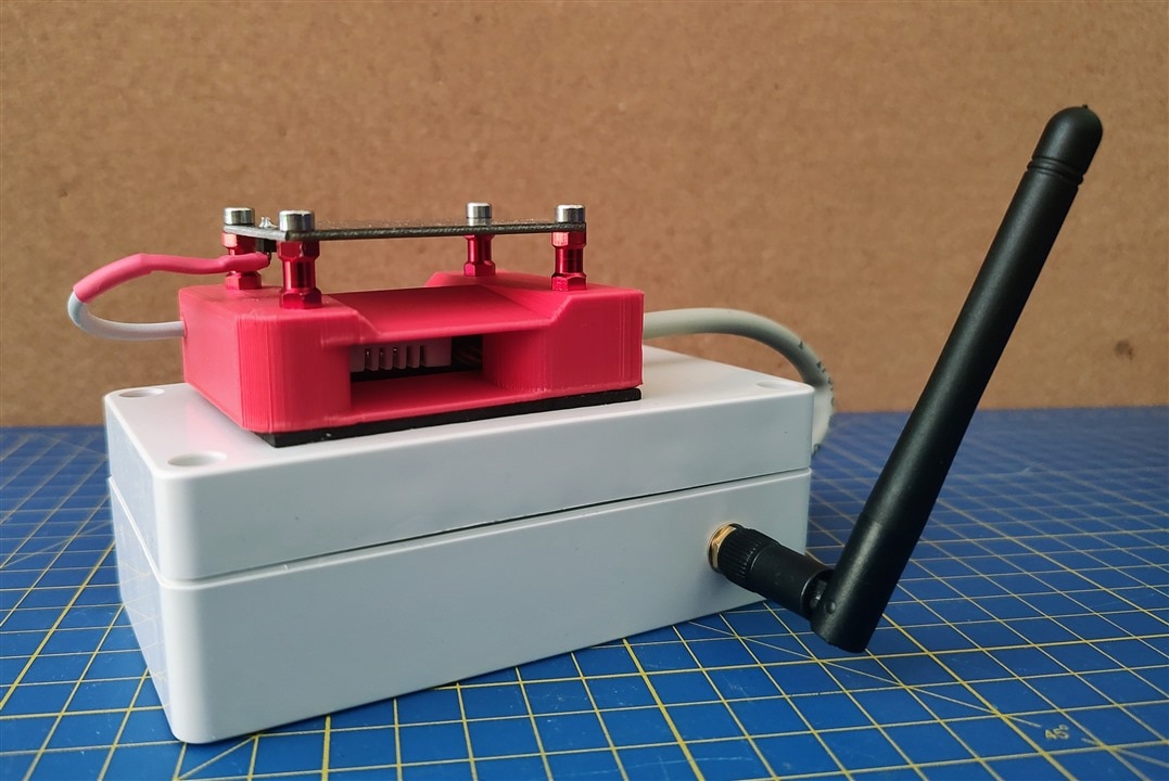

In the starter kit, we were provided with 2 Hammond Manufacturing electronics enclosures. My plan is to one of them utilize as the body of the rover, while I want to use the other one as the GCS. That leaves the question of what to use for the sensor boxes. To stay true to the theme and the competition I managed to find the perfect size Hammond enclosures in one of the electronics stores near me.
I would say that the enclosure is in the same category as the ones provided in the kit, rubber ring for stopping any water from getting in, metal threaded inserts for the screws, really thick plastic walls, so I think it would be safe to say it's up for the same tests and abuse as its bigger brothers!

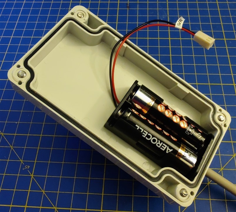

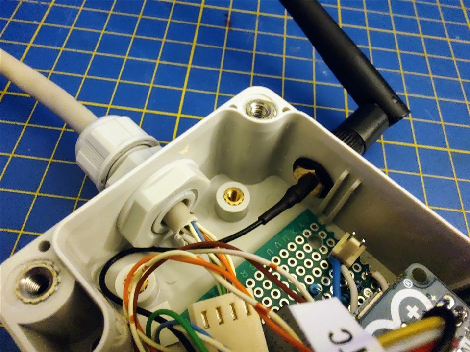

Since the box will be outside in the cold/warm, rain (currently snow) outside, my main goal was to keep the enclosure waterproof, but then again, for the sensor box to perform its function it needs to have an antenna and sensors on the outside. To get to the sensors, I decided to go with one of the provided cable glands and use a standard ethernet cable, since it has a lot of conductors and the cable gland grabs it really nicely. As for the antenna, I had to improvise a bit, I drilled a smaller hole and got it bigger a bit by bit using hand tools until I could barely screw it into the plastic wall. As an additional measure, I also put a small O-ring around the antenna connector that was squished against the wall of the enclosure as I tightened it down.
Those precautions will make sure that this box is much more than splashproof for sure. The sensors need to be exposed to the elements to get the measurements, but it's critical we keep the Arduino nice and dry. Before I get to the sensors, On the inside of the sensor box there are a few things, the perfbord with the Arduino and connectors, 2 AA batteries, and an RTC module. I glued the RTC module to the lid of the enclosure using some double-sided sticky tape.
As for the electronics inside, my idea was to make a simple perfboard with a few crimp nylon connectors so I can easily take everything out and work on it if I need to. One thing I would like to add but didn't have time to play with was to maybe add a reed switch somewhere that can be triggered without opening the lid to turn on the sensor box. Currently, there is a connector for the battery that needs to be disconnected to turn off the Sensor Box.
I left screw holes in the perfboard to screw the board into the threaded inserts, but the Arduino is too high by about a few millimeters for everything to fit in properly when the lid is closed, so I had to abandon screwing in the perfboard and just put it on the bottom of the enclosure.
The last thing left was mounting the sensors on the outside of the box. For this, I designed a small sensor mount that is designed to hold all of the sensors and is attached to the box using some double-sided sticky tape so I don't have to drill more holes in the box and make new paths for the water to get in.
All of the 3D models I am using can be found on the GitHub page that will be available soon (check the bottom of the blog for the link). The mount has slanted edges for water to run off in case it starts raining while the rain sensor will be exposed on top. This isn't the final design of the sensor box since it's still missing the part for how it's supposed to be picked up, but I will be adding that in the next blog. Until then, here is how the sensor box looks like fully assembled.

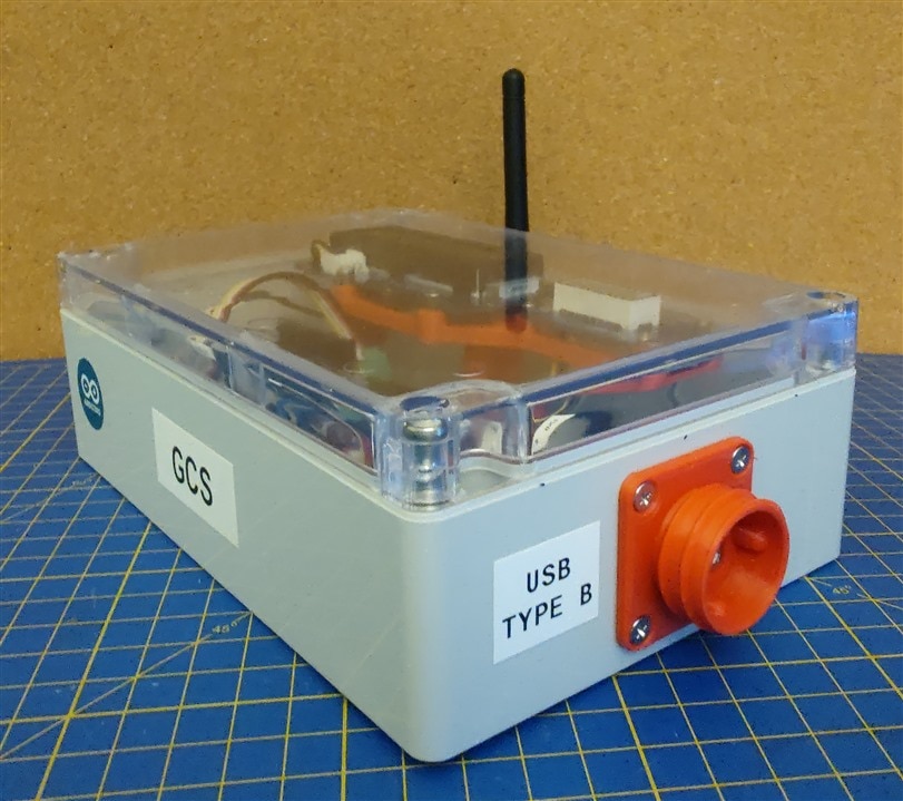

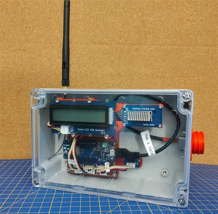

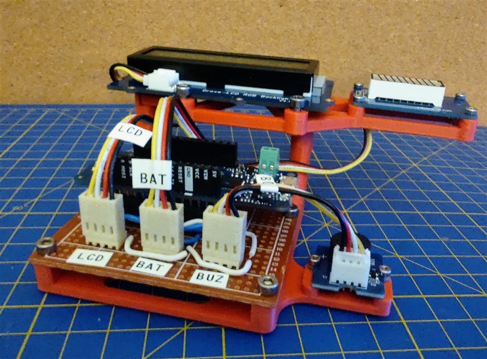

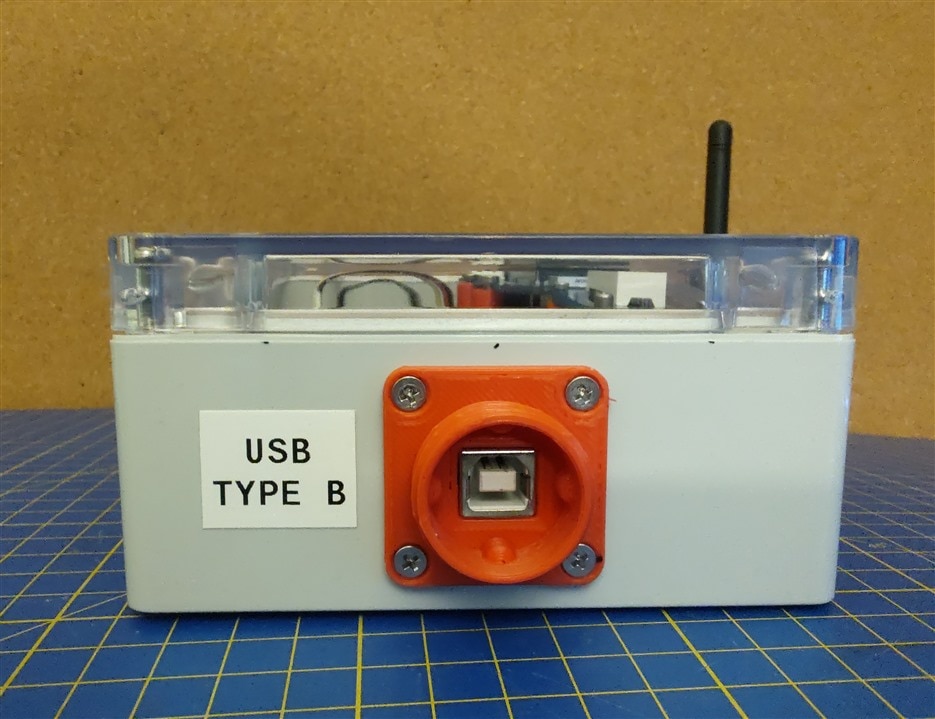

The main part of the design for the GCS is the enclosure. I chose to go with the clear lid enclosure that we got as a part of our starter kit, so I can have a clear view of the displays without needing to cut or drill additional holes on the outside of the box. The only thing left to do is model a 3D printed mount in Fusion360 and print it out. The GCS requires 3 printed parts, 2 of which are part of the mount for the electronics and the third one is a mount for the USB connector that I designed about a year ago for my 1 Meter of Pi Design Challenge.
In the first picture, you can see the perfboard mount. The perfboard is mounted using the 4 center holes, the small thing on the right is for mounting the buzzer, while the elevated part is the place where we mount the display mount. The display mount can be seen in the second picture. It has holes left for attaching both the displays and 4 holes for attaching the mounts together using 4 M3 screws. I've designed this so I don't use any nuts, all of the holes are a bit smaller so I can cut a thread into them. I found that this is a great method for 3D prints, especially when we don't need maximum strength like it's the case here. All assembled it looks like this.
In the last picture on the right you can see in red the connector I was talking about. I didn't take too much great care to waterproof it since this will be always near me when using the rover, but it's a nice way of accessing the Arduino without opening the box ever. I designed it so it can be locked with a nut when the cable is plugged in, or have a cap to keep dirt and water out while not in use.
All that's left now is to print out the parts and assemble everything! As I've mentioned previously above, at the end of each blog will be the GitHub link with all of the 3D models. These parts were designed to be printed without any supports, all overhangs are a maximum of 45 degrees.
I love the clean look I got from it at the end. For the wires, I used the wires that were in the Grove starter kit, cut the ends off where needed, and added the crimp-on nylon connectors. I was a bit more relaxed here with mounting the antenna compared to the sensor box as it didn't have to be as watertight as that. All it's missing now is the lid, and then we're off to coding!

6. Processing the data
As mentioned above, all of the data is saved into a CSV file using the python CSV library. This allows me to open the data later in Excel or similar software and to check it out or, use python again to load up that data and do some processing with it, plotting it and stuff like that. Here is how the data looks saved in a CSV file.

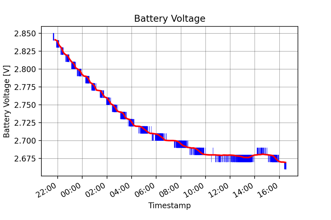

print(len(battery))
batch_size = 50
batch_num = 0
avereaged_data = []
timestamps1 = []
current_batch = 0
for i in range(len(battery)):
  current_batch += battery[i]
  if i >= batch_size * (batch_num + 1) - 1:
    avereaged_data.append(current_batch / batch_size)
    timestamps1.append(timestamps[i])
    current_batch = 0
    batch_num += 1
# plot
fig, ax = plt.subplots()
ax.grid(axis = 'both', color = 'black', linestyle = '-', linewidth = 0.2)
ax.set_title('Battery Voltage')
ax.set_xlabel('Timestamp')
ax.set_ylabel('Battery Voltage [V]')
ax.plot(timestamps, battery, linewidth = 0.3, color = 'b', label = 'Raw readings')
ax.plot(timestamps1, avereaged_data, linewidth = 2.0, color = 'r', label = 'Averaged data')
#ax.vlines(x=datetime.datetime(2022,1,25,7,0,0), ymin=2.825, ymax=3, colors='g', ls='--', lw=2, label='sunrise')
plt.gcf().autofmt_xdate()
myFmt = mdates.DateFormatter('%H:%M')
ax.xaxis.set_major_formatter(myFmt)
fig.savefig('./RoomGraphs/BatteryVoltageRoom.png', dpi = 200)
plt.show()
The code, in the end, gives us 4 different graphs, one that displays temperature and heat index, one that displays humidity, one that displays the air pressure, and one that displays the battery voltage. The live graphs are a great visualization tool to see the trend of how the data is changing, but we can get much more from these graphs by working with the data and tweaking with a lot of the parameters. One of the things I had to do was do an extra plot for the battery voltage. Since the Arduino uses a 10 bit ADC for measuring the voltage, the voltage would jump between 2 values on the graph before settling down to the lower one. To get a clearer view, I made a graph that took the average of every 100 measurements and plotted that, which gave us a great representation of the trend of the battery voltage. You will see all of these graphs in the next section

The last graph from the night that I have is the battery voltage measurement. As explained above, the voltage jumps a lot because of the bit count of the ADC as the battery voltage goes down, so I made a second plot over the original data that took the average of every 100 data points to see the trend of the battery voltage better.
I looked a lot online to see how to work with the voltage references on the Arduino MKR WAN to measure the battery voltage and this is the best result I got by comparing the reading to the reading of my voltmeter. This way, I can't measure above 3V but that doesn't concern me, as much more critical are the lower voltages for me. One interesting thing that can be seen is the slight increase in the battery voltage after sunrise as the temperature went up.
