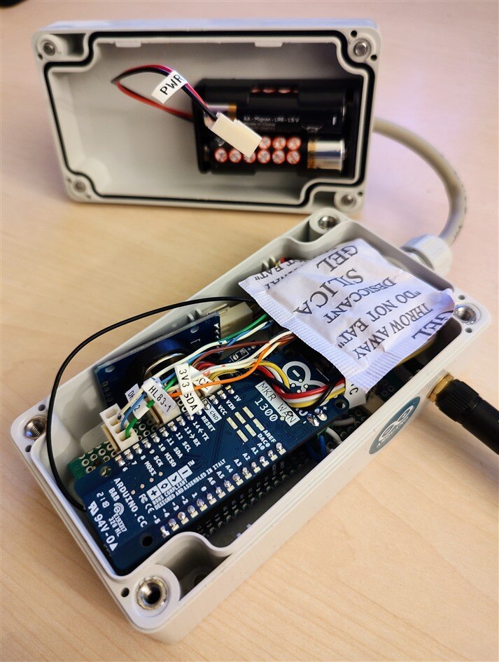

As described above, this test will see how long a pair of AA batteries can go in a setup like this where we send a message every 5 seconds. One thing I was thinking of doing maybe was adjusting the rate of the messages depending on battery life.
Another thing I want to try is to compare different kinds of batteries and see how well they perform this task. Sadly, I can't really compare the results from this test with the previous tests because those tests weren't done continuously, and also, one of the tests was conducted in my room that has a 20C temperature difference which greatly affects battery life.
The last thing that will be different this time will be in the setup of the hardware. While the hardware is completely waterproof and I'm not concerned about any water getting in like that, one thing I am concerned about is moisture in the air because of the lower temperatures here. The last time I opened the box after leaving it out for the whole night, all of the surfaces seemed to be a bit wet to the touch, so I decided to remedy that with the simplest solution, I used a small silica bag and put it inside to deal with any moisture trapped in the box. For this method to be completely effective, it would mean we would have to leave the box in a warm place for a while once we're done using it, or open it in a dry place since condensation will occur as soon as the fresh air touches the cold components inside.

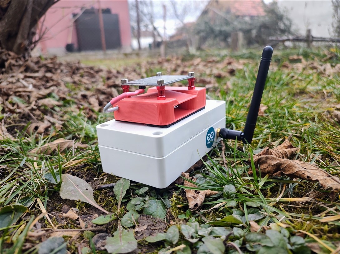

With the setup out of the way, it was time to conduct the experiment! There was some rain in the forecast for the days when I wanted to conduct the test, so I thought it would be a good test to leave the box somewhere in the grass on the ground like the rover will, to test how it handles water.
Compared to last time, the temperature was much more forgiving this time and it didn't deep below zero, where it was constantly pretty much the last time. If you wish to check out the design and the code for the box, follow this link which will lead you to my previous blog for this project: Orb-weaver Rover - Blog #2 - Monitoring and data collection (GCS, Sensor Boxes, GUI)

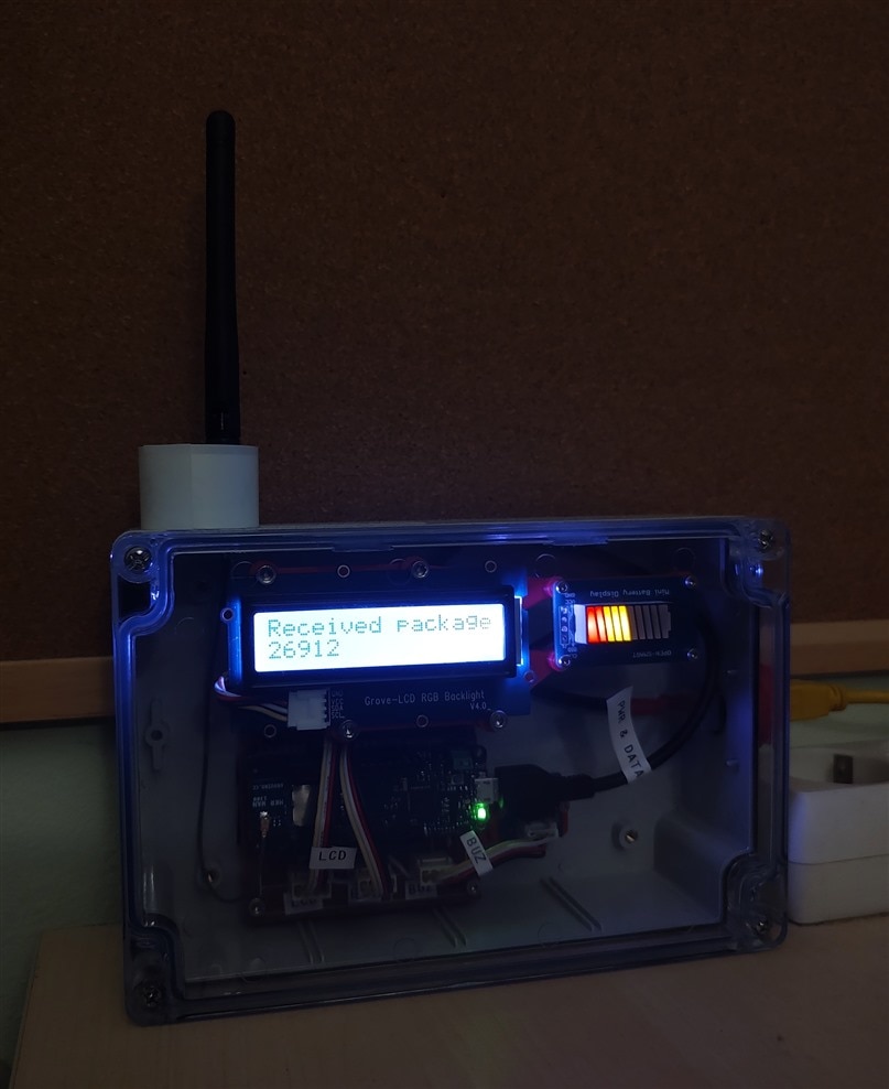

In the picture above is the GCS showing one of the last messages received before I unplugged the batteries from the Arduino. One thing I really need to add to sensor boxes is a reed switch so I can turn them on with a magnet without opening the box every time. You can see the build for the GCS and the code for it here: Orb-weaver Rover - Blog #2 - Monitoring and data collection (GCS, Sensor Boxes, GUI)
The test went smoothly for most of it, there was just a single hiccup, where my laptop decided to blue screen, so I didn't record a few data points while I turned everything back on but considering that I'm working with 27000 measurement points, that doesn't cause any issues there. One place where it did cause an issue though was the python script for working with the data. It appears that the blue screen happened while the program was writing to the CSV file, so there was  NUL somewhere in the CSV, but it was a rather easy fix to get everything working nicely again. Here is that code:

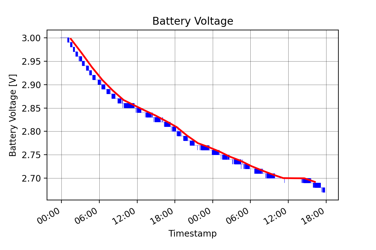

I cut the test a bit short, but the battery voltage measurement at that point was around 2.68V, so it wouldn't have lasted much longer anyway. While I know I said I can't compare my findings now with the tests from the last blog, I think that the batteries I used last time performed a bit better. Both times I used generic off-the-shelf batteries that I found in a local store, I'll probably run the test again, but maybe use some more expensive batteries to see if they actually make a difference. Another idea I had was to maybe switch to the smaller AAA batteries, but try and pack 4 or 6 of them in the box.
The blue line on the graph is the raw data I got from the Sensor Box, while the red line is made out of average points every 1000 measurements to get a more realistic view of how the battery voltage behaves as it drops. I did this because the ADC uses a finite number of bits and there will be some oscillations when the voltage is on the edge between 2 values that the Arduino can measure.

I'm gonna call this test a success, the setup worked without any errors for around 45 hours and almost 27000 measurements continuously. I'll probably conduct a few more tests like this one along the way when I put together the second Sensor Box, maybe compare the different battery manufacturers head to head or completely different battery setups as I've discussed above. The boxes are proving to work great, I need to come up with some more elaborate tests to test out their strength.  If you're interested in any details about the hardware or software of the Sensor Boxes, GCS or GUI I highly recommend you check out my previous blog: Orb-weaver Rover - Blog #2 - Monitoring and data collection (GCS, Sensor Boxes, GUI). Thanks for reading the blog, hope you like it!
