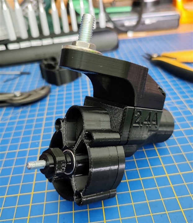

Gearbox
The first part of the design that I will cover is the gearbox. This is the part that will connect the Digilent motor to the RC wheels I’ve shown above. The easiest thing to do would be to mount the wheel directly to the motor, but this means that the weight would be transferred directly onto the small bearings of the motor and that we would be stuck with the gearing that the motor has. Here is a video to show why that would be a bad idea for the rover:
The wheel spins way too fast for what we need, so why not reduce the speed and increase the torque along the way. In the first blog, I covered a lot of simulations and calculations for different kinds of parameters for the rover and set on the reduction ratio of 3.
There are many different ways we can transfer torque, we can look at different gear arrangements, belts, and so on. I will cover 2 approaches here, one will be using something that can be categorized into a belt drive and a geared transfer method. I wanted to use small O-rings to transfer the torque, but the rubber was too slippery and it would sleep on the pulleys no matter how tight I got it, so I tried using a couple of common rubber bands, which proved to work wonderfully. Here are a few pictures of the design:
The motor is connected to a small pulley which is supported by a small 4mm bearing and it transfers torque to a bigger pulley that is mounted on 2 5mm bearings which are the ones that need to handle the weight. This way we’ve transferred the load from the small motor bearings to the much stronger 5mm bearings.
I went with this approach for now because it allows for the small pulley to slip in case the wheel gets jammed somewhere. This is important because I don’t have current sensors for the motors (I plan on getting them for a future build), so I don’t burn out the motor or the controller when it slips. I did a few tests with the rubber bands, and when I used 3 of them, I got about 1.5A on the motor when I blocked the wheel, which is acceptable both for the motor and the motor controller. I also made a geared design that fits into the same form factor as the one with the rubber bands. Here is a picture of that.
It performs surprisingly well and quietly considering I am using just 3D printed gears. But if the wheel got jammed, there would be a possibility of killing the motor or the controller which I am trying to avoid. Since I plan on working on the rover for quite some time, this is the gearbox that will in the end be on the rover because I will have much more precise wheel odometry compared to the rubber band approach.
There have been some changes on the parts shown above which you can see in the next blog. I've added a metal nut in the big pulley and the wheel hub, so the grub screws don't destroy the threads.

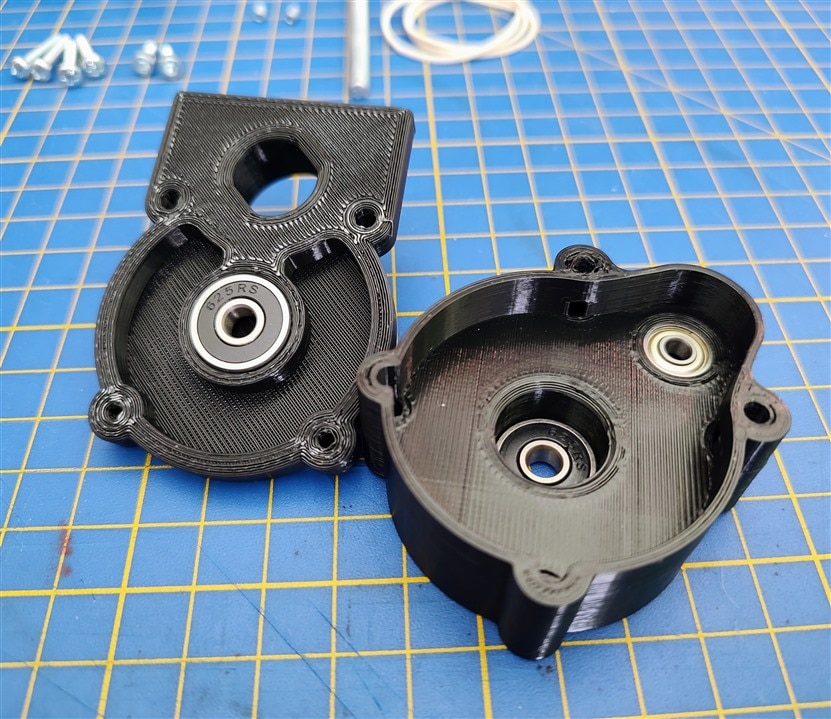

The gearbox by far has the smallest parts and requires the most time to be assembled properly. As mentioned above, I will now show the rubber band version and how to assemble it, though, the geared version follows the same process, it just needs a bit of grease to run properly. Here are the parts that will be needed for the gearbox.
Here is the list of parts:
  1. Digilent motor
  2. Big pulley - 3D printed
  3. Small pulley - 3D printed
  4. Wheel hub - 3D printed
  5. Motor plate - 3D printed
  6. Gearbox casing - 3D printed
  7. 2 625RS bearings
  8. 694ZZ bearing
  9. M5 threaded rod - 50mm
  10. 4 M3x15mm screws
  11. 2 M3x8mm screws
  12. Rubber bands
  13. 2 M3 grub screws
The first step is to put the bearing into the housing and the motor plate, this is most easily done with a small vice or with a small rubber mallet as I did.

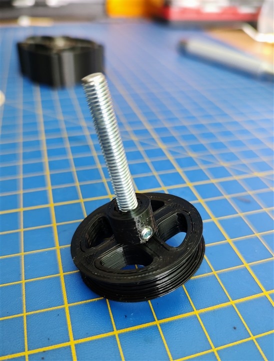

The next step is to thread the threaded rod into the big pulley and secure it with a grub screw. To thread the rod into the big pulley, I recommend using a drill on the threaded rod and holding the big pulley in the hand. You should end up with something like this.

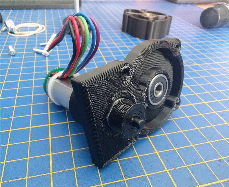

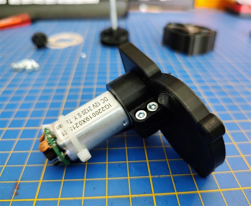

The next step is putting the motor into the motor plate and securing it with the 2 shorter M3 screws. While we're working with the motor we can also put on the small pulley which press fits on the shaft. I put it on the motor with the help of a small rubber mallet.

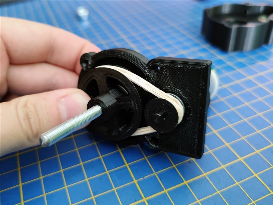

The next step is putting the rubber bands on the pulleys. Since they are stretched, you will have to hold the big pulley with one finger. As mentioned above, I used a total of 3 rubber bands, since I got about a 1.5A draw with that setup.

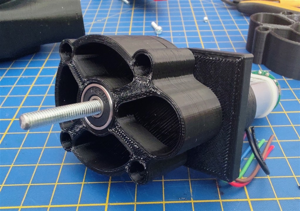

While holding the big pulley, now you need to put on the gearbox casing. This can be a little fiddly to get the motor shaft in the 4mm bearing, But as soon as you get that, it will all click in place and you should have something that looks like this.
The only thing left to do is to attach the gearbox now to the motor casing and the rest of the wheel assembly which is done with the 2 top screws on the gearbox casing (the 2 on the right on the picture above), and here is how that looks in the end.

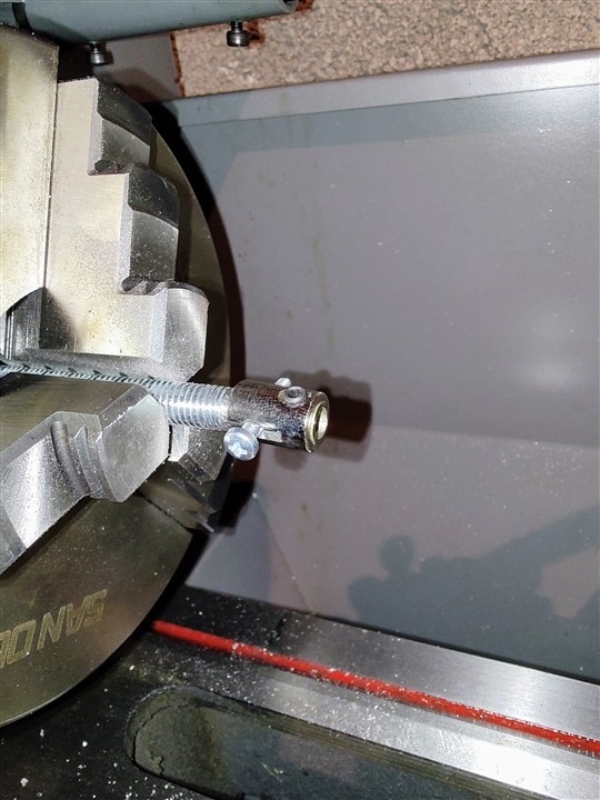

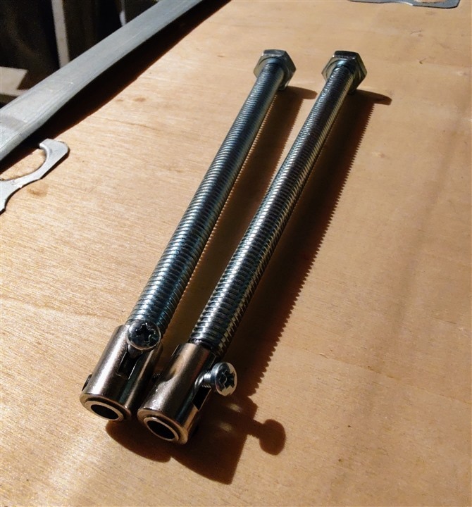

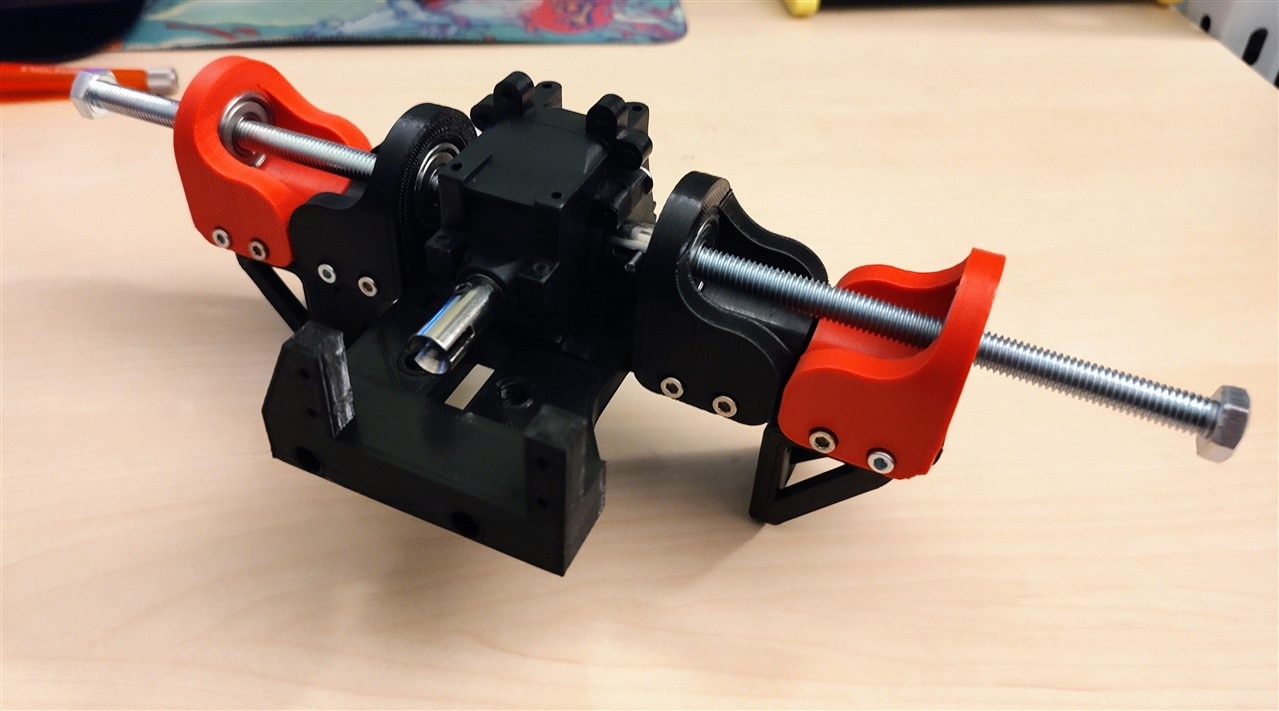

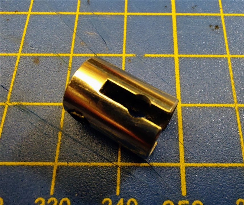

This is where things get a bit more tricky. They get tricky because we need a way to connect the M8 bolts with the differential. One way of doing this would be designing and printing small adapters. I decided to go a different but much more robust way. The differential has a small steel coupling on each side, so with a lot of help from my dad, we turned the M8 bolts down to 6mm plus we drilled and tapped a hole for a 3mm screw to go through the center of the bolt.
The steel couplings were a bit too small for the M3 screw, so I used a Dremel and one of those diamond bits to just make a small hole for the M3 screw.
With all of that done, here is how the suspension part looks assembled.

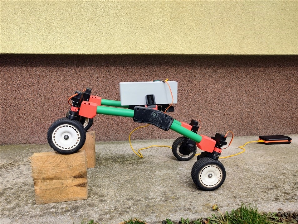

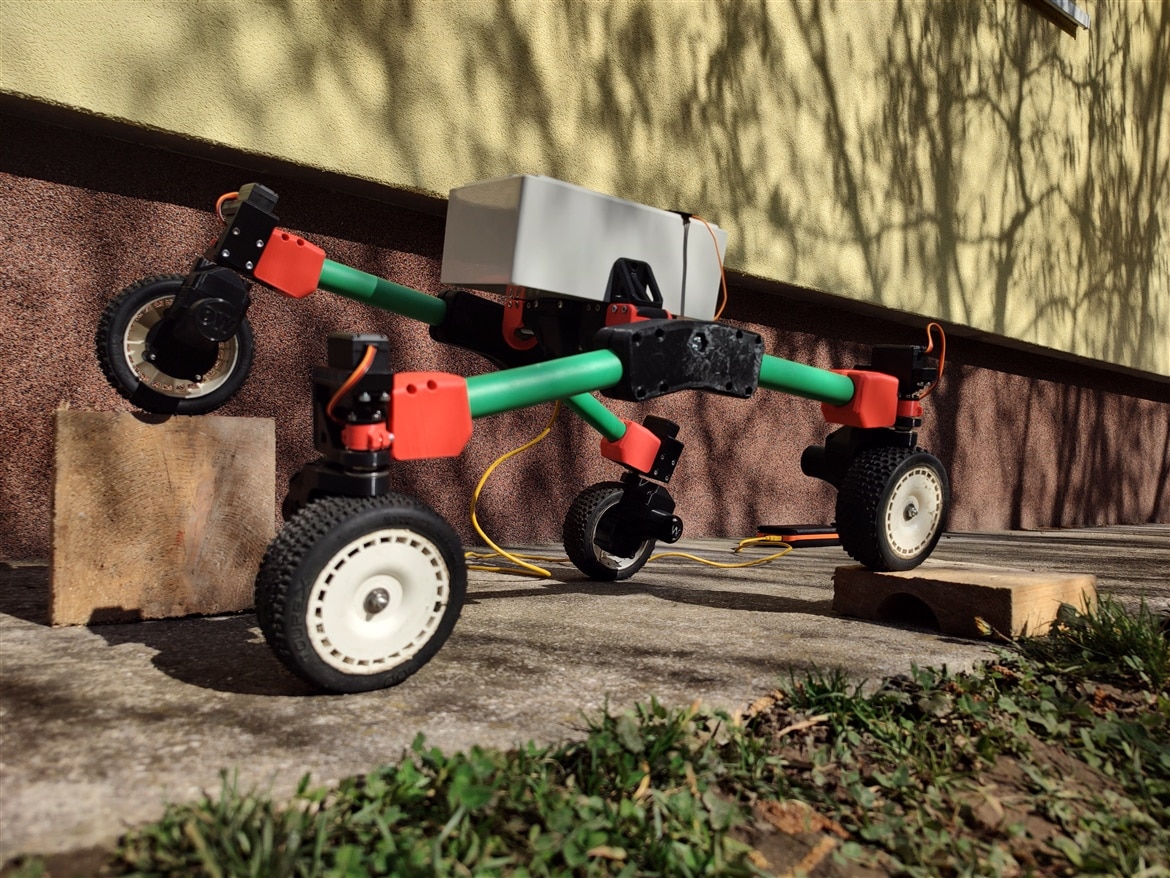

5. Assembled rover and suspension test

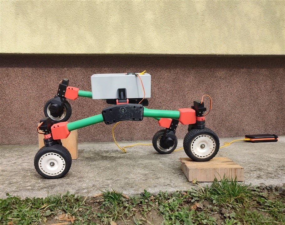

With all of that done (the gearbox part 4 times) I put everything together for the first part and here is how it turned out in real life!
And here it is! I was so thrilled to see it on its wheels for the first time. It's one thing seeing it on the screen at different iterations and a completely different thing seeing it standing beside me. There are a few things that I of course see now after building it that I want to change, but those are some small things that will be fixed by the next blog. For example, the wheels on the outside get a bit too close for comfort, but that's a simple spacer that I can print and the problem will be fixed. I love the suspension setup and how it conforms to anything.
One thing you might notice in the pictures above is a yellow cable and that the box is completely level in both pictures. I assembled everything with the continuous servo underneath, so I thought I might as well do a fast setup to see how well the rover could balance the body. To do this, I attached an MPU6050 IMU inside the enclosure and put an Arduino Mega inside. To keep it level, I wrote a small code that implements a PI regulator for keeping it level, and as you will see in the video it needs some tuning, but I will do that once all of the electronics are on board. Here is the code for the PI regulator as well as the video of the active suspension.
