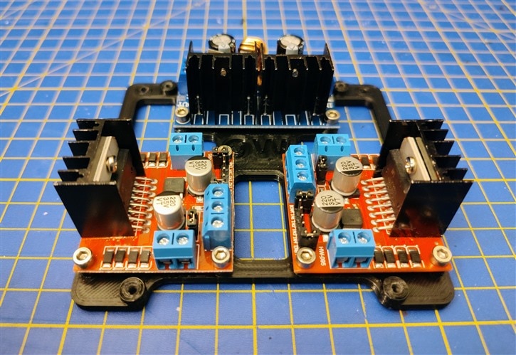

3. Packaging the electronics
For this, I of course started in Fusion with the model of the Hammond Enclosure. I can't stress enough how useful it was to have the models available on the site for download, rather than trying to measure every dimension by hand. I went for a 2 story approach where on the bottom level I would have the 2 motor drivers and the buck converter, while on the top level, I'll have the 2 Arduinos and the IMU.
1st Level
For mounting this level, I used the 2 holes with threaded inserts on one side of the box. To mount the second level, I used 4 30mm standoffs, any more than that, and I would have issues with clearances at the top.
2nd Level
This level mounts to the mentioned posts and has mounting holes for the Arduino Mega, a perfboard that will hold the Arduino MKR WAN1300, and a mounting hole for the MPU6050. Here is how it all looks assembled.
