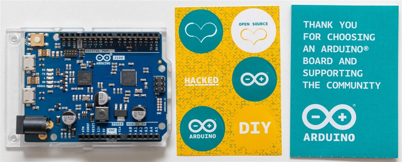

The Arduino Zero is a relatively new board to me. From looking at the specs, it almost looks to be an Uno-footprint with an MKR “heart” – the 3.3V-based 48MHz ARM Cortex M0+ ATSAMD21 microcontroller.
image image
image image
I do like that after all this time, the packaging still remains familiar and the products are still Made in Italy – but I wonder how the recent Qualcomm acquisition of Arduino will affect its future.
Time to take things out of the box …

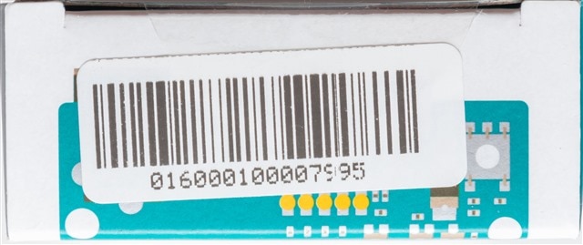

I can’t say I’m too fond of the stickers – and the board seems a more ordinary blue than the teal-green-blue of the Unos of old.

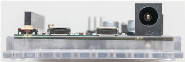

The board is relatively busy though – two USB micro-B connections is a new thing to me (looks like this means it’s got an onboard debugger), as is having a JTAG header. As for why this board was chosen, I suppose part of the magic may well be the switching buck regulator that’s on this board. Most Arduino boards in the past used just linear solutions, but this one has a LM2734Y that has a 1A rating, so with the lower losses compared to previous linear supplies, this should mean more current available for LEDs to consume when supplied by the barrel jack supply.
I like the fact the plastic tray is still included – no more worrying about shorting out on the mat or bench wire scraps. That’s definitely something the clones don’t have.

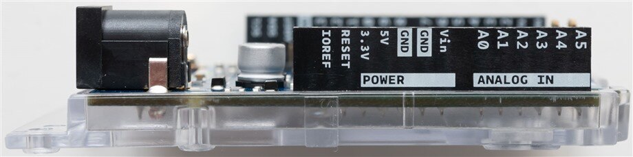

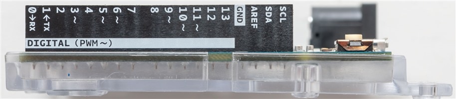

Other benefits include the labelled headers.

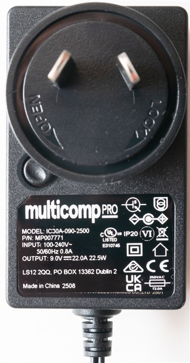

Speaking of power supplies, element14 have provided one of their house-brand “Multicomp Pro” supplies. This is a 9V 2.5A supply with plugs to suit all countries, carrying a wide array of certifications including the Australian RCM (good news for me). It has a part number of MP007771 and is Made in China.
Four heads are provided in total, none are pre-fitted.
image image
The heads twist-lock onto the base and then the supply is ready for use. But I had a big laugh – the branding label they’ve affixed is obviously a label over the original printing, but it also contains a significant error – 22.0A. This is definitely not a 22A supply. It’s 2.5A, but obviously, this typo wasn’t picked up on.
Seeing as it’s obviously a label, I peeled it off to reveal that it’s an Ecopac Power branded product, but that is a product of Shenzhen Shi Ying Yuan Electronics Co. Ltd.
image image
Regardless, the adapter has a relatively slim profile – doesn’t block adjacent power outlets which is nice.
No indicator LEDs – that probably helps when it comes to chasing higher efficiencies and keeping costs down.

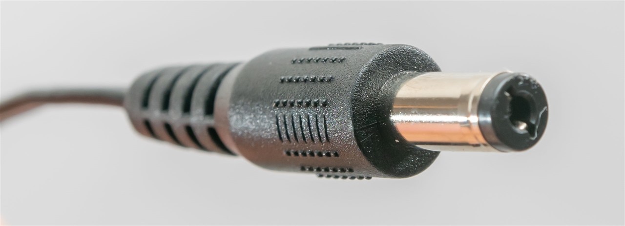

The cable is terminated in a 2.1mm ID plug, ready for use with the Arduino Zero above.

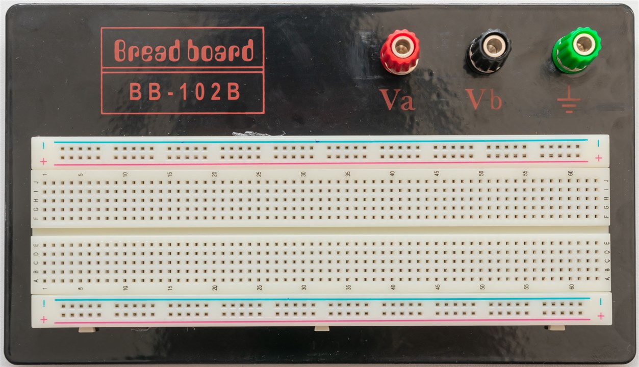

Next, we have the breadboard. In prior years, I’ve had a couple under the “element14 Presents” branding (just a sticker) but these came without.
image image
Some minor assembly is required – fitting the banana jacks, assuming that you would like to use them.
They’re nice breadboards – but the feet often lose their stickiness and get lost, resulting in something that just doesn’t sit flat on the table.

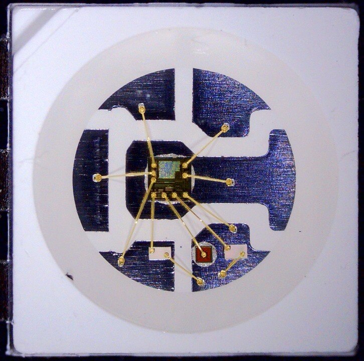

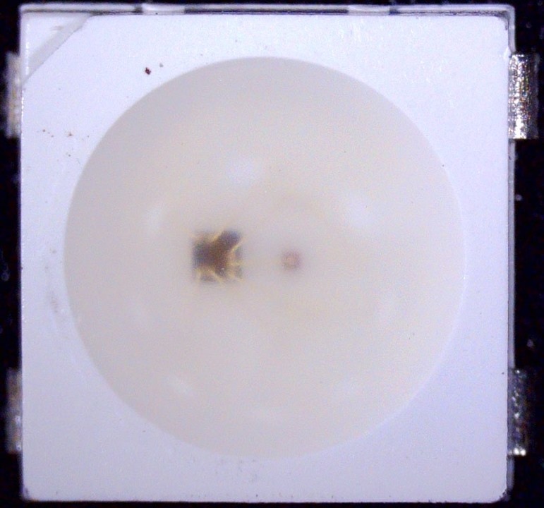

First off-the-batt is the 1315050930246 (Würth Elektronik loves long part numbers) which is a 5050-size LED. Looking at this, it looks similar to APA102-based (or colloquially known as “Adafruit Dotstar” or “Sparkfun Lumenati”) LED. These use a synchronous SPI-like bus (clock + data) in a daisy-chain configuration, thus requiring six contacts.
A closer look through the optically clear packaging material shows the large controller IC compared to the three small LED chips along with their gold bond wires. The bright area is probably the digital logic, while the darker area that surrounds it likely be the transistors, resistors, capacitors and diodes that drive the outputs.

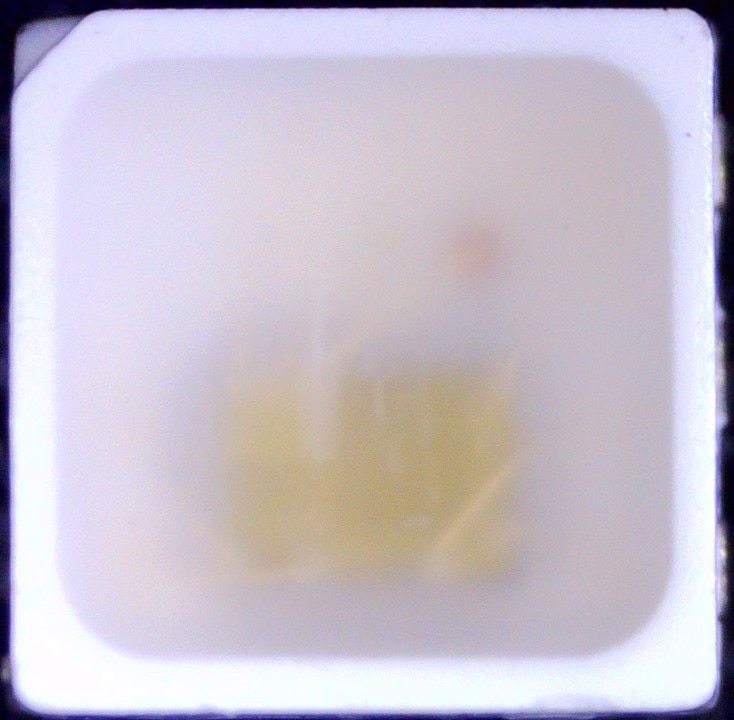

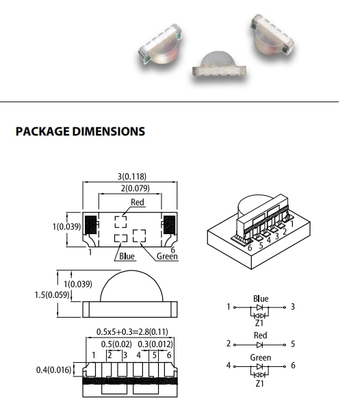

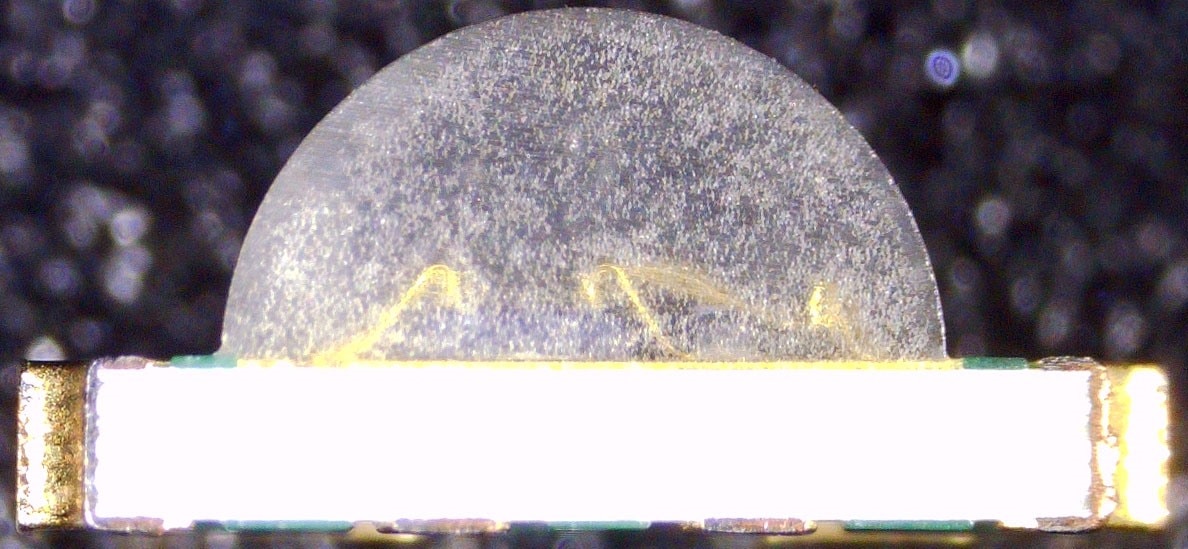

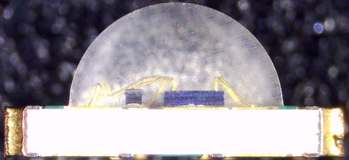

Finally, there is the 1313210530000 which is a 3210-size single-wire bus LED which is designed to be mounted on its edge for edge-firing applications.
image image
Being a smaller LED, the fit is pretty tight in there – the thickness of the IC and the LED chips is fairly similar and it’s beautiful to see the gold bond wires connecting the two together. The substrate and connection pad patterns are quite interesting – it seems to suggest an upward firing position may even be possible (although not recommended).

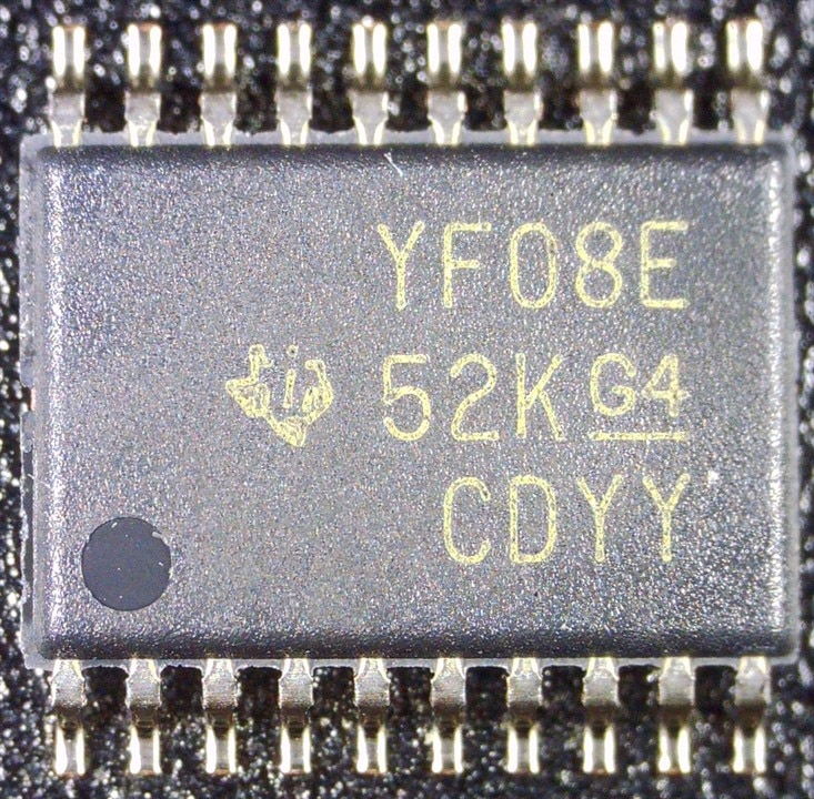

Finally, there is also the level translator (or level shifter).
image image
We were provided with just a single Texas Instruments TXS0108EPWR 8-bit bidirectional level translator chip. Because of the package of the chip, it’s not really friendly for use with breadboards, so a breakout would have been nicer. I might substitute my own level shifter instead for breadboard purposes and use this one for a final PCB – but eight channels also seems a bit of overkill but perhaps it was intended so we could run multiple buses of all variants of the WL-ICLED at once (with two channels required by the “clocked” and one channel required by the “clockless” variants).

    balajivan1995 over 1 year ago +2
    Gough Lui said: But I had a big laugh – the branding label they’ve affixed is obviously a label over the original printing, but it also contains a significant error At least it's not a $300+ watch that…
  • Gough Lui
    Gough Lui over 1 year ago in reply to balajivan1995 +2
    That's going to be interesting - I'm not sure you will see much more than what you see in the side-view of the edge-firing 1313210530000 - in fact, the lens marks suggest to me that it might have been…
  • Würth Elektronik
    Würth Elektronik over 1 year ago +2
    Great start to the project! Just a quick tip: the SideView LEDs can also be used as top-mount LEDs (emitting light upwards), you just need to adjust the soldering pad layout accordingly. If you're interested…
    At least it's not a $300+ watch that needed recall
    Whoops: OnePlus 'meda' big mistake with the OnePlus Watch 3 - Android Authority
  • Gough Lui
    Gough Lui over 1 year ago in reply to JoRatcliffe
    That's going to be interesting - I'm not sure you will see much more than what you see in the side-view of the edge-firing 1313210530000 - in fact, the lens marks suggest to me that it might have been "sawn" off a long "row" of LEDs at one stage. I don't have access to a water jet or anything that would make "clean" cuts through all the material, but I might be willing to give it a go if I have some left over afterwards.
    Most of the body of an LED package will be the packaging and lead frame - the chips you see are the actual "brains" and emitting parts, connected by gold wire. The chips themselves are of different semiconductor material, owing to the band gap required to create the specific wavelengths - they'd likely be a bulk crystal with nothing much to see at all.
    - Gough
  • Gough Lui
    Well, I do come from a country where several batches of polymer banknote have an error in the microprint ...
    https://www.abc.net.au/news/2019-05-09/new-$50-note-contains-typo-in-word-responsibility-rba-confirms/11096528
    So ... expensive errors abound! I think the world may just be pushing people too hard - conscientiousness is at an all-time low :(
    - Gough

    Lovely photos. Are the landing pads vertical on tape?
    Not familiar with pick and place making rotations about that axis, perhaps they do.
