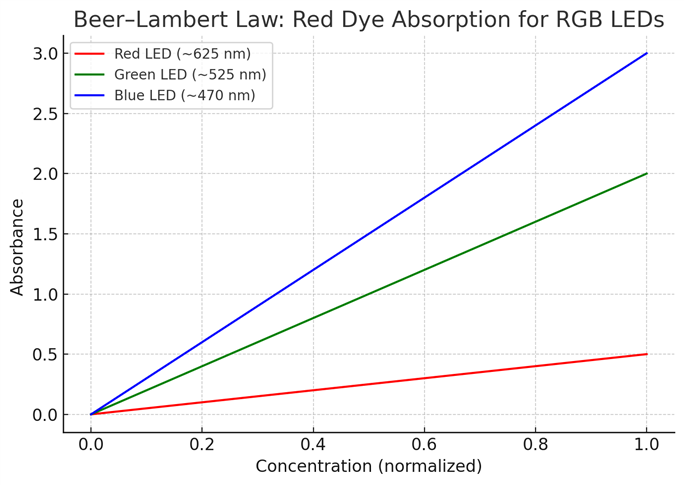

Beer–Lambert Law — Measuring with Light
Beer–Lambert’s law describes how light is absorbed as it passes through a medium:
It’s a simple yet powerful relationship: double the concentration, double the absorbance.
By shining pure red, green, and blue light through different solutions and measuring the transmitted intensity, students can see this law in action.

Experiments include -
  • Absorbance vs. concentration curves.
  • Why a red solution transmits red but absorbs green/blue.
  • Color mixing and metamerism demonstrations.

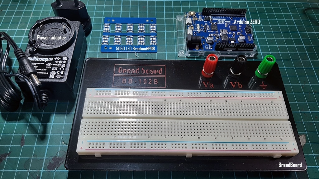

Unboxing the kit
{gallery}Kit Unboxing
Unboxing the kit - Arduino Zero and other accessories.
Unboxing the kit - WL-ICLEDs

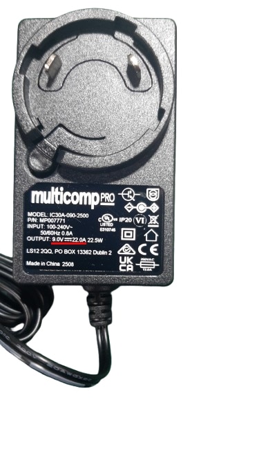

Unboxing the kit - Power adapter - 22A!! should be around 2.5A
The challenge kit contains -
  • WL-ICLEDs — RGB LEDs with integrated constant-current drivers for stable color mixing.
  • Arduino Zero — my main controller for both sensing and display.
  • Level shifter — to interface logic levels properly.
  • Power supply — to drive longer chains of LEDs without flicker.
  • Breadboards and connectors — for rapid prototyping.
I’ll add my own components (photodiode, amplifier circuit, cuvettes, and 3D-printed holders) to complete the experimental setups.
There is an interesting point I noticed about the power adapter. It’s a 9v adapter which produces about 9.2 v. And it’s supposed to generate around 2.5A current maximum. But the markings showing 22A!!

    Great first update, really comprehensive and with lots of imagery too. Thank you for sharing this. Kudos to you and also Gough Lui for spotting the error on the power adapter.
