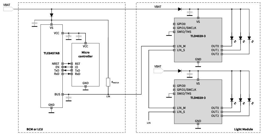

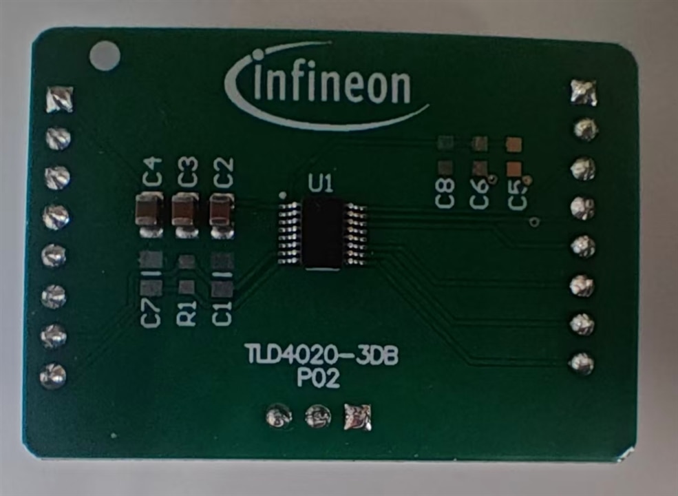

3 Introduction to TLD4020-3ET Chip
The TLD4020-3ET, developed by Infineon under its LITIXTm Interior product line, is a highly integrated, automotive-grade LED driver chip tailored for interior lighting applications. It combines a powerful microcontroller core, flexible memory resources, dedicated LED driver stages, and a LIN (Local Interconnect Network) interface, making it a compact and reliable solution for modern automotive lighting systems.
For this smart car chamber project, LIN is good choice, and widely applicable in large warehouse illumination. While LIN is not the key point in this design challenge, so, let it go for a moment.
3.1 Core Architecture & Key Hardware Features
The chip’s architecture is optimized for efficient control of LED lighting, with a focus on performance, flexibility, and automotive-grade robustness.
1.1 Microcontroller (MCU) Subsystem
At its core, the TLD4020-3ET features a 32-bit Arm® Cortex®-M23 processor, designed for low-power, high-efficiency operation:

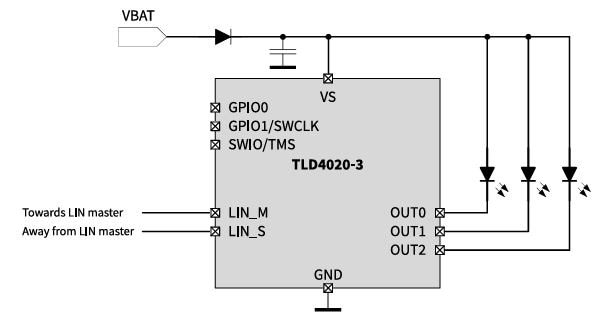

3.2 LED Driver Capabilities
The TLD4020-3ET is primarily designed as a three-channel linear current sink (LCS) for RGB or multi-color LED control, with key features:
  • Current Capacity: Each channel can drive up to 51.5 mA (absolute maximum: 56.65 mA) to power individual LEDs.
  • Parallel Configuration: Power stages can be paralleled to support higher load currents (for brighter lighting or multiple LEDs in series).
  • Precise Current Control: Each channel’s current is configurable via a 5-bit set value, enabling fine-grained brightness adjustment.
  • Independent PWM: 3 independent PWM (Pulse-Width Modulation) configurations, allowing dynamic light pattern control (e.g., dimming, color mixing for RGB LEDs).
3.3  Communication Interface(Not used in this design)
The chip integrates a LIN transceiver (with LIN_M and LIN_S pins) to enable seamless communication with the vehicle’s main network:
  • Programming: Supports firmware updates via the LIN interface (using a bootloader), eliminating the need for dedicated programming ports.
  • Control: Receives lighting commands (e.g., "turn on contour lighting") from the LIN master (e.g., vehicle ECU).
  • Diagnostics: Sends feedback (e.g., LED fault status, current levels) to the master, enabling predictive maintenance and system monitoring.

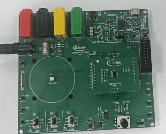

3.6 Drive the RGB led in three channels
Once power up, the TLD4020 runs to drive the RGB led

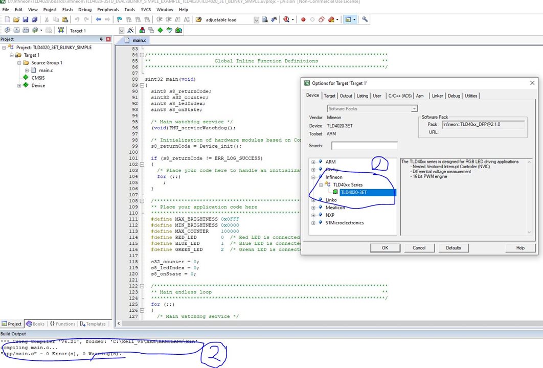

3.7 Coding with Keil 5.28
Here is the code for this simple blinking
sint32 main(void)
  sint8 s8_returnCode;
  sint32 s32_counter;
  sint8 s8_ledIndex;
  sint8 s8_onState;
  /* Main watchdog service */
  (void)PMU_serviceWatchdog();
  /* Initialization of hardware modules based on Config Wizard configuration */
  s8_returnCode = Device_init();
  if (s8_returnCode != ERR_LOG_SUCCESS)
    /* Place your code here to handle an initialization error */
    for (;;)
  ** Place your application code here                                         **
  #define MAX_BRIGHTNESS 0x0FFF
  #define MIN_BRIGHTNESS 0x0000
  #define MAX_COUNTER    100000
  #define RED_LED        0  /* Red LED is connected to channel 0 */
  #define BLUE_LED       1  /* Blue LED is connected to channel 1 */
  #define GREEN_LED      2  /* Grenn LED is connected to channel 2 */
  s32_counter = 0;
  s8_ledIndex = 0;
  s8_onState = 0;
  ** Main endless loop                                                        **
  for (;;)
    if (s32_counter++ > MAX_COUNTER)
      if (s8_onState == 0)
        LDRV->PWM_DC_CFG0.reg = (s8_ledIndex == RED_LED) ? MAX_BRIGHTNESS : MIN_BRIGHTNESS;
        LDRV->PWM_DC_CFG1.reg = (s8_ledIndex == BLUE_LED) ? MAX_BRIGHTNESS : MIN_BRIGHTNESS;
        LDRV->PWM_DC_CFG2.reg = (s8_ledIndex == GREEN_LED) ? MAX_BRIGHTNESS : MIN_BRIGHTNESS;
        if (++s8_ledIndex > GREEN_LED)
          s8_ledIndex = RED_LED;
        s8_onState = 1;
      else
        LDRV->PWM_DC_CFG0.reg = MIN_BRIGHTNESS;
        LDRV->PWM_DC_CFG1.reg = MIN_BRIGHTNESS;
        LDRV->PWM_DC_CFG2.reg = MIN_BRIGHTNESS;
        s8_onState = 0;
      s32_counter = 0;
The Arm-cortex 23 core is used and pass build successfully.
