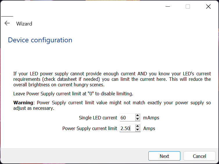

Prismatic Tool Setup and Configuration

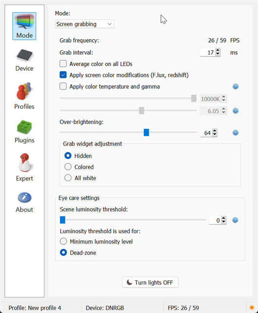

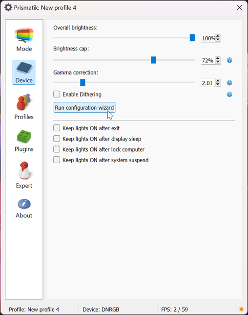

The home windowConfiguration wizard icon

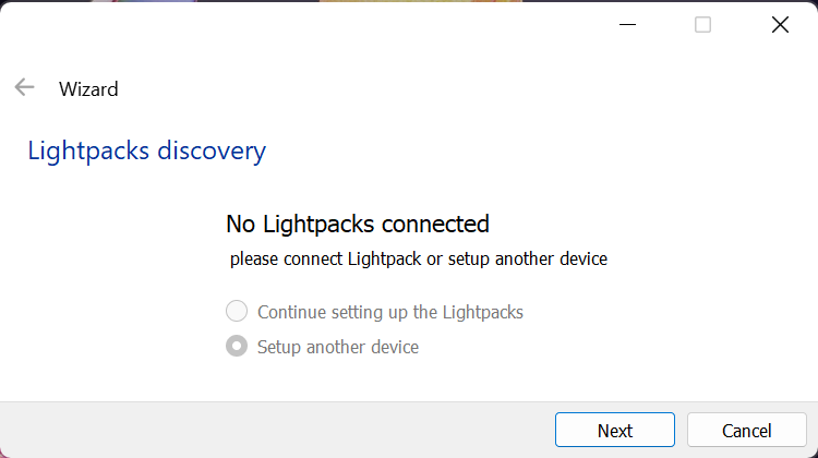

Connection status

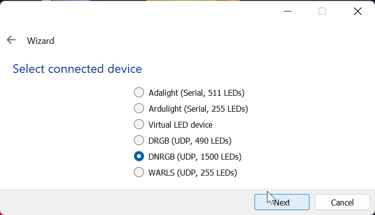

Device selection from the list

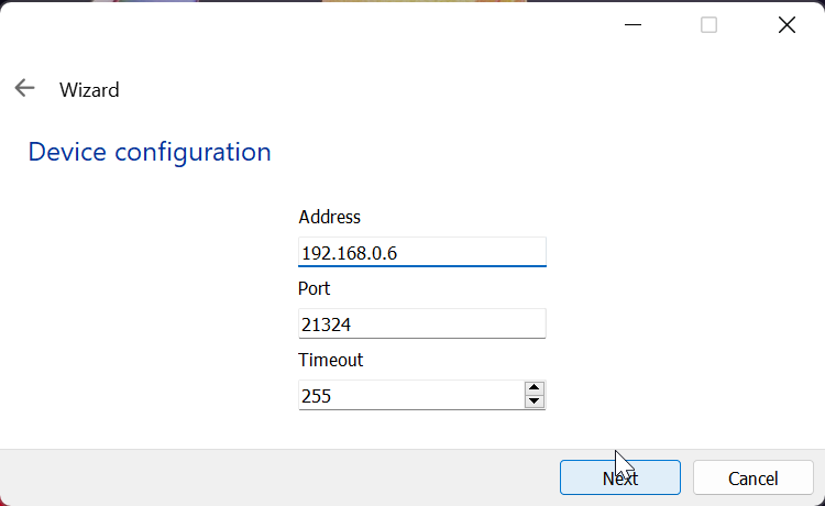

Wireless configuration and setup

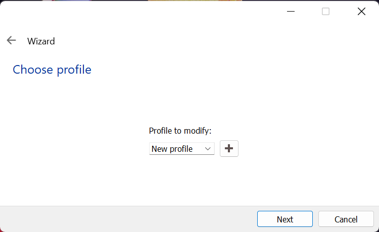

Profile selection window
Final device configuration
Alignment and LED placement setup
That's about Prismatic functionality, stepwise configuration and in the next blog, we'll talk about the mechanical build up, painting and how the PCBs are put together to build LED towers.

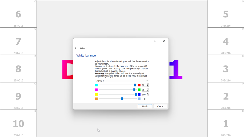

  • navadeepganeshu
    navadeepganeshu over 1 year ago in reply to colporteur
    Prismatic tool does that for us. It maps the whole display into zone numbers and different configurations like zones in the right and left side only, zones on the top of the display only or a mix of it can be chosen. Once we define where to place these boxes and how many boxes, the pixel extraction happens.
    In this image for example, 5 zones each on each sides of the display are mapped.
