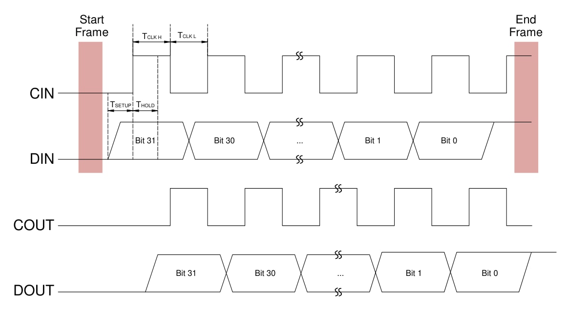

Such protocol is described in datasheet using following diagram (and table describing requirements for T parameters mentioned in diagram):
Two wire protocol timing
This diagram is somehow confusing. There are several parts more or less confusing. Sadly, Würth datasheet has no explanation. It actually contains absolutely no texts except tables, diagrams, graphs, etc. Well, there are two technical sentences as a note on the bottom of pages. The only other texts here are some legal disclaimers. I always expect datasheet to be comprehensive source of truth, but this one slightly weak. The most confusing part to me is “End Frame” section. It is slightly better explained on later diagram in datasheet including description of somehow similar “Start Frame”:

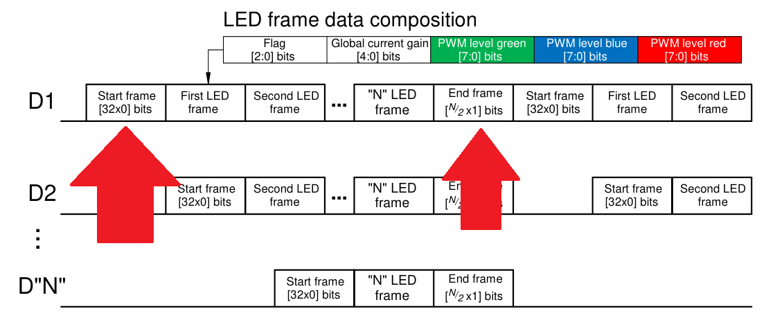

Two wire protocol overview
Start frame is easy. But I do not understand purpose of end frame. It says that it should generate one bits and the number of bits is equal to N/2 where N is strip length. First interesting thing is that according to this formula, it can end up with number of bits which is not even divisible by 8. It makes very hard time when implementing driver using SPI peripheral, because very few peripherals support configurable data width with all possible options less than 8. But you can design your software in a way that strip is always multiple of 16, then you can just add bytes to end. Strip do not know how long it really is, so you pick lowest higher multiple of 16. For 100 LEDs, you can make it 112 LED long on software layer. Another interesting part is division by two. There is not written anywhere if it is intended to round down or up, but Würth official library says up in comment.

N/2 Stop Bits
One of my theories was that purpose of this section (no matter how crazy it’s definition is) is for synchronizing LED to start emitting new colour at the same time. If chips in LEDs have counter, they can count how many data were transferred before reaching this end frame and then start emitting new colour all at the same time. They do not need to compensate length of data transfer, because they actually receive end of frame bits all at the same time as highlighted on diagram in Würth datasheet. They only need to know when it should happen and for this reason end of frame could be useful to indicate it.
32 Stop Bits
My other theory is that it is used for compatibility with some other LEDs. Only LEDs with similar interface I know are APA102 which seems deprecated and very hard to acquire to me, but their datasheet is searchable. Their protocol is almost identical, including format of start frame, but end frame is not defined in such horrible way. In case of APA102, end frame is defined as sending 32 x one bit, basically the same as start frame, just ones instead of zero. I implemented emission of exactly 32 high bits, instead of N/2 high bits and Würth LEDs accepted it. But there was strange behaviour that when LED was not power-cycled since previous experiment, they started to emit colours as expected, except exactly second LED which turned off. This seem weird to me because 32 ones are valid command for LEDs for white at full brightness. After I power cycled board to reset all chips, even with 32-bit stop bits they no longer accepted colours and stuck in state, where only first LED work, exactly as in previous experiment.

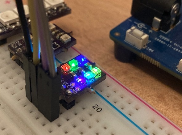

So, they actually send zero bits as stop bits. I tried experiment with it slightly differently and try send no bits at all. It started working, I have seen right colours on all my 6 LEDs.
Running two wire LEDs
First refresh, only first LED works
One issue which remains (and it was issue in all previous cases) is that on power up and first data transmission, only first LED works for some reason. At second refresh, all LEDs updates and start working. Maybe my signalling is still wrong. In datasheet there is several more confusions like that clock and data signals at the beginning of diagram are low, but at the end, they are high and there is no explanation when should MCU switch from high back to low. This basically define CPOL param when SPI peripheral is used to generate signal. Würth use CPOL=0 in their library. Also, it is not clear how 3-bit command type interfere with start and stop bits and if some detection of transfer phase is implemented using these.

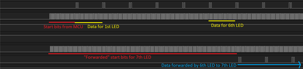

This is obviously lot of unexplained magic. So, I tried searching for LED which I think 1311610030140 are intended to be compatible with. I searched for APA102 and found library implemented by Pololu. It contains 20 lines long comment explaining real purpose of end frame. Simply rephrased, LEDs behave differently than I thought. Logic on clock signal is more dumb than I thought. Every LED just negate clock input signal and pass negated one to next one. This cause shift of half period. This minor clock shift LEDs use for data forwarding. Logic in controller wait for it’s 32-bit of data. Every (not only first one) LED receive clock almost immediately when data transmission begins. Clock is available to all LEDs immediately using chain of inverters. Only data transmission is delayed. Actually, while first LED receiving it’s data, second LED still receives zero bits. It seems that start frame can be arbitrarily long. My understanding is that LED identifies it’s own data by observing first high bit after long (at least 32-bit long) sequence of zeros. At that time, it still propagates zeros on output data line. After it receives it’s own complete 32-bit frame, it starts propagating data to next LED. I deduced this by observing how signal outputted from 6th LED looks like. I exposed this signal on test pads on my PCBs. It would be better to evaluate single led individually but unluckily; I made PCB with 6 LEDs.
Data are shifted by half of the cycle because output clock is inverted input clock. But because clock is ultimately generated by MCU and data rate is lowered half a cycle on each LED, if MCU send 0 stop bits like I did, last LED will miss some clock cycles. For this reason, MCU need to generate at least N dummy clock edges or in other words N/2 full clock cycles, which are used just to propagate final bits which will be otherwise lost because of propagation delay on chain.
