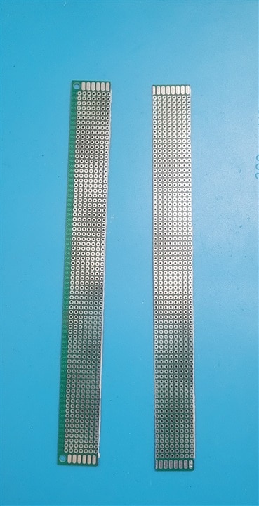

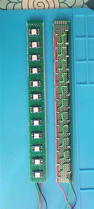

Preparing Perf-Board by cutting it from 15cm × 20cm dimension to LED strip sized lengths to fit in the enclosure.

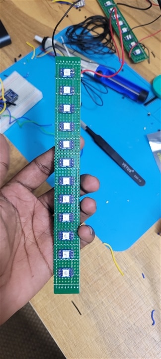

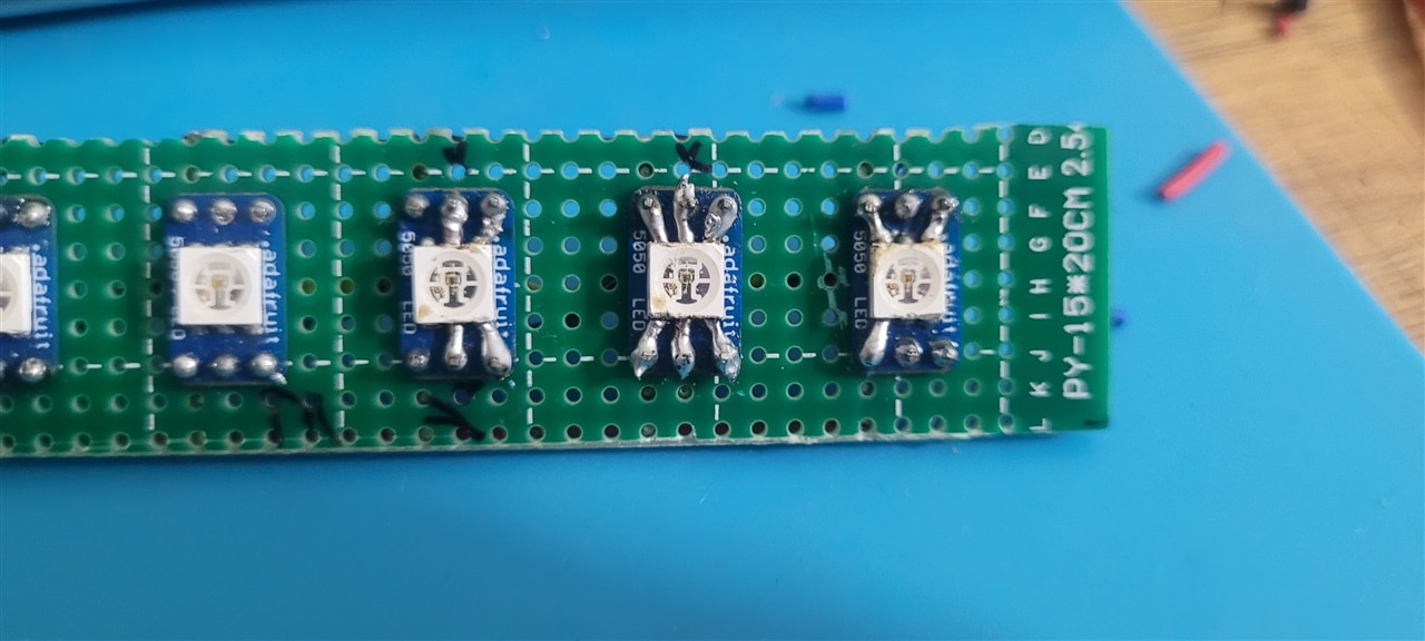

LEDs are now soldered along with 5050 size breakout boards provided and mounted on the perf board.

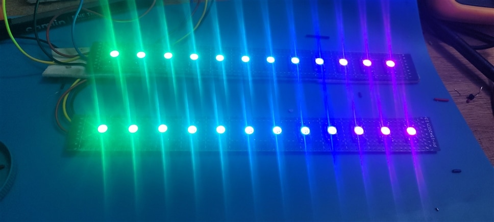

A much later image, but everything then works :)

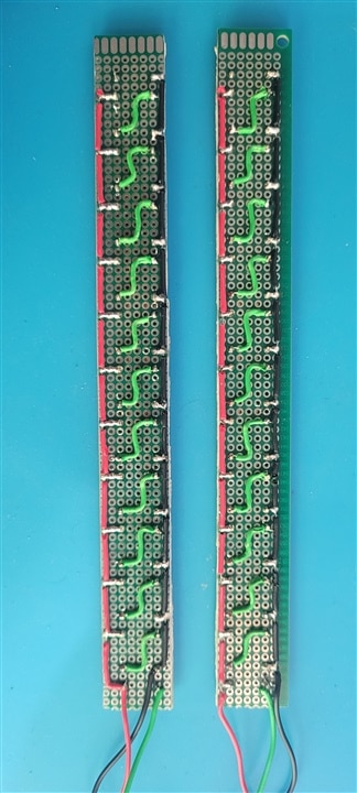

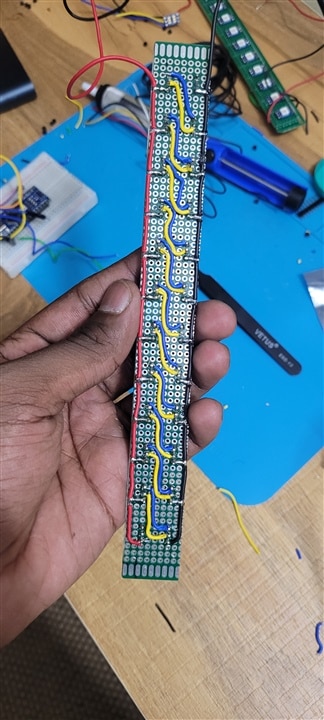

Before the above image, some of the LEDs were having issues as they didn’t light during testing. Root cause was then found to be the LED pins were actually not making contact on the breakout board with the berg pins soldered. Had to solder bridge in some places - ewww, that's messy, yes and would kill the OCD of any healthy electrical engineer.
Completed LED Strips ready to go inside the tube looks like this and after making two of then, doing a polarity and continuity check, clean wire management, they're good to go.

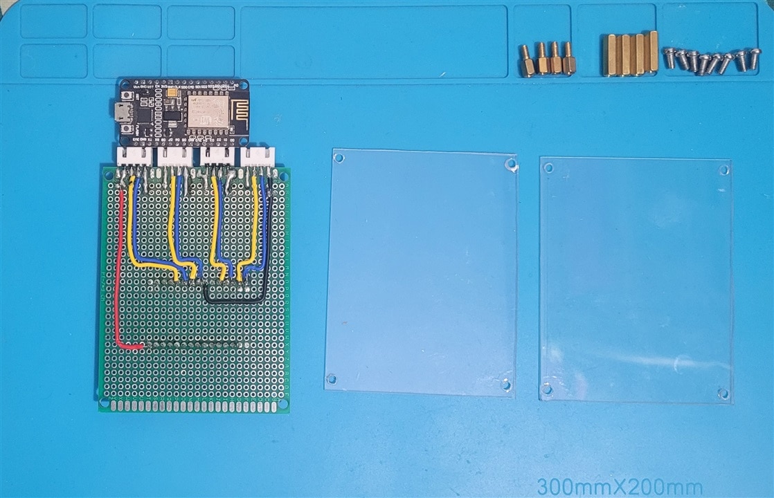

Building the Control Unit

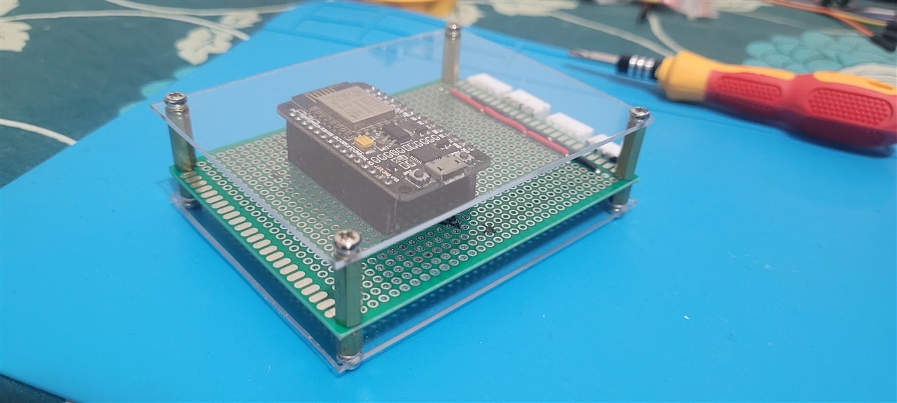

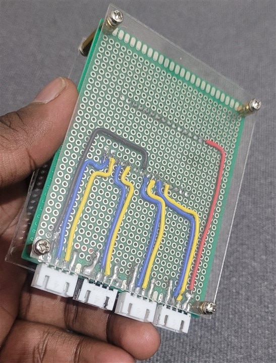

Now to control the RGB LED bar, NodeMCU based unit is brought together. Although the supplied Arduino was used during earlier evaluations, the idea is to keep it simple, bare minimum hardware and the one that has wireless capability. JST connectors are preferred for modular plug-and-play connection with the LED bars. Again, a small perf-board PCB is made for connections power section routing.
Assembled between two acrylic sheets using standoffs for a neat finish and durability. Please rate my standards out of 10...haha ;)
