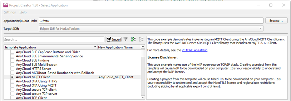

I plan to use MQTT messages to communicate between the PSoC 62S2 and a local MQTT broker that I have running on an RPi4.
The PSoC 62S2 will subscribe to detection messages from the remote microwave sensor and publish classification and recognition messages.
The first thing that I need to verify is that I can send and receive messages (publish and subscribe to topics) to/from the broker.
Modus Toolbox includes an example to do that using an AWS broker - AnyCloud_MQTT_Client.  I am running on my LAN with a private broker, so I need to make some minor tweaks to their example.
I just need to modify 2 configuration files:
     wifi_config.h to add my wifi network name and password
     mqtt_client_config.h to add the broker ip address and port and any TLS information
I thought this would be very easy because I don't run TLS when operating within my private LAN, so I wasn't going use TLS and didn't need to generate any certificates (I'll probably switch to that at some point).  So, basically all I needed to do was indicate that I'm not using TLS and also switch the port number from (8883 to 1883).
There are 2 lines in the mqtt_client_config.h file:
     #define MQTT_SECURE_CONNECTION            ( 0 )   // change from 1 to 0
     #define MQTT_PORT                         1883                   // change from 8883 to 1883 -> 8883 is the default TLS port
Of course, nothing is that easy.  Just simply changing the MQTT_SECURE_CONNECTION to "0" would cause the build to fail (I had verified it would build with "1").
Here is the build error message:
     source/mqtt_client_config.c:118:38: error: conflicting types for 'security_info'
       118 | struct cy_awsport_ssl_credentials_t *security_info = NULL;
     In file included from source/mqtt_client_config.c:44:
     ./configs/mqtt_client_config.h:192:39: note: previous declaration of 'security_info' was here
       192 | extern cy_awsport_ssl_credentials_t  *security_info;
I needed to delete the "struct" declaration so that line 118 in mqtt_client_config.c became
     118 | cy_awsport_ssl_credentials_t *security_info = NULL;
That fixed the build error.
