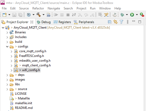

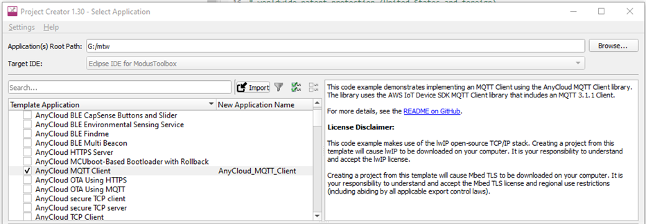

Modus Toolbox includes an example to do that using an AWS broker - AnyCloud_MQTT_Client.  I am running on my LAN with a private broker, so I need to make some minor tweaks to their example.
I just need to modify 2 configuration files:
     wifi_config.h to add my wifi network name and password
     mqtt_client_config.h to add the broker ip address and port and any TLS information
I thought this would be very easy because I don't run TLS when operating within my private LAN, so I wasn't going use TLS and didn't need to generate any certificates (I'll probably switch to that at some point).  So, basically all I needed to do was indicate that I'm not using TLS and also switch the port number from (8883 to 1883).

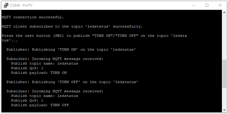

Application demo
In this particular application, the PSoC 62S2 both publishes and subscribes to the topic "ledstatus" which creates a message loopback.  When the user button (SW2) is pressed the published message alternates between "TURN ON" or "TURN OFF" to the topic "ledstatus".
Since the board is also subscribed to the "ledstatus" topic, it responds to the message by turning the user LED on or off.
Here is the USB serial output in a PuTTY terminal window.
