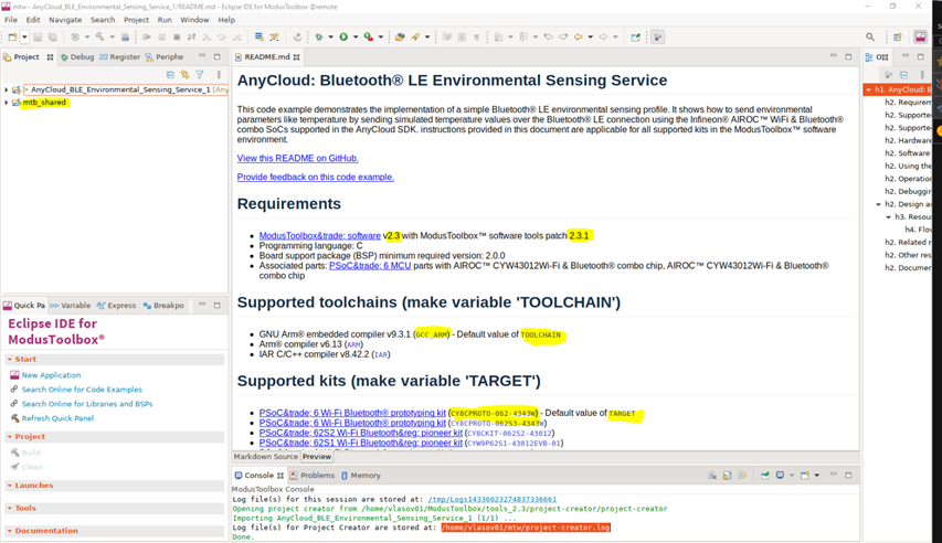

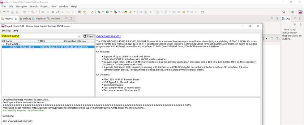

Creating the AnyCloud: BluetoothRegistered LE Environmental Sensing Service project
Modus Toolbox 2.3.1 comes with several project samples. My project requires sending sensor data over BLE to an app I've selected the AnyCloud: BluetoothRegistered LE Environmental Sensing Service template as a starting point.
I've filtered boards by the board type CY8CKIT-062S2-43012.
And then selected the AnyCloud: BluetoothRegistered LE Environmental Sensing Service template:
I've read the documentation provided with the project and adjusted some variables.

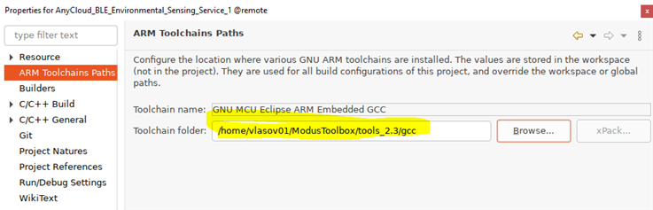

Setting ARM Toolchain GCC path

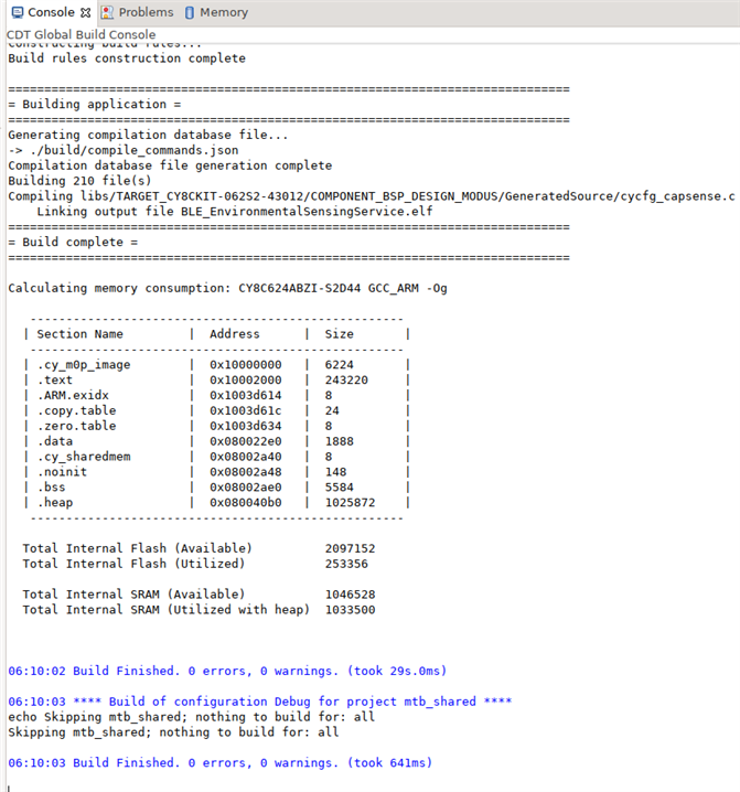

Build
The build was relatively fast and completed without any errors or warnings.

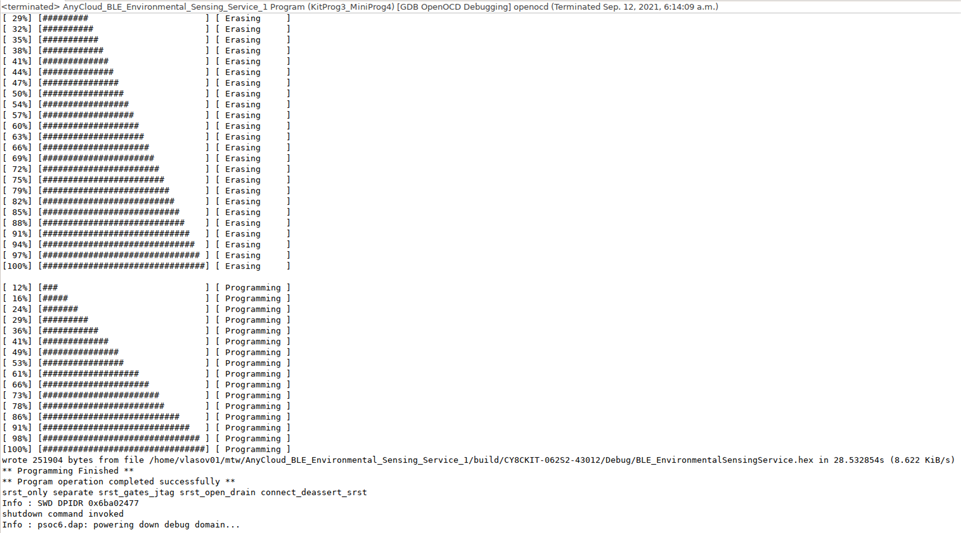

And then I run the project, It did another build and uploaded binaries to the board. It was very fast and straightforward,

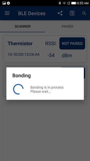

After I've installed and open CySmart app I've got a list of devices, but the the board was not their. I've reset the board by pressing SW1 XRES button. This button is used to reset PSoC 6 MCU. And I've got a new device - Thermistor.
I've tried to pair the device, but it was not bonding.

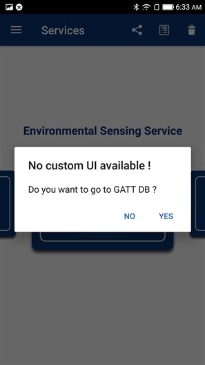

I've selected Environmental Sensing Service and got the following prompt:

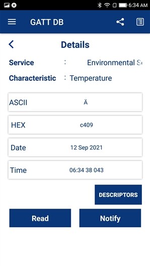

And I've got CySmart app GATT DB screen with simulated values of Temperature.
The app has a nice feature of data logging:
