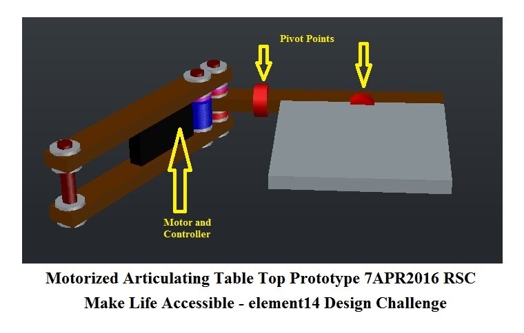

The subject of this installment is project ELapShelf by Scott Coppersmith (rsc). The goal of this project is to develop a motorized articulating table top that is easily maneuverable by someone who might be constrained to a bed or wheelchair. The project will feature the NXP FRDM-KV31FRDM-KV31  development board and FRDM-MC-LVPMSMFRDM-MC-LVPMSM motor control board.
Scott’s first post gave us a brief introduction to the project. He says that his inspiration came from being confined to his bed for a few days due to a knee injury, and how unproductive not having a proper articulating work surface is when laying in a bed. As you can see from the image above, the tabletop will feature two pivot points, as well as an actuating arm, but it is unclear as to if the pivot points will feature separate motor control, just rotate mechanically.

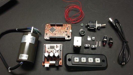

Post three and four were both very brief, with post three detailing some issues that have arisen with the motor that is supplied in the challengers kit. Scott says that the motor is just too fast for his application, and that a gear reduced stepper motor would be a better choice. He also mentions that the motors weight is a little too much for his original design plans, and he will be moving it further back on the arm to compensate for this. Post four comprised of a brief explanation of the parts that Scott has been gathering for the project, including an old CRT Monitor stand, some lumber, and what appears to be a bamboo cutting board that will serve as the table's surface.
Update number five was another brief posting, and simply showcased an image of the parts that had recently arrived in the challenger kit.

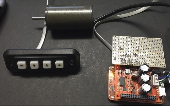

The project took a huge leap forward on May 13th, when Scott posted updated number six which detailed his attempts to get the motor controller up and running with the KSDK.  As you can see in the image above, a small prototyping PCB was used to create a very simple circuit that allowed the motor to be easily connected to the switches that came with the challenger kit. The post contains a small schematic of the circuit, and code needed to control the motor’s speed  which is done via a demo program with a PORTC interrupt routine that decodes the buttons and changes the motor’s speed.

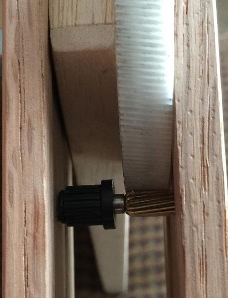

The seventh update included some information on the mechanical assembly of the project. To be more specific, gears. Scott found a nice set of gears in an old printer, and had to create an adaptor that would allow them to mate to the shaft of the motor that came with the NXP kit.  As you can see in the image above, this adapter worked out quite nice, and allowed Scott to get the mechanical assembly of this portion of the project finished.
Update: 27 June 2016
The project arrived at its eighth update on June 13th, and discovered that Scott was having some issues with too much friction being applied on the gear shafts due to the wood he used not being a good bearing surface. To fix this he said that he plans on adding some bearings to the shaft ends in a future update. Despite the friction issues, the project is moving forward nicely, and as you can see from the image above, everything is meshing together quite well. I especially like the use of the timing belts over a gear reduction box.

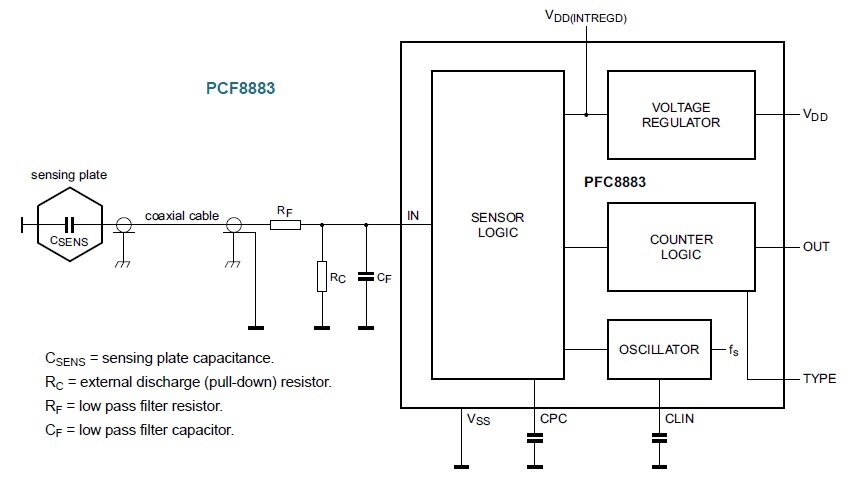

In the project’s ninth update, Scott showed off an accessory he is building for the project as sort of a bonus addition. Using a NXP PCF8883 Capacitive touch proximity switch IC that was included in the challenger kit, Scott plans on building a touch sensitive reading lamp to the lap shelf.
The basic circuit was taken from the NXP PCF8883 data sheet and can be seen above. “I used a SparkFun SOIC to DIP 8 pin adapter PCB along with a few Rs and Cs to wire up the touch control,” Scott said. “I don't need to run the switch through the FRDM-KV31 board, but that might change later.”

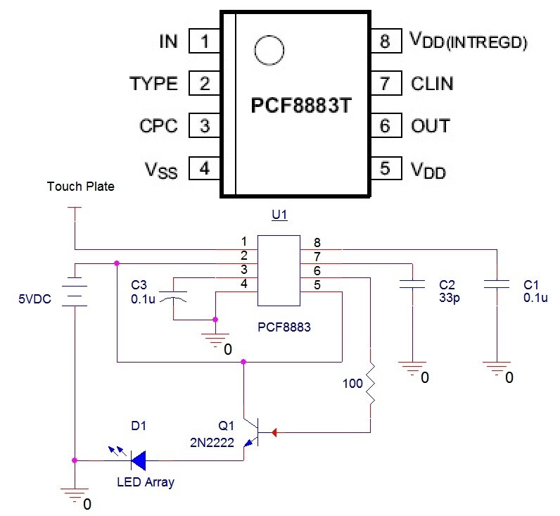

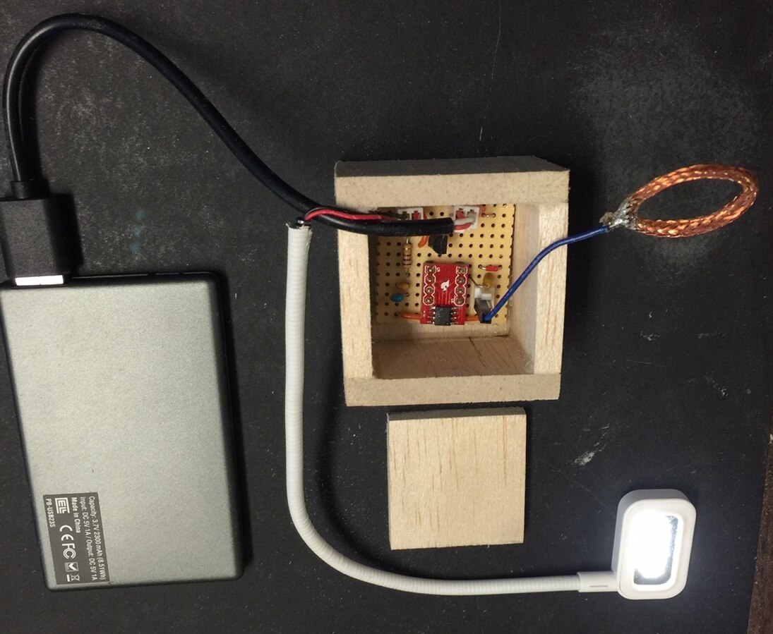

On the 28th of June, Scott posted his second to last update, and detailed his progress on the touch-sensitive lamp that he has developed for the elap shelf. After crafting a small balsa wood box to house the electronics, a small 2300mAh USB power bank was repurposed to power the LED light.
The LED lamp is controlled using a NXP PCF8883NXP PCF8883 Capacitive touch proximity switch IC that was included in the Make Life Accessible kit, and as you can see from the schematic above, it's quite a simple circuit to build. The addition of a light source to this table is definitely a nice touch, and should provide the end user with some added value.
