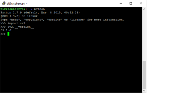

Let’s verify that your OpenCV installation is working by importing cv2 , the OpenCV + Python bindings:
$ python
 >>> import cv2
 >>> cv2.__version__
 '3.1.0'
You can see a screenshot of my terminal below, indicating that OpenCV 3 has been successfully installed:
