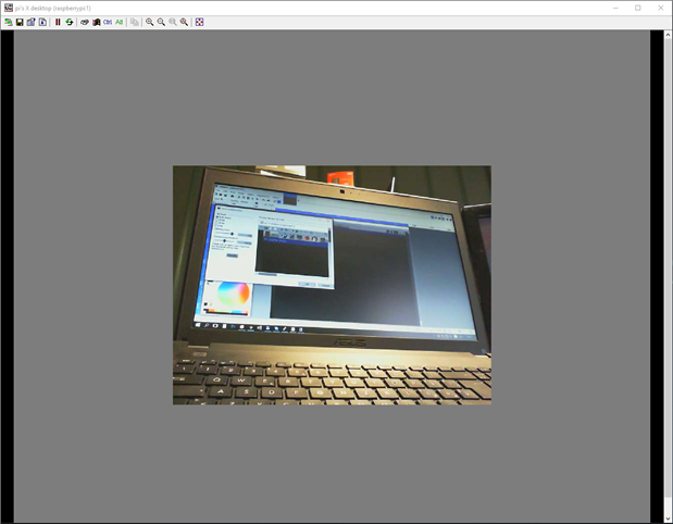

Getting Started With PyGaze
In the zip file we just downloaded, there are several example experiments located in the directory pygaze/examples/. Unfortunately they do not run with a webcam, but requires a commercial eyetracker (currently EyeLink 1000, SMI RED and Tobii TX300 are supported). A dummy eyetracker is supported: the eye movements can be simulated using the mouse to test the experiments you are devising.
So for the moment, I was oly able to run the project in the show_webcam folder, that simply shows the output of the webcam
