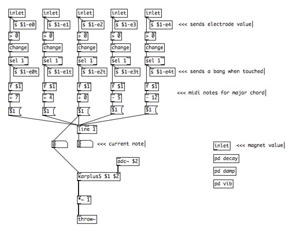

Back in Pure Data
In order to organise the data streams, I created an abstraction to use for the different pads. The creation arguments specify the midi note and ADC input.
This is what the main patch looks like:
And this is is what the pad abstraction looks like:
As you can see, I have set it up so that when each electrode is touched, a different midi note goes into the karplusS abstraction. However, I have bypassed this for the time being. The reason is that the trigger from touching an electrode has more latency than the one from the piezo transducer. This results in a weird effect, similar to a hammer-on on guitar which I don't really like. This was somewhat perceivable when there was only one MPR121 board but with all four boards it seems to have gotten worse.
I am not doing anything with the sixth inlet at the moment. I will explain more about this in a future post but these will be used to transpose all of the notes to change the key of the scale.
The subpatches on the lower right-hand corner receive the bangs from touched electrodes for different effects. This is what they look like (pd damp is bypassed).
