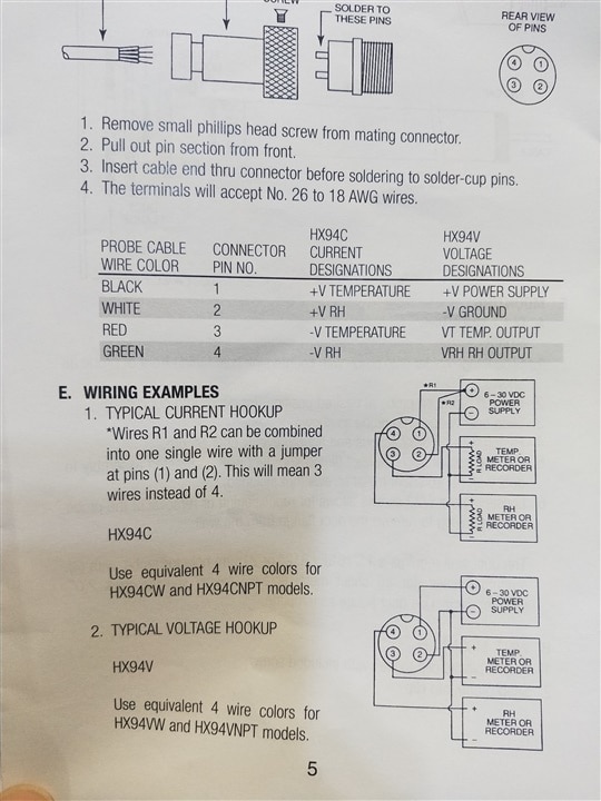

The type HX94C is for current signal and HX94V is for voltage signal. the tye in hand is HX94C.
Refer to Omega HX94C. Datasheet.pdf

5 Apply the power source
Apply 12VDC to pin 1 and GND to Pin 2
the reading is 12.17V DC
while the current get is jus 0.01mA to pin 3
and 0.01-0.02mA in pin 4.
Here is how to connect it.
Ehn, this is still can not solved yet. But, this sensor is not used in the plan.Jus share it.
