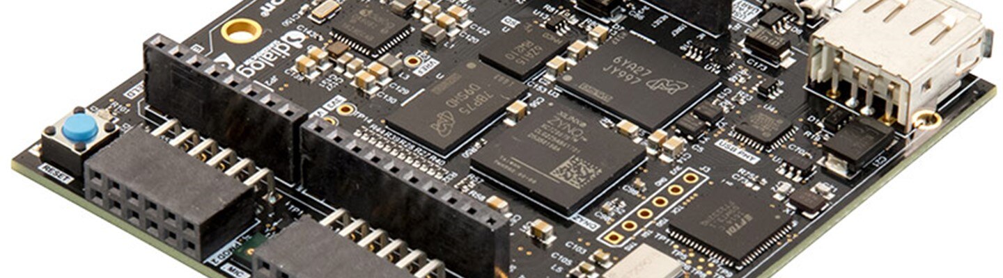

Xilinx ZYNQ-7000 AP SoC consists of a Programmable Logic (PL)(FPGA) and Processing Subsystem(PS) (ARM Cortex-A9). The communication logic/interface between the PL and PS is an essential component of ZYNQ Architecture for data transfer. The AXI Interconnect acts as an important communication link between PL & PS for bi-directional data transfer, compared to other available options. The PL and PS integration allows a high level of performance and reliability that a multi-chip-based solution can't afford.
ZYNQ SoC devices use several communication interfaces based interconnect techniques, optimized and designed to the particular communication requirements of the functional blocks. The interface of PL and PS includes all the connections accessible to the system designer. The communication logic/interface is part of the functional interface type and AXI interconnect is the preferable interface for data communication between PL and PS.
In this blog, I will design a AND gate in programmable logic (PL) and a NOT gate in the processing system (PS). Together it will form a NAND gate. I will test the NAND gate using two switches and one LED. Led and switches will be connected through the external IOs.
