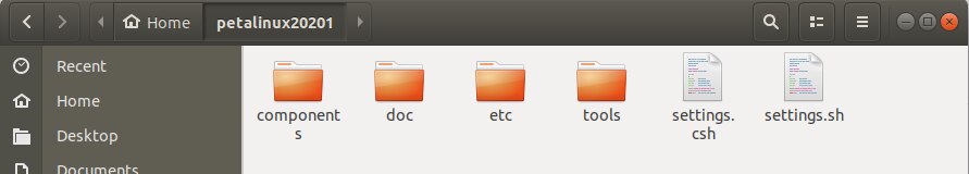

source /home/bartek/petalinux20201/settings.sh
If you don't know where are these files, look in the installation folder.

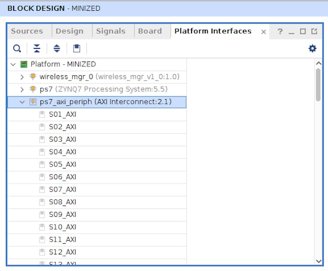

If you wish you can enable additional interfaces for Vitis.
I have enabled M02-M06 Interfaces on ps7_axi_periph

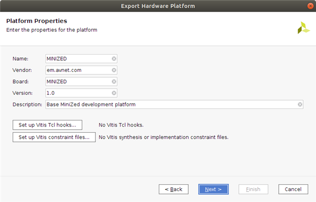

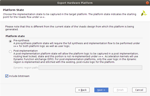

After bitstream generation is finished, export hardware project for petalinux and Vitis.
Click File → Export → Export

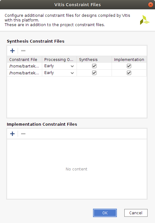

Constrains should be located in your project folder.
Inside "Boards" and "MINIZED" you will find project constrains

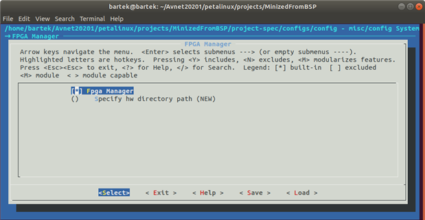

Enable FPGA Manager (for PYNQ)

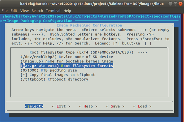

Add extra.ext4 image format.
Exit and save.

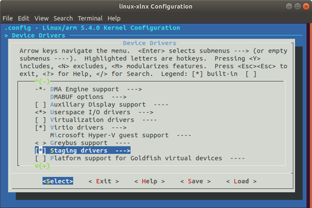

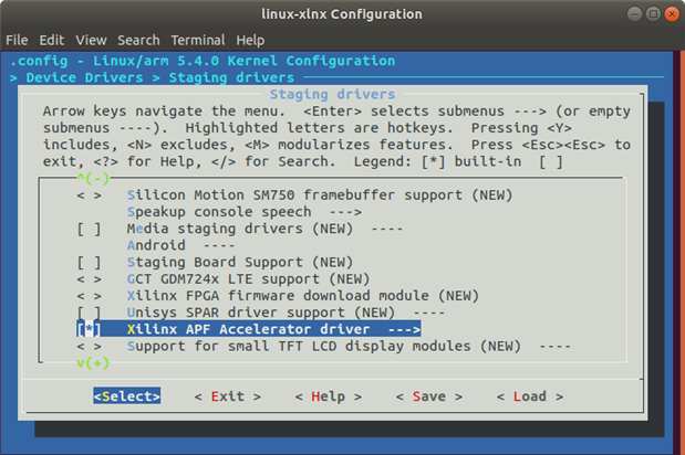

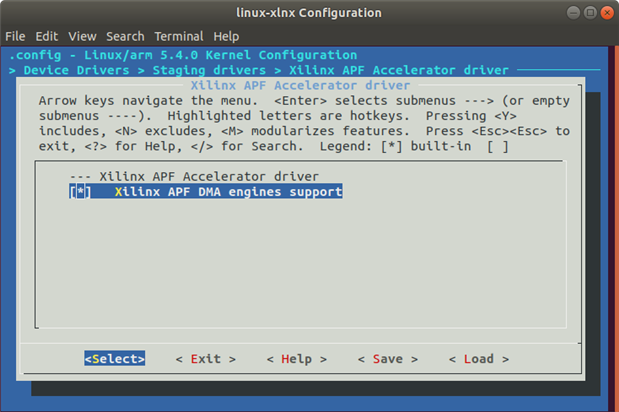

We need to add Xilinx APF driver for XRT platforms.
Type:
petalinux-config -c kernel
And check Xilinx APF Accelerator driver and DMA support.
Exit and save changes.

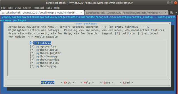

user-rootfsconfig and add PYNQ packages
#Note: Mention Each package in individual line
#These packages will get added into rootfs menu entry
CONFIG_gpio-demo
CONFIG_peekpoke
CONFIG_jupyterandwifi
CONFIG_python3-pynq
CONFIG_python3-audio
CONFIG_python3-pillow
CONFIG_pynq-overlay
CONFIG_python3-jupyter
CONFIG_python3-pandas
CONFIG_python3-numpy
CONFIG_libstdc++
Feel free to look at PYNQ forum to learn more about creating petalinux with PYNQ support https://discuss.pynq.io/c/tutorials-workshops/15

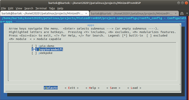

Let's activate these packages.
Open terminal and type:
petalinux-config -c rootfs

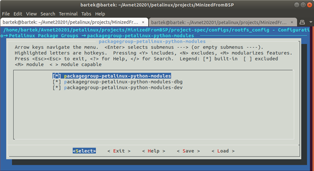

Also go to "Petalinux Package Groups" and activate:
"packagegroup-petalinux-xrt"
"packagegroup-petalinux-python-modules"
"packagegroup-petalinux-lmsensors"
"packagegroup-petalinux"
You can always activate more if you need. Minized have 8GB of memory, so just keep rootfs <8GB
You can use "/" to search for extra packages.

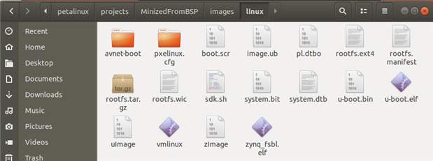

Go to linux→image and copy "rootfs.wic" to USB stick.
*You should format USB to ext4 format, as "rootfs.wic" is bigger than 4GB.*
Open "minized_2020_1" folder (That generated by./make_minized script) and use "boot_qspi_INITRD.sh" to program QSPI.

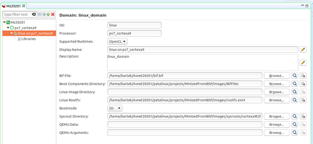

Vitis Platform
In the meantime let's create Vitis platform for Minized.

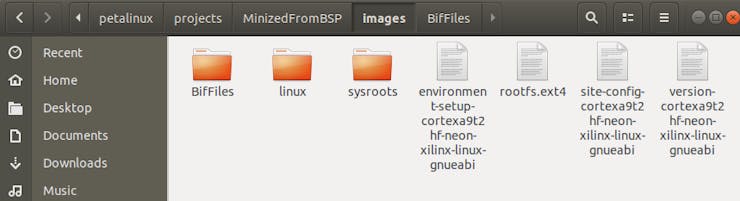

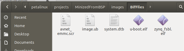

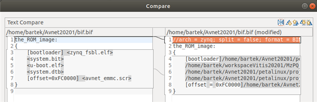

First create.bif
gedit bif.bif
And run "./sdk.sh" it should be located in MinizedFromBSP → images → linux folder.
./sdk.sh

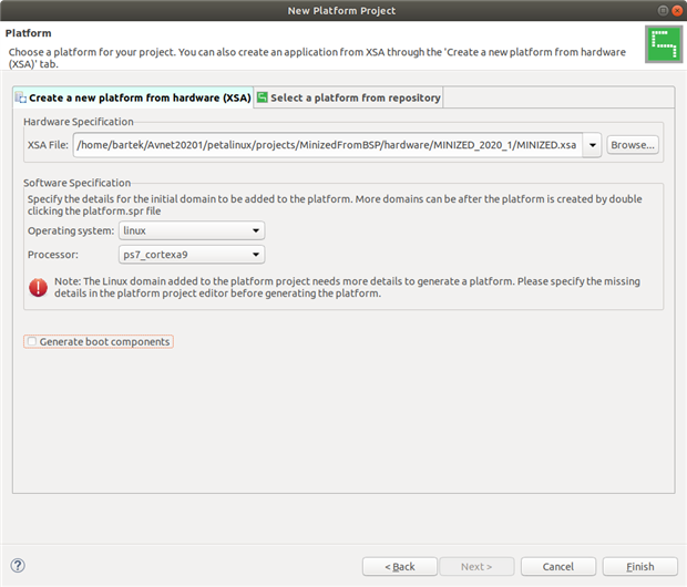

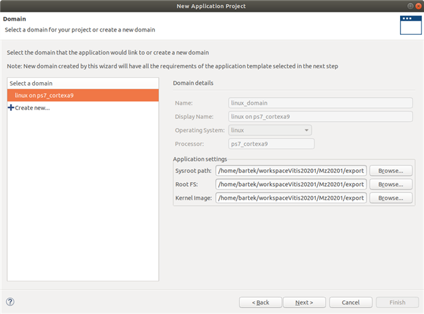

Open Vitis 2020.1 and create new platform project.
Fill in the blank fields and build platform project.

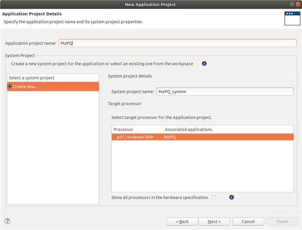

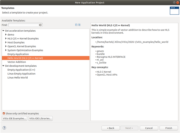

Create new application project
Change project settings to hardware project and build vadd example.

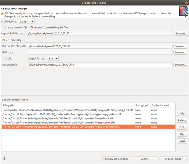

Now let's create BOOT.bin for Minized.
Click Xilinx → Create Boot Image
Click Xilinx → Program Flash and program QSPI memory.
