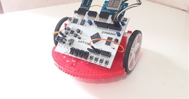

    Hi guillengap  you can use the AXI_Timer IP in the Programmable Logic area.
    I made a tutorial for the Spartan-7. I think it will be easily portable to the minized.
    Arty S7 50 ArtyBot Pulse Width Modulation (PWM) for Motor Speed Control
    javagoza
    In the previous blogs in this series for the " 7 Ways…

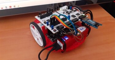

    I also made several PID controllers and a support library.
    Arty S7 50 ArtyBot - Bot Application Framework
    javagoza
    In this post I describe the Bot Application Framework…

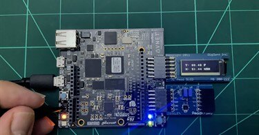

    In order to know how to use the Digilent's vivado library you can look at my last blog:
    P2P3 AMD Vitis portability and reuse. Migrating a Microblaze bare metal environmental monitor App to the Zynq architecture.
    javagoza
    P2P3 AMD Vitis portability and reuse. Migrating a Microblaze bare metal environmental monitor App to...
    Introduction In the current exercise, I want to evaluate…
