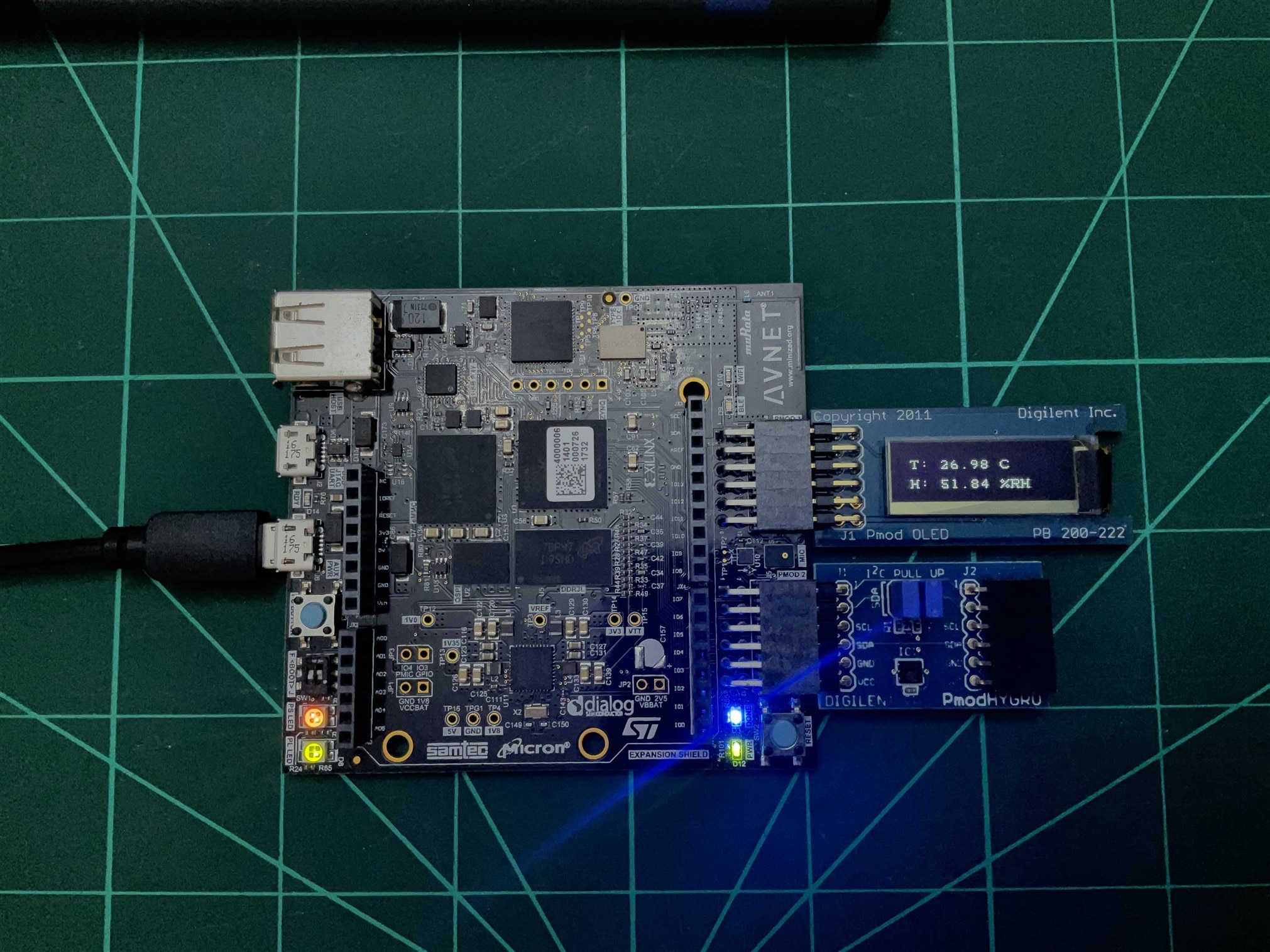

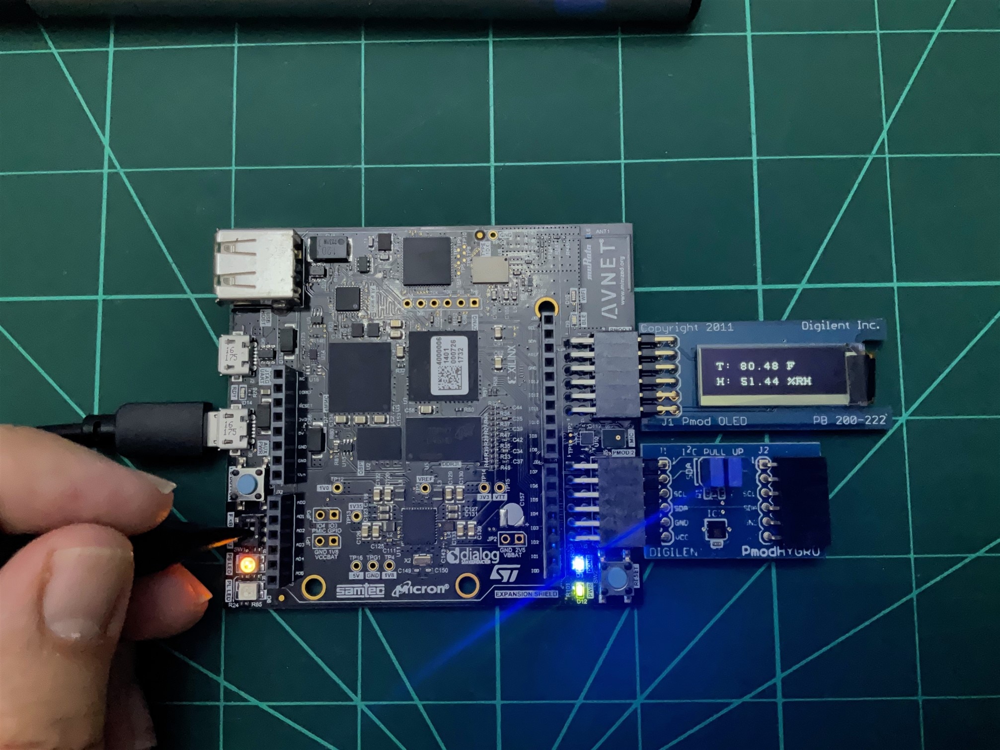

  • Programming the software from AMD Vitis
  • Plug and Program the Device

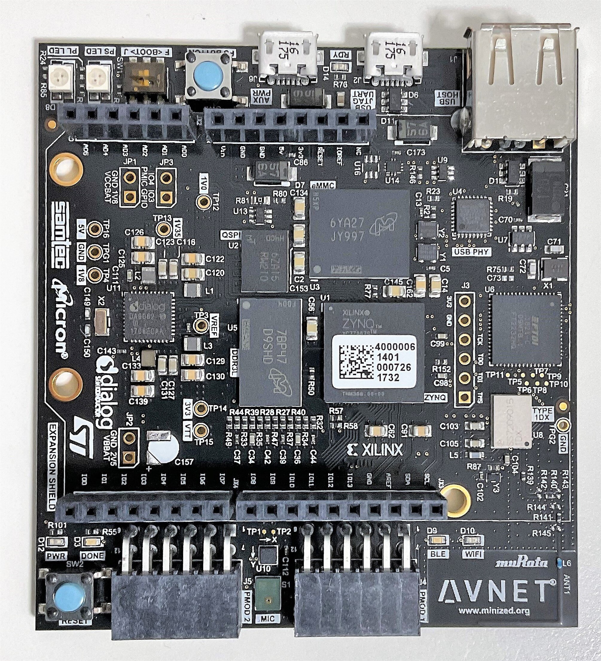

On the other hand, the Zynq-7Z007S is an integrated system-on-chip (SoC) that combines a single-core ARM Cortex-A9 processor with an Artix 7 FPGA fabric on a single chip. It offers a balance between performance and resource utilization, making it suitable for various applications. The integration of an ARM processor with the FPGA fabric provides a seamless interaction between hardware and software.
Artix 7 FPGAs are designed for transceiver optimization and highest DSP bandwidth.
Avnet Minized AMD Zynq-7Z007S
Avnet Minized Zynq 7Z007S
While the MicroBlaze software processor provides flexibility and cost-effectiveness specifically for FPGA designs, the Zynq-7Z007S offers a more integrated solution with a dedicated ARM processor and FPGA fabric on a single chip.

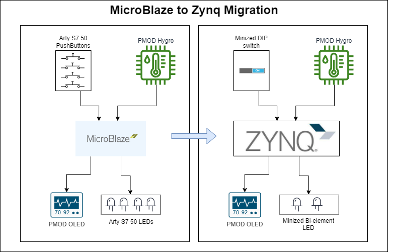

Migrating from the MicroBlaze/Spartan-7 to the Zynq/Artix-7
As shown in the diagram we want to convert the system on the left, an environmental monitor solution based on the MicroBlaze soft processor, into a solution based on the Minized Zynq's ARM Cortex-A9 processor.
In addition to the change of the processor we will have to take into account that the Minized board does not have the four pushbuttons that the Digilent Arty S7 50 board has nor the four indicator LEDs. We will complete that part of the hardware with the Programmable Logic Switch and the Programmable Logic Bi-element LED of the Minized
Environmental Monitor MicroBlaze to Zynq Migration

Then generate the bitstream programming file and export hardware (.xsa file) including the generated bitstream.
Now we can create a new platform project from the exported .xsa
Set the stdin and stdout variables to the uart1 of the PS for debugging purposes under the Board Support Package Settings
And create a new Empty Application Project using that Hardware Platform Project.
Then import the C Application code from the previous design and change only the references to the xparameters.h That's all!

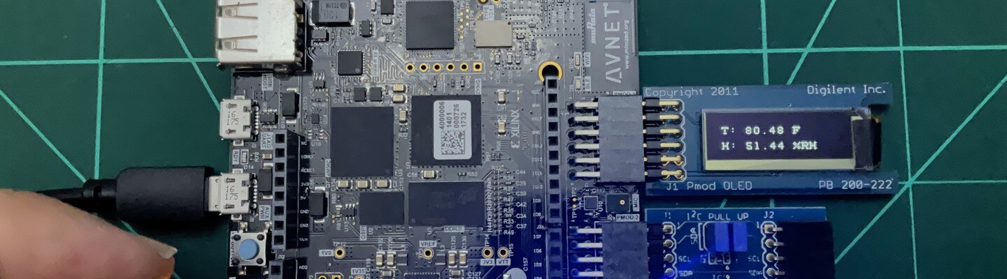

Without further changes to those due to the numbering of the AXI Lite control interfaces, the system works first time.
Avnet Minized Environmental Monitor
Use the DIP switch to change from Fahrenheit to Celsius scale visualization.
