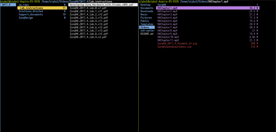

Talking about the training material - I would go ahead and use Vivado 2017.4 version, and minicom as my serial monitor. I would be running this on Ubuntu 18.04, but will be experimenting Vivado on Arch Linux. Would be putting up a paragraph or two of this in the next blog. For now a brief look at the training material :
There is also a pdf which covers the slides in the videos (Highlighted). Size wise, not too bad, I have seen worse image
HW_Chapter 1.mp4

ZynqHW_2017_4_lab_0_v7 :
Nothing much. Just talks about setting up Tera Term (a serial monitor) and Vivado. I plan to keep the same directory structure as mentioned in the lab.

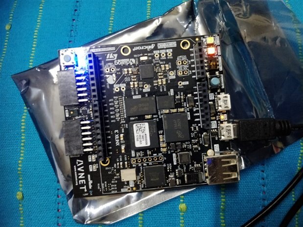

The MiniZed:
The whole kit consists of the board itself, the USB connector, a quick start instruction guide and a safety guide. A few roadtests have been done in the past for this board, do have a look at them! AVNET MiniZed
So booting up the board is like this:
Absolutely loved the little PL and PS LEDs flashing respectively when it's being used. That is a pretty cool feature that can be used for Zynq training boards.

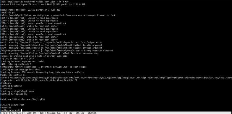

A successful bootup of the PetaLinux bash shell in root :
I plan is to first try out the few tests given on the MiniZed board.

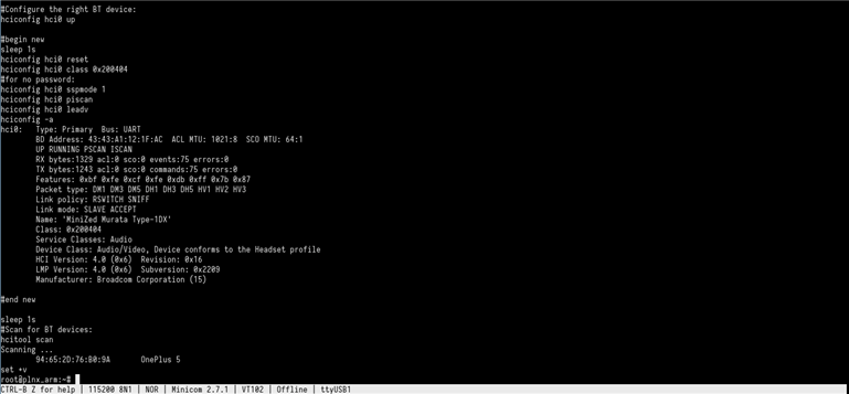

The bt.sh command is a script that scans for nearby Bluetooth devices (here I used my phone as a guinea pig). From what I could guess, the PS offloads the Bluetooth to a "serial device"  (could be a PL side Bluetooth IP, responsible for handling the Murata LBEE5KL1DX Bluetooth module) and then brings back control to the PS which behaves as if there was a bluetooth module attached directly to the ARM processor. Looks like I just would have to dig deeper to find out image.

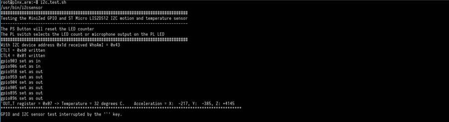

The second script, i2c_test.sh, tests all the GPIO connected peripherals of the PL side. This includes the microphone. temperature sensor and motion sensor. I however could not get the LED counter working. The PL switch was just too damn small to adjust!
