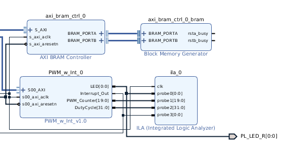

In this case , In order to debug , you have to add ILA (Integrated Logic Analyzer ) IP block into your PL Design and Attach the Line states or Pins/Ports you would like to Observe to the ILA probes Inputs just as shown in below figure.
Here we need to give PL fabric Clock from PS (for eg:FCLK_CLK0 ) ILA 'clk' Input and the Probes lengths are varied based on the Width of the Lines we connect to it.

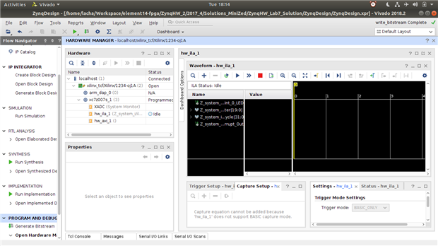

When you are Running  the Program on the Minized Open In Vivado the Hardware Manager Option , Under Program and Debug Heading (below Generate Bitstream).
If the Hardware Manager Prompts 'No Hardware Target is Open' select "Open Target " beside it and select "Auto Connect"
Vivado Connects to the Minized Device and gives the Possible Probe Interfaces you can See as Attached Probes, as shown in fig:image
Here On the Hardware Tab you can See XADC , hw_ila_1(ILA) , hw_axi_1(jtag to axi interface).

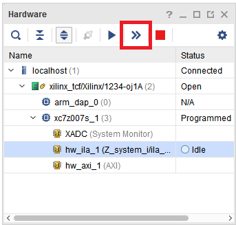

hw_ila_1 refers to the ILA which shows that it is in IDLE mode i.e.., It is not Capturing any Events on the Probes , you can Select the "hw_ila_1" interface (or similar to that name in your Design) and  click "Run Trigger Immediate for this ILA Core" as show in Red Mark below :
This Gives the Immediate Logic Values on the Probes at that Moment .

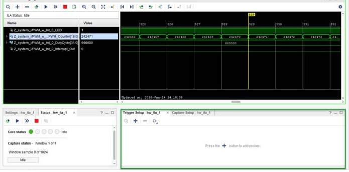

Similarly you can go for Continuous Capture where you get Data on Probes Flowing Real Time continuously just as you were using some Logic Scope .
It also gives you a feature in which you tell Vivado to Capture the Traffic (Am i Irritating ?) .

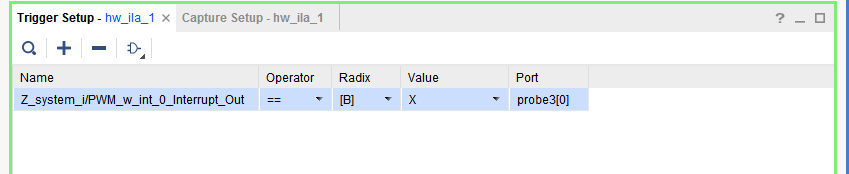

For that Feature , you first select which Logic Probes are best suited for that (Interrupt pins are used in such cases) , Go for Trigger Setup
Select the '+' button and Set the Value to when you want Capture to Start (R for +ve Edge Triggering and soon)

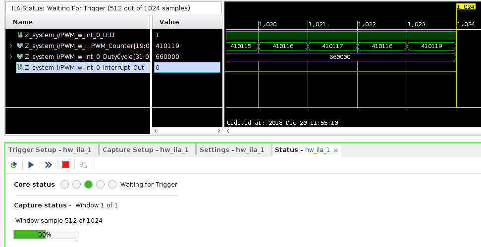

That's it , you can observe that ILA is in waiting State as long as there are no triggers
Here the Default setting is that the ILA prints Half of the Samples(512 in my Case) before Triggering and rest after Triggering , we can change it if required.
