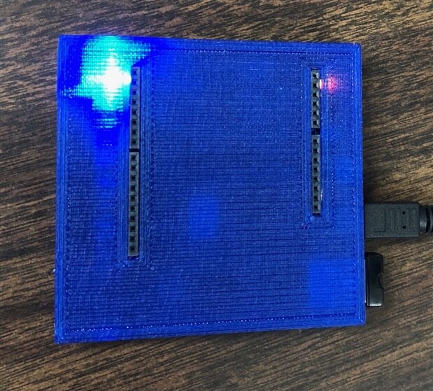

While waiting for the official training package to arrive, I decided to make a couple of MiniZed enclosures using the 3D printer.
I purchased another MiniZed board so I could have one at home, and one at work
Manuel Alejandro Iglesias Abbatemarco designed an enclosure, and I tried to print his design, although the cutouts for fasteners and cooling holes turned out to be a problem.
His files can be found on Hackster here: https://www.hackster.io/mhanuel/minized-linux-tutorial-part-i-e2fa9d

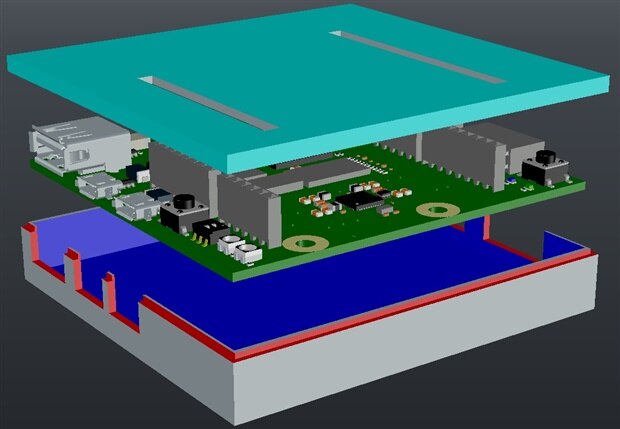

So after a few tries at printing his part, I designed my own "ZedBox" with posts instead of holes for fasteners.
The top plate has a 1mm grove around the perimeter to lock it onto the bottom, and the size is designed to have the GPIO pins flush with the top surface.
I left the clear rubber bumpers on the board as spacers.
This ZedBox was printed using translucent PLA material so the LEDs can still be seen with the top installed.
Here are the .STL files if you'd like to print your own.

    Ok - first pass. The encloselure was a tight fit! I also found that my printer bed is a little out of square as the top was slightly out of square with the bottom. cant wait for rev 2 with button access…

    Nice enclosure, Scott! I might print one based on your files for myself as well!
    shabaz over 8 years ago
    Hi Scott,
    That's very cool : ) I too tried to think up some enclosure, but it was hard! : ) The board is packed, not a lot of area to attach to.
    Congrats on a really nice-looking overall design, even for a first revision.
    cant wait for rev 2 with button access and some extra holes.

    ZedBox V2 will have switch extentions and LED viewports.
    Scott
