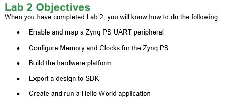

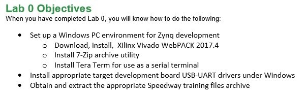

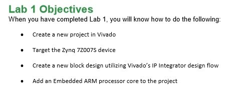

Here are the objectives for the first few labs:

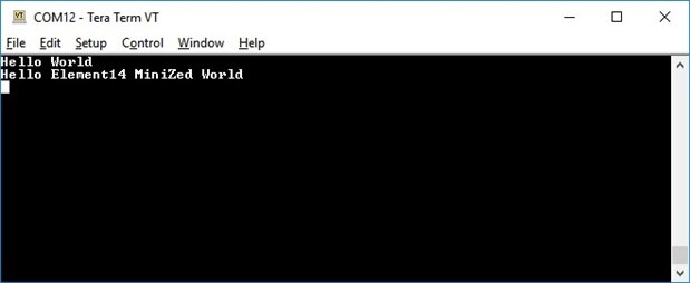

The instructions were very clear, although I'm not sure of all the why yet, I managed to output some ASCII
The lab pdfs link to a 790pg technical reference manual for your reading pleasure.....ug585-Zynq-7000-TRM.pdf

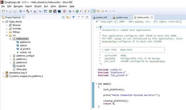

Once Vivado and the SDK are configured for the MiniZed hardware, the actual code is minimal.
