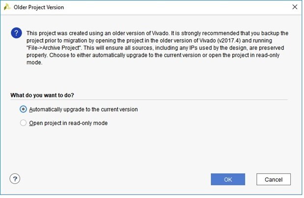

When I ran Vivado with the new workspace I got a few messages:

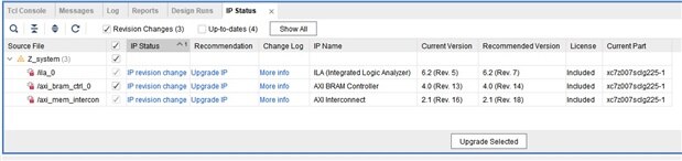

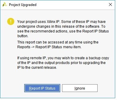

2018.2.2 Vivado complained about IP upgrades, so I upgraded them.

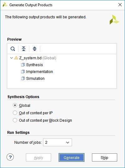

Then Vivado wanted to re-generate outputs and run synthesis and implementation again.

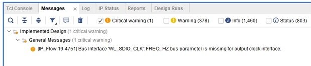

After all was complete, I am down to 1 Critical Warning:
