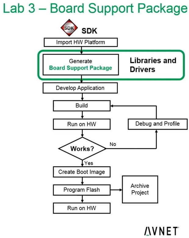

The flow of the SW training modules is shown below.

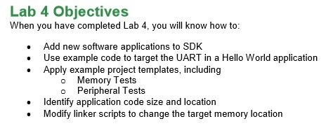

The Objectives for SW Lab4 were similar to the HW Lab2:

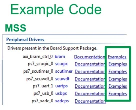

There is example code for using the various peripherals attached to the driver descriptions listed in the .mss file.
You can cut and paste from these example files for use in your own applications.

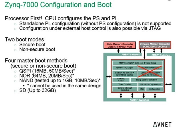

The Zynq platform has various memories for program and data storage.  The MiniZed does not have all of these implemented.
The example code was loaded into QSPI memory and executed using a FSBL (First Stage Boot Loader).

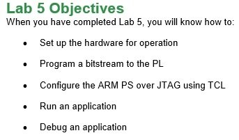

Lab 5 objectives:

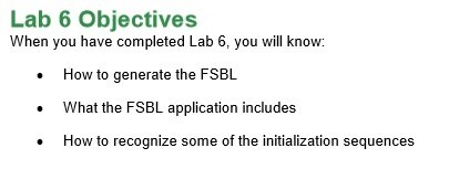

Lab 6  objectives:

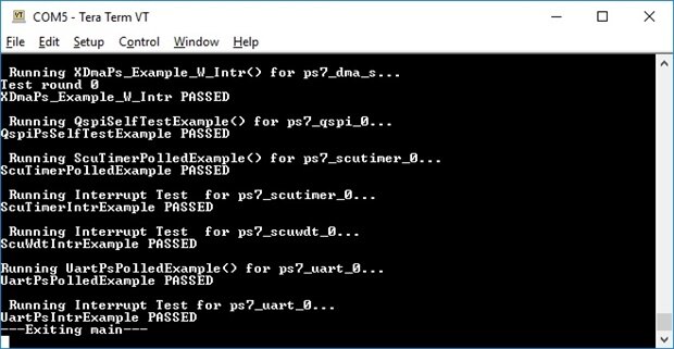

At the end of Lab 7, the FSBL was loaded with a BSP for the MiniZed and an application to test peripherals that would load and run at power-on.
The output is shown using a terminal program on COM5.
So at this point, I should know how to write some code and install it such that it runs at power on.
