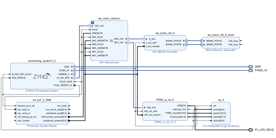

Here is the 'Before' image showing the output from the previous lesson; and startpoint of Lab 9:
This is what we see starting Lab 9 when we open the previous lesson.
We can see the Zynq processor, the AXI Interconnect; which only links to BRAM and the PWM Controller.

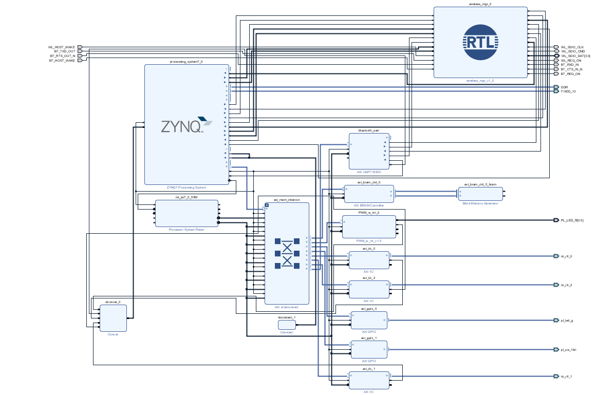

The Final result after running the TCL Script:

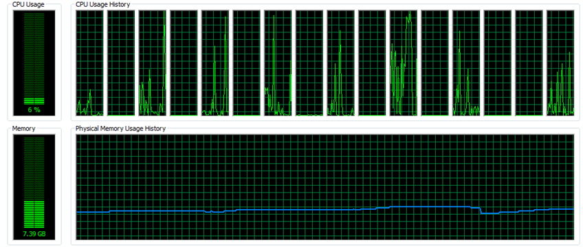

The program appears to only use a single core. The computer seems to move the thread around from core to core, but only one core is ever utilized at any given time. The training notes that running synthesis can take anywhere from 15-45 minutes. My computer was closer to the 15 minute mark but there were a few other steps like writing the bitstream that still had to happen.
Interestingly, running the Synthesize command takes a long time. An examination of Task Manager tells the story:

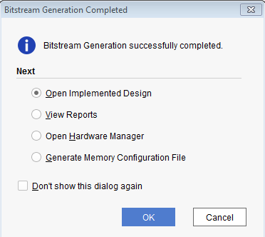

Once that is complete, this message appears; prompting to open the new design:
We now have PMOD connections (2x), a Wireless controller, a Bluetooth UART, and all the other requisite interconnects. Check out the video posted above for a walk through of all of this!
