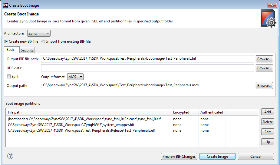

We will be using the "Test_Peripherals" application as the startup program. The build configuration is set from "Debug" to "Release" which as noted in the previous post, creates a more compact version of the file. We then create a "BIF" - Boot Image Format" file that will be used to upload; and includes the bitstream of the hardware configuration. It also contains our FSBL and application program (ELF).
This is the dialog to create the boot image. We have changed the "Output Format" in the center to "MCS" to allow targeting the SPI Flash memory as opposed to 'boot from SD' which isn't nativity supported on MiniZed.
The "BIF" file is then generated and saved to disc. My file is very small (1K) and just contains pointers to the FSBL, the bitstream, then finally the Test_Peripherals.elf file containing the software.
Here is the complete contents of the file:
//arch = zynq; split = false; format = MCS
the_ROM_image:
[bootloader]C:\Speedway\ZyncSW\2017_4\SDK_Workspace\zynq_fsbl_0\Release\zynq_fsbl_0.elf
C:\Speedway\ZyncSW\2017_4\SDK_Workspace\ZynqHW\Z_system_wrapper.bit
C:\Speedway\ZyncSW\2017_4\SDK_Workspace\Test_Peripherals\Release\Test_Peripherals.elf

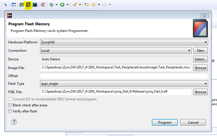

and /finally/ We can program the flash memory!
This is the "Program Flash" icon at the top of the screen. All that's needed is links to the image and the FSBL file as shown here.
It should take a minute to program the flash from this point.

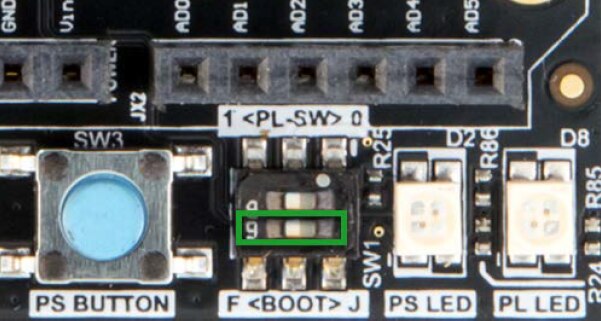

I also played with the "Boot mode" switch - This should be set to JTAG boot (which it was). I tried the Flash boot mode and it was called out in SDK as a potential issue; and of course it still didn't program properly.

Wait - After running the debugger then programming again, I was finally able to get it to succeed!
****** Xilinx Program Flash
****** Program Flash v2017.4 (64-bit)
  **** SW Build 2086221 on Fri Dec 15 20:55:39 MST 2017
    ** Copyright 1986-2017 Xilinx, Inc. All Rights Reserved.
Connecting to hw_server @ TCP:127.0.0.1:3121
Connected to hw_server @ TCP:127.0.0.1:3121
Available targets and devices:
Target 0 : jsn-MiniZed V1-1234-oj1A
Device 0: jsn-MiniZed V1-1234-oj1A-4ba00477-0
Retrieving Flash info...
Initialization done, programming the memory
BOOT_MODE REG = 0x00000000
f probe 0 0 0
Performing Erase Operation...
Erase Operation successful.
INFO: [Xicom 50-44] Elapsed time = 3 sec.
Performing Program Operation...
0%...50%...100%
Program Operation successful.
INFO: [Xicom 50-44] Elapsed time = 6 sec.
Flash Operation Successful
So the SDK was somehow unhappy with something that I had done and by maunally programming the FPGA first; I was then able to save to Flash.

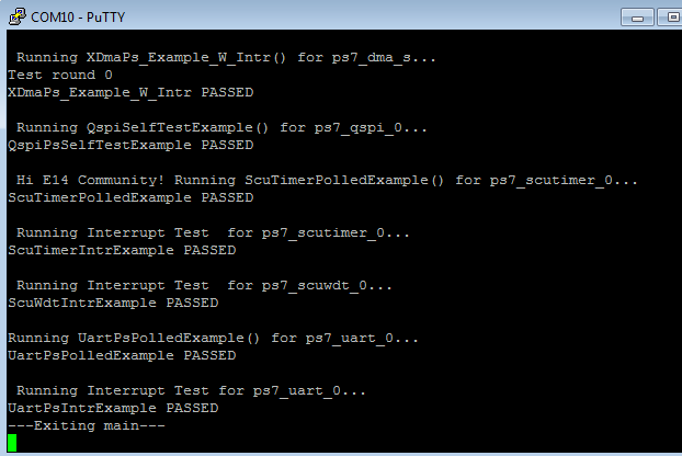

The final step is to set the Boot Mode switch back to Flash and power cycle the board. I was able to verify that the Test_Peripherals program was now running instead of the stock 'Hello world' program.
That was done and I am able to call this lesson complete!
