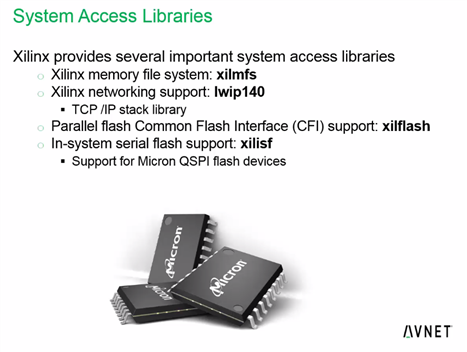

Chapter 10 Video - Xilinx Libraries

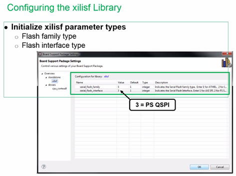

This video explored the system libraries that Xilinx includes with SDK. These can be configured and initialized from the BSP settings eg- the Flash library allows users to select the manufacturer (Atmel, Microchip, Micron etc.) and the different interfaces. Xilinx libraries also comes bundled with example code.
Lab 10 - Xilinx Libraries
In this lab, the flash library was used to read & write configuration data - which in this particular case was a MAC address.
A new BSP was generated and 'xilisf' (Xilinx In-system and serial flash library) was enabled. For the application, import the provided code.
The second part of the lab explored the provided code which used the xilisf API - which involved using functions to initialize, read, write & erase the contents of the flash. The provided application allows users to store and recall a MAC address over the serial (UART) interface.

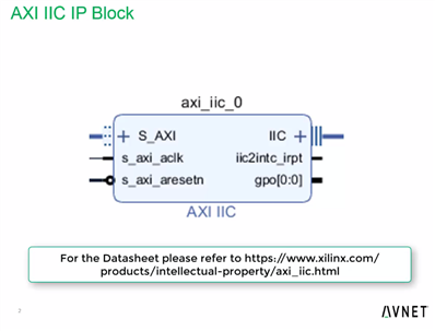

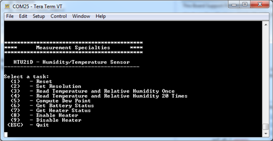

Chapter 11 Video - TE Sensor PMOD

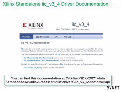

At the end of Module 1: Developing Zynq Hardware, we executed a TCL script that added a bunch of hardware to the block diagram - one of which was the AXI - I2C interface. The Avnet example for the TE Sensor PMOD uses this interface that resides in the PL via Xilinx provided drivers. This video briefly went over the AXI-I2C interface, the documentation, the HTU21DHTU21D PMOD and other PMODs that are available.

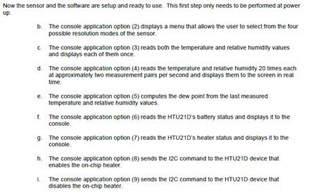

Lab 11 - TE Sensor PMOD
This lab first explored the documentation for the AXI-I2C interface's peripheral drivers.

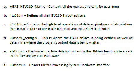

Application code is provided, but I did not run it as I did not have access to the PMOD.
image image
The lab instruction document lists out the files and their functions.

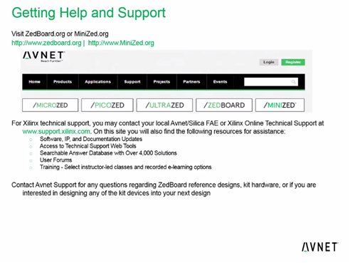

Chapter 12 Video - Next Steps
The video went over hardware and software that is available from Xilinx and its partners and how (and where) to get help and support.
It concluded with a review of what was covered in the Developing Zynq Software course.
