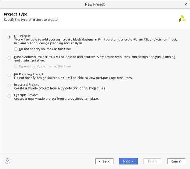

The main purpose of this lab is to illustrate how to create a new Zynq project using UltraFast Design Methodology within Vivado Webpack.
Zynq Proccesing System (PS) has a configurable set of built-in peripherals and direct access to Programmable Logic (PL) that can build any custom IP. So, I we need we could create dedicated soft IP in PL and use it in PS.
1. Create a new Zynq project in Vivado
Below there is gallery with step-by-step instructions how to create a new project. Each step is described in image description.
{gallery} Creation of new project in Vivado

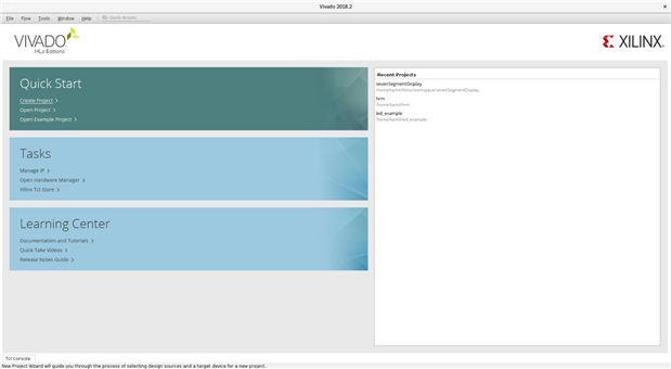

Click on Create Project.

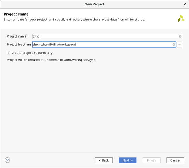

Set the project name and project location.
This will be a RTL-based project, so please leave the radio button for RTL project selected.

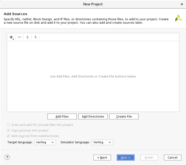

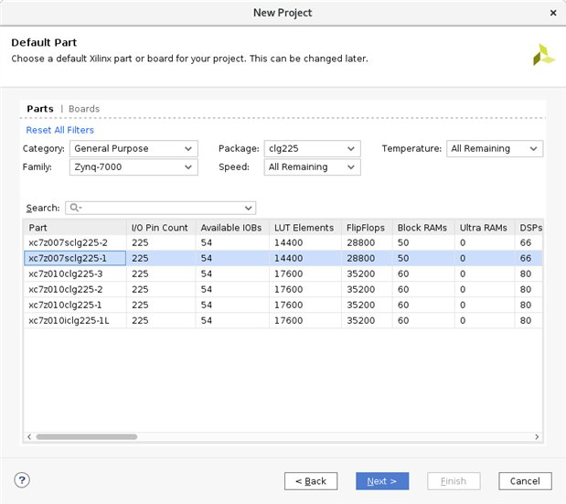

Select VHDL as target language. Click Next two times.

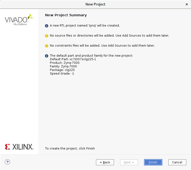

Select target device: xc7z007sclg225-1.
Click Finish button.

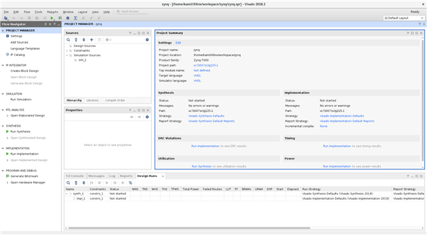

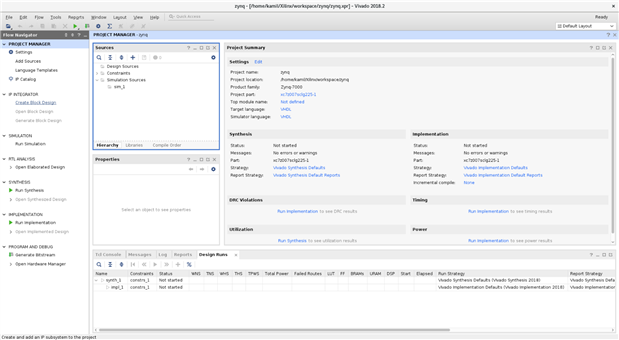

There is Vivado design cockpit.

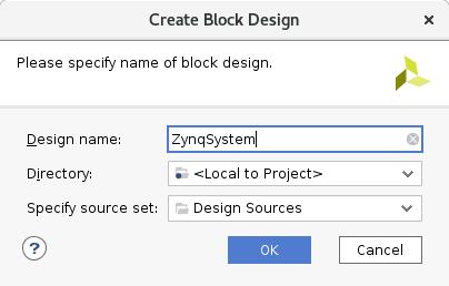

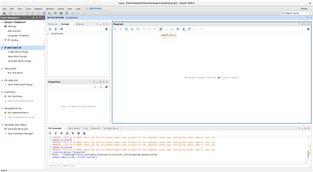

Select Create Block Design.
Enter the block design name.

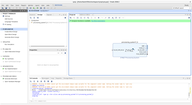

Select Add IP from the top bar of Diagram window. From search window choose ZYNQ7 Processing System.

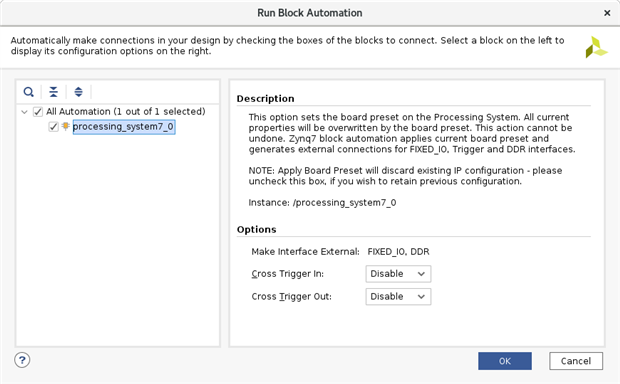

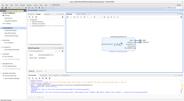

Click Run Block Automation to perform automatic connection of IPs in block design.
This wizard automatically detects if is required to connect external interfaces for FIXED_IO and DDR. FIXED_IO are dedicated peripherals in the Zynq PS like UARTs, USB or Ethernet. Click Ok.

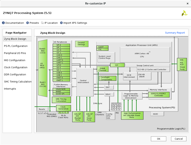

Click the Save Block Design button to save the block design. You could launch customizations by double-click on the ZYNQ7 PS IP block.
At this screen you could reconfigure ale PS features.
