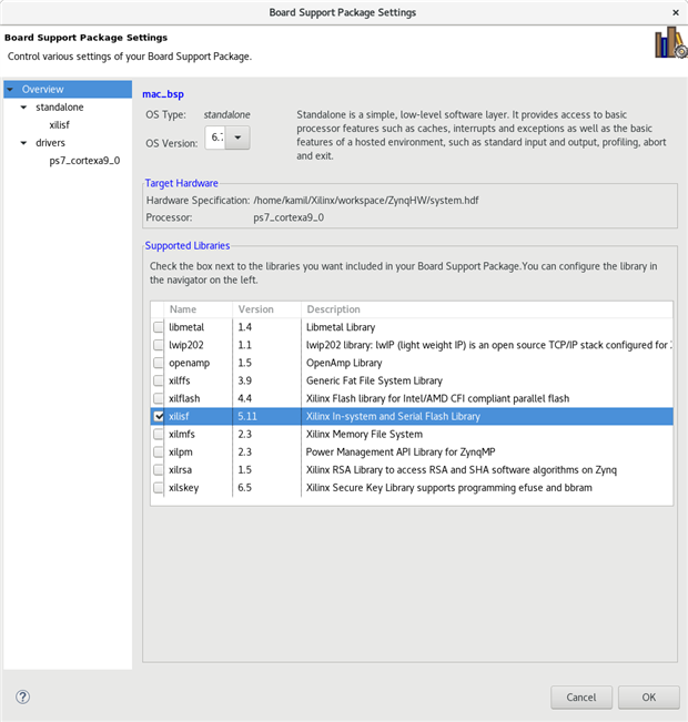

We need to modify a BSP to enable support for Xilinx in-system and Serial Flash Library. We need to select a xilisf item in the Supported Libraries:
Then we need to choose Overview -> standalone -> xilisf:

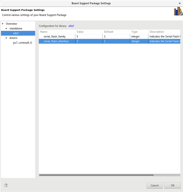

We need to set proper values for serial_flash_family and serial_flash_interface. Value 5 means the Micron Flash family type. Value 3 specifies the QSPI flash interface type.
When build process finishes we are able to launch application on hardware.

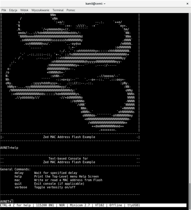

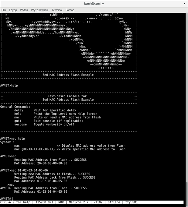

Application has interactive menu which allows to read or write MAC address. Here is example output for this procedure:

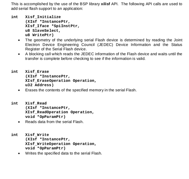

Here is description for xilisf library API:
