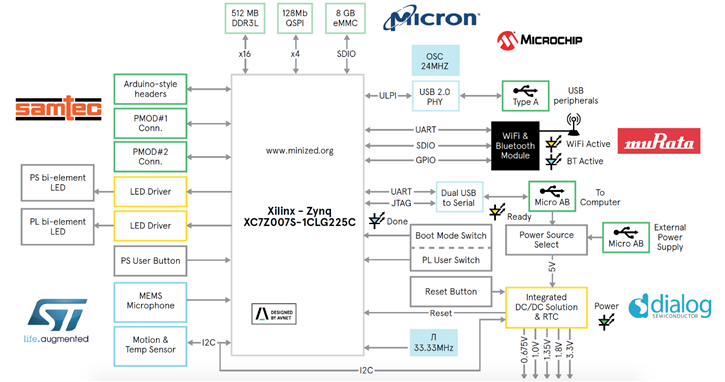

Block Diagram of the MiniZed Board
A descriptive Block Diagram of the MiniZed

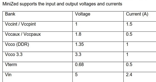

MiniZed Power Architecture
Coming from an analog side of engineering if I see a PCB I feel an itch image to know its power consumption and to see if it offers a balanced perspective with regards to power consumption. Having a power efficient product has become very important specially if it wants to have a fair chance to make it to the product line. And of course look its schematics.
A current and voltage requirements Overview

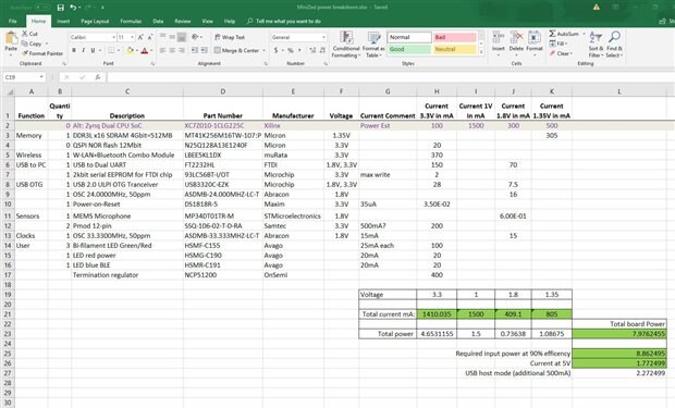

Board Level Power Budgeting on the MiniZed Board. Reference
Fig: The generic power consumption of the dev-board
From this analysis one can see that the total power consumption of the internal parts of the MiniZed is around 8watt. But ofcourse the total power consumption of my project will depend on how many of the parts on board are in use. This rough estimate is a good indication of the current requirements of the FPGA.

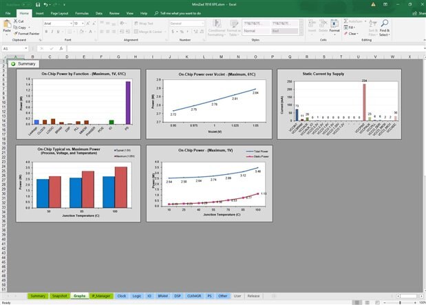

Also I downloaded the famous Xilinx Power Estimator (XPE) from the MiniZED website and gave it a go.
imageFig: Summary of the XPE for the MiniZED board
I had a feeling that the Minized board was getting hotter after I had left it on continuously for sometime. Looking at the graphs below it seems that the board is designed to get heated upto 70 degC for a total power consumption of around 3watts (mind it which is less than half of the full power 8Watt Minized). I suppose under such intense use a need for heat sink or proper heat dissipation will arise.
Power vs Temperature Graphsimage
Xilinx Power Estimator (XPE) is a good tool to play around with. I also looked into the other tabs such as clock, logic etc. in the XPE excel-sheet
