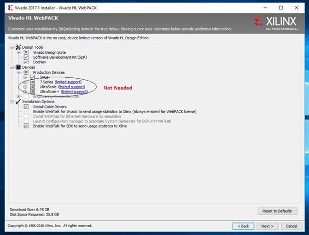

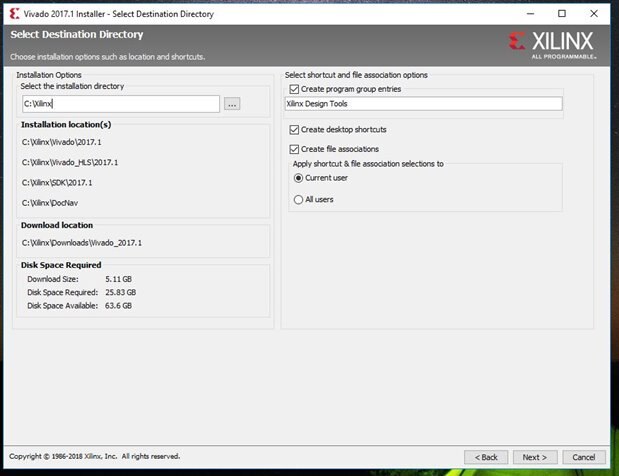

This lab focused on the installation of Xilinx Vivado WebPACK 2017.4; using Tera Term for serial communication and USB-UART drivers for the development board. I am working with windows edition. A trick during Vivado installation to reduce the memory usage by Vivado files is to un-check the devices that we donot need in this training such as Ultrascale and Virtex. By default Vivado tries to install everything which is really not needed and save the precious memory on the C: drive.
I tested it with the Xilinx Vivado WebPACK 2017.1 and Xilinx Vivado WebPACK 2017.4 installer.
Saved me some precious Disk Space imageimage !!!!!!!

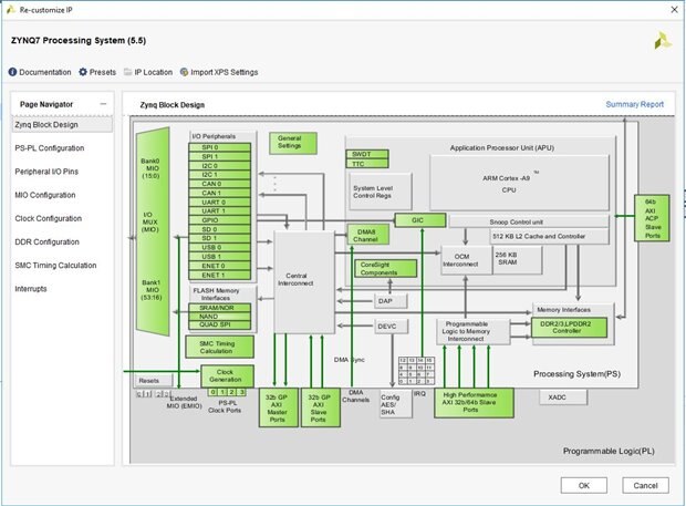

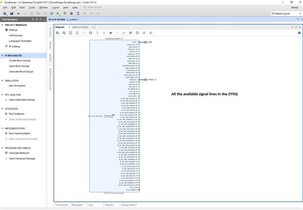

Next important step was to learn to customize the Zynq processing core
Customizing the ZYNQ and its peripherals can be done here
Lab2
Task1 : Enable and map a Zynq PS UART peripheral
The UART is set to UART1 peripheral with Baud Rate is set to 115200 in the Zynq PS.
And the clock setttings must be check for each board separately.
Task 2: Configure Memory and Clocks for the Zynq PS
For minized board Clock settings are:
  • Input frequency is 33.333333 MHz
  • CPU frequency is 666.666666 MHz
  • DDR frequency is 533.333333 MHz
And also the correct DDR Memory Device must be set in DDR Configuration page. For Minized the DDR3 memory used is MT41K256M16RE-125
Also the correct DQS to Clock Delay and Board Delay settings has to be set. It is specified as delays in the PCB. The parameters are specific to each PCB design and Zynq package. The values are based on the PCB trace lengths and the specific Zynq package.

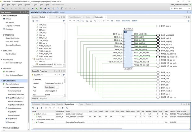

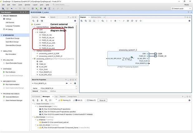

Task 3: Build the hardware platform
How the design is mapped on the device
The Schematic Overview
Quick Power Analysis of the design

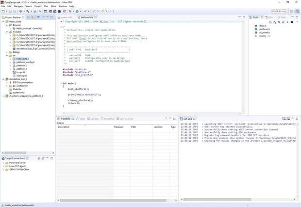

Task 4: Export a design to SDK
imageAfter exporting the bitstream file from Vivado to the SDK

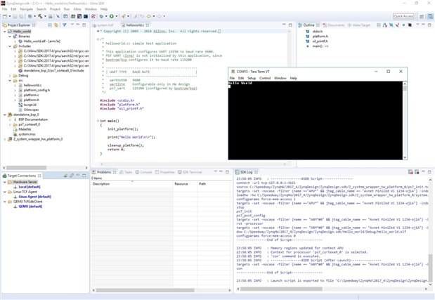

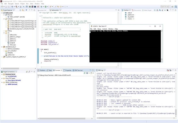

Task 5: Create and run a Hello World application
And... The Hello World runs successfully
Conclusion: As one may have noticed there are many steps involved from creating the simple hardware in Vivado to the correct settings for Zynq PS and finally migrating the board support files to run the Hello world in Vivado SDK software.
