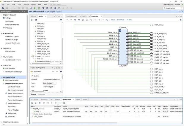

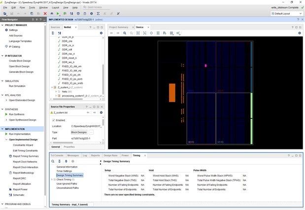

Task 3: Build the hardware platform
How the design is mapped on the device
The Schematic Overview

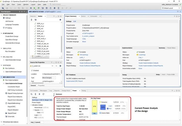

Quick Power Analysis of the design
