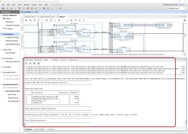

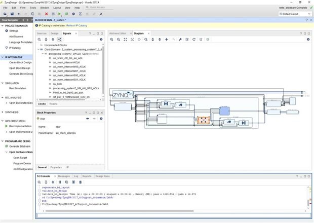

Finish Hardware Build using Tcl

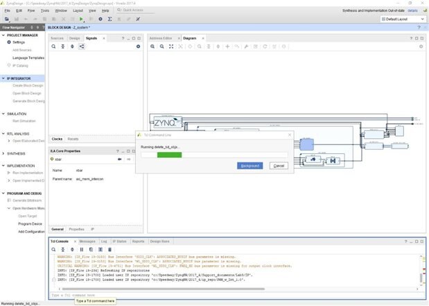

The advantages of using tcl are many. This being the hardware programmer can work independently from the GUI. There is no more dependance on the changing versions of the Vivado GUI but the learning curve for the tcl scripting is quite high and steep. I have seen experts struggling for quite some years to get a full hang of the tcl way of programming. Here the plan is to add an ip core from Avnet using the tcl window and also spending some time to look into the tcl code and analysing the tcl script. The tcl script was also sent to us by the training program and is not self written
Continuing from the previous project lab 8

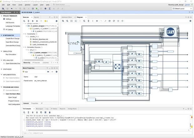

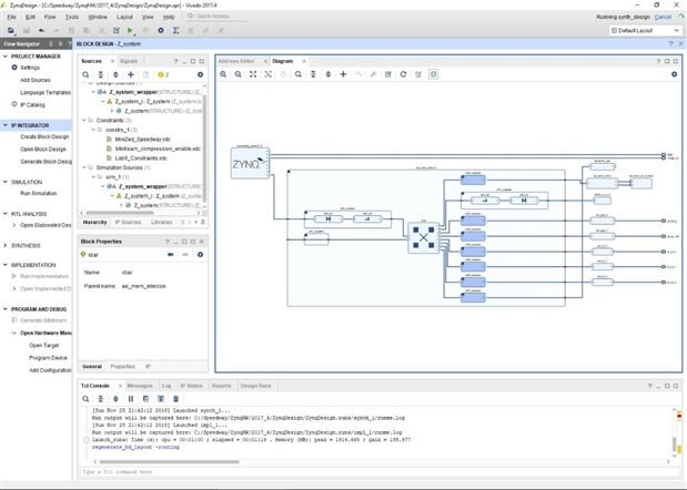

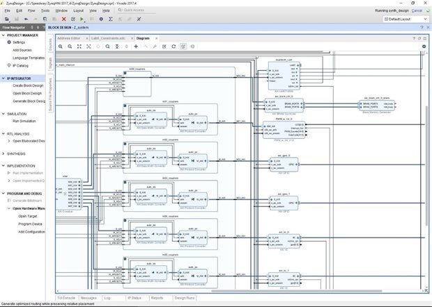

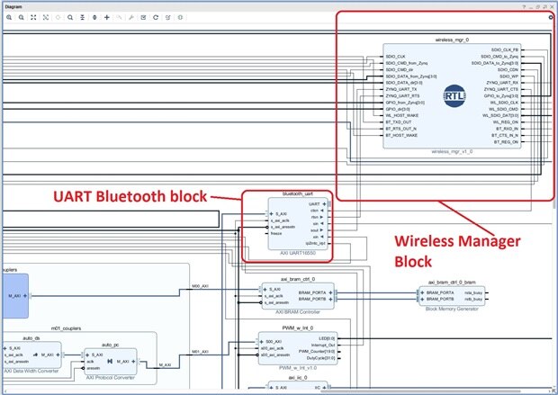

Adding the Avnet IP which is a wireless manager block. The block deals with all the wireless radio interfaces that are available via the Murata module located on the MiniZed.
The full design after the Avnet IP wireless manager block is added to the current design.
Deep look into the Avnet IP wireless manager block.
Many other ip block such as the GPIO blocks, AXI IIC Block and xlconcat are added to the design which are related to the wireless manager and the bluetooth ip cores. This makes the design very complex. I did spend a significant amount of time to understand what was going on in the design after the whole thing exploded in my face image
Many such downloadable Vivado IP core are available at the Avnet website

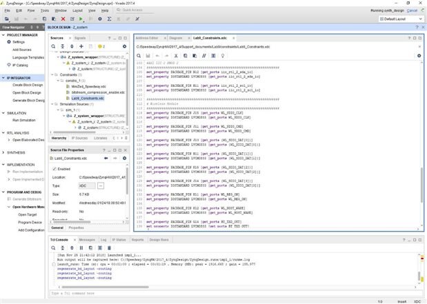

Look into the .xdc file
The timing constraints for the wireless manager ip core was also delivered with the project sample. As one can see each used hardware port in the fpga needs to be constrained by setting the correct LVDS IO standard and the pin package. writing your own .xdc files is a tricky job hence I am happy we were not asked to write our own files. The various constraints will route the interface signals through the Programmable Logic out to the various interfaces on the MiniZed.
Some links to understand xdc file
https://www.xilinx.com/support/documentation/sw_manuals/xilinx2012_2/ug945-vivado-using-constraints-tutorial.pdf
https://www.cl.cam.ac.uk/research/srg/netos/projects/netfpga/workshop/technion-august-2015/material/slides/2015_Summer_C…
A detailed look into the .xdc files for the Lab 9

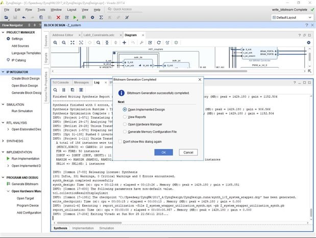

Playing around with the RTL reports of the generated project
Finally generating the bit-stream ready to send/export the hardware to the software SDK.

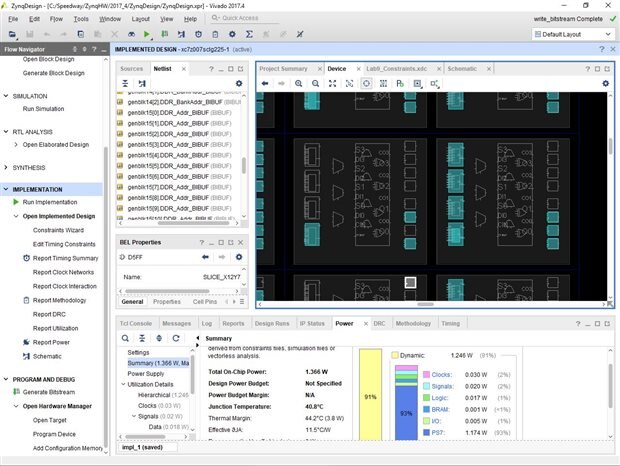

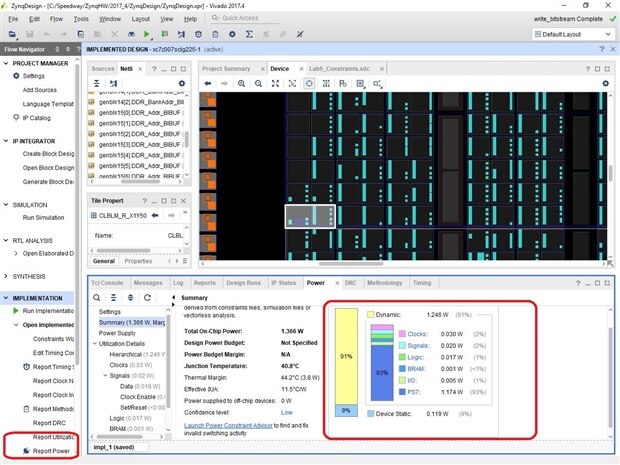

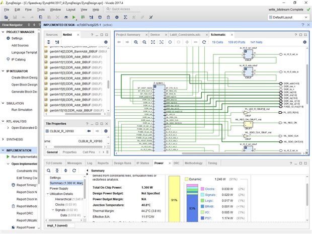

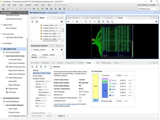

Power Utilization of the project
There is a lot to play around and I dedicated some time to see the power consumption graphs generated in the final project. There are also more detailed txt files of power consumption which one can play with share around.
The final power utilization of the chip with the final project

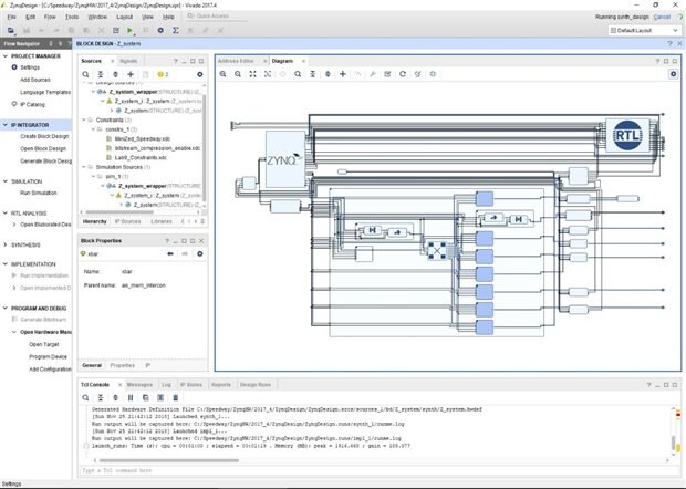

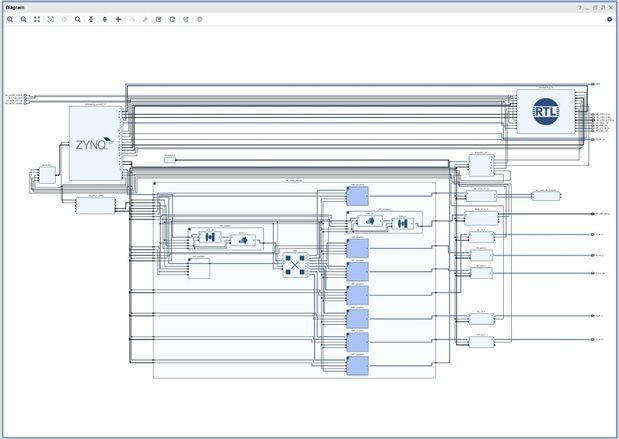

Final Device and Schematics
As a self exploration I also went and looked into the generated schematics for each block. One can really zoom in and go as deep as to see the RTL blocks that are generated on the fpga chip.
How the final project system on chip looks like above
New schematics of the hardware in the project

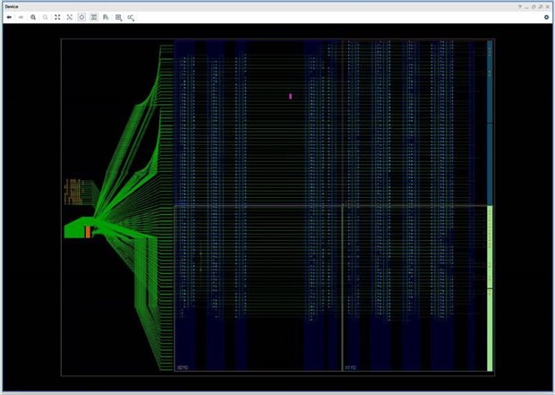

Looking into the device blocks generated in RTL level on the fpga
How the full device connectivity to different blocks look like. BY hovering over the lines one can see detailed descriptions of each of the connections.

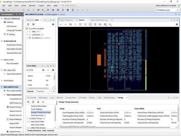

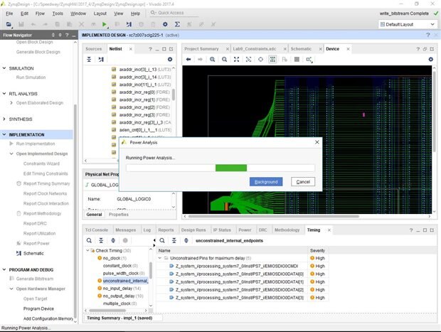

Reading the timing reports after the power analysis
Power analysis Summary
