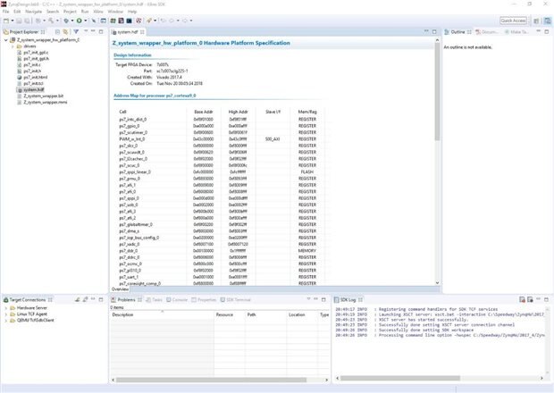

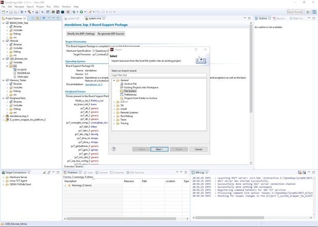

Experiment 1: Testing the software that handles PL-generated interrupts and utilizes an Interrupt Service Routine

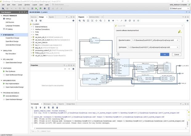

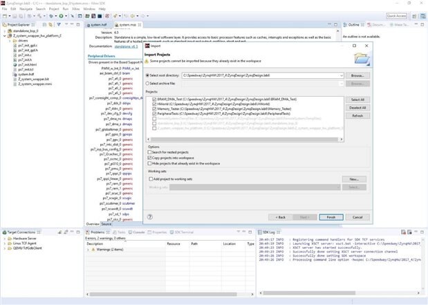

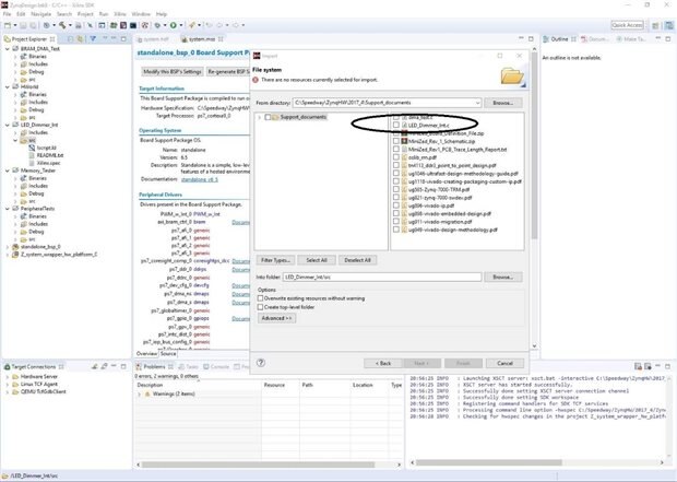

In this first part of lab 8; the previously created applications in lab 6 are imported with software files such as BRAM; Memory tester; peripheral test and a new application in software was added called LED Dimmer. This led dimmer application is created using the standalone bsp as shown below. The software C source files for LED dimmer were given to us in the support documents which I integrated in the project. Here then I learnt about the ISR (PWMIsr) and Interrupt System (SetupInterruptSystem) functions.
Fullscreen 6330.contentimage_105461.html Download
<html><head><title>Jive SBS</title></head>
<body><font face="arial,helvetica,sans-serif">
<b>Error</b><br><font size="-1">
An general error occurred while processing your request.
</font></font></body></html>
Creating workspace for lab8
Ready to import the C files from lab 6
Imported all the software files such as BRAM; Memory tester; peripheral test
Added the LED Dimmer ISR routine to the Lab8 project and ready to test the led dimming code.

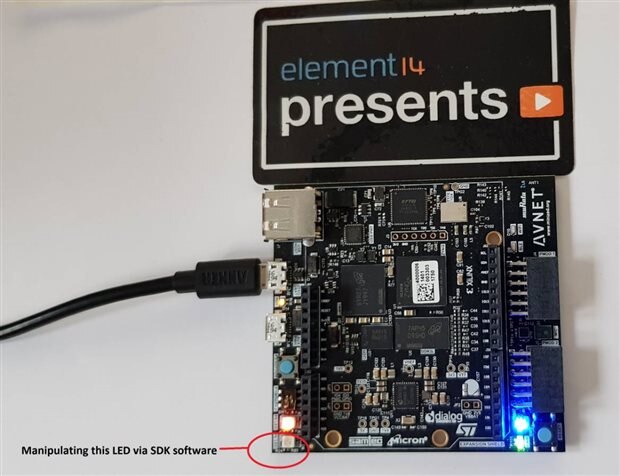

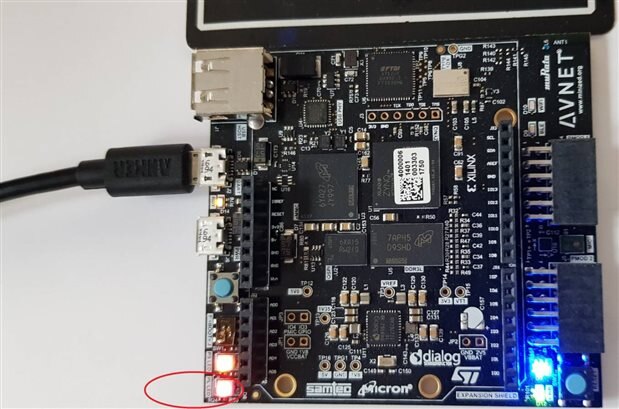

The Test Results for LED dimmer control at PL LED via software in SDK
The final control of the results.

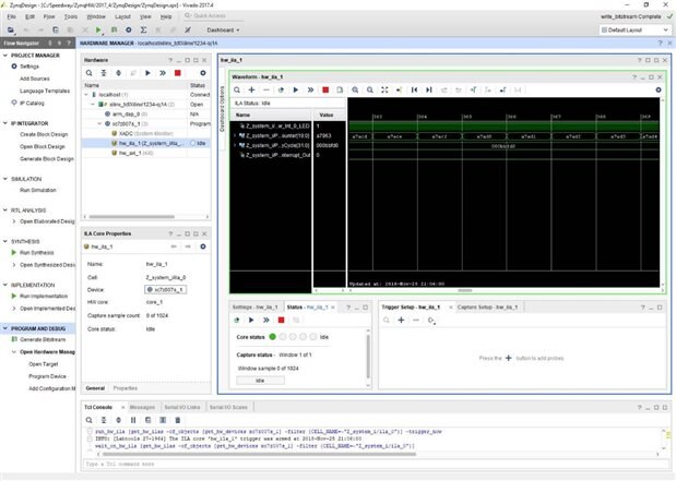

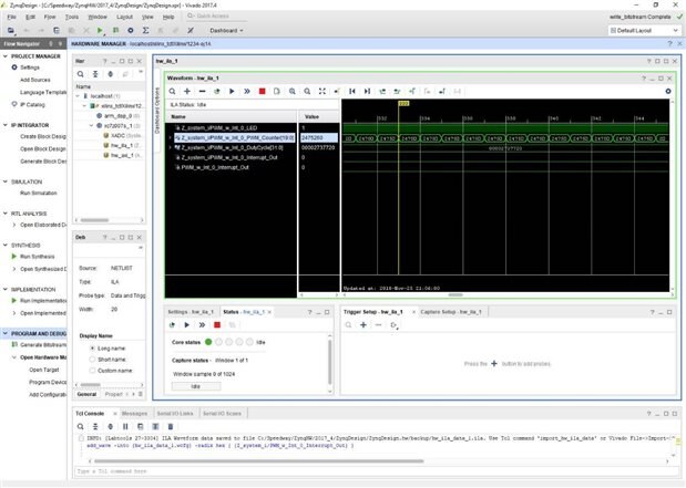

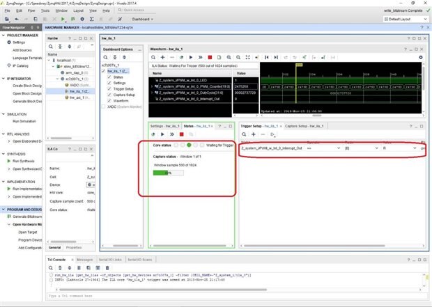

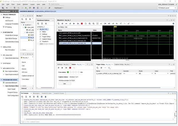

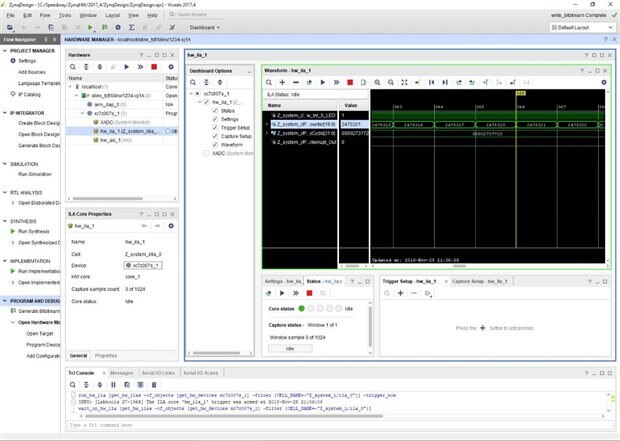

Experiment 2: Vivado Hardware Analyzer

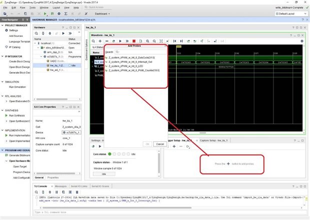

The ILA core is alternate to the chipscope which many have used in ISE. The ILA feature is integrated in Vivado and not stand-alone as it used to be for chipscope before. I really like this feature as it is quite handy is debugging the hardware signals and finding first unknown issues in a custom design.

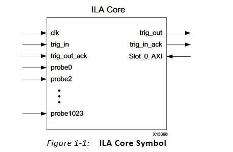

What is ILA core?
The customizable Integrated Logic Analyzer (ILA) IP core is a logic analyzer core that can be used to monitor the internal signals of a design. The ILA core includes many advanced features of modern logic analyzers, including Boolean trigger equations, and edge transition triggers. Because the ILA core is synchronous to the design being monitored, all design clock constraints that are applied to your design are also applied to the components inside the ILA core.
imageimage More info can be read here on the ILA core https://www.xilinx.com/support/documentation/ip_documentation/ila/v6_1/pg172-ila.pdf

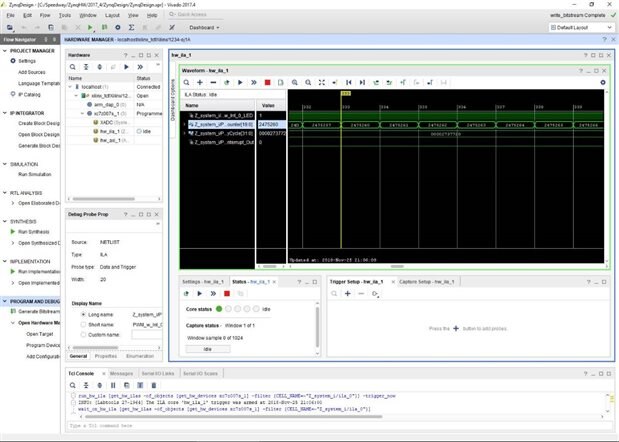

This experiment shows how to open and setup the Vivado Hardware Analyzer. We’ll capture hardware events and trigger on exceptions to validate the hardware design.
{gallery} Vivado Hardware Analyzerimage
ILA Vivado Hardware Analyzer
ILA Vivado Hardware Analyzer Properties

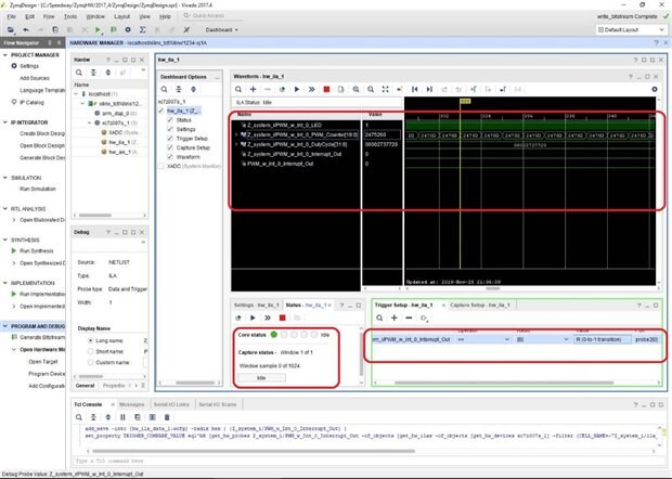

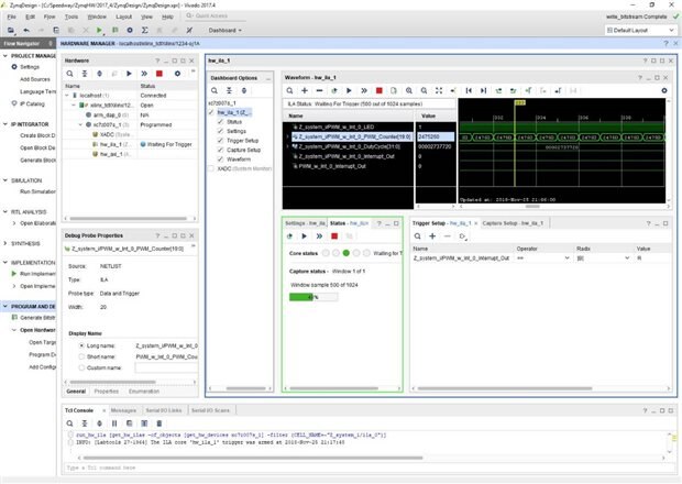

{gallery} My Customized Tests in ILA Vivado Hardware Analyzer
Customizing Tests in ILA Vivado Hardware Analyzer
Playing and Customizing Tests in ILA Vivado Hardware Analyzer

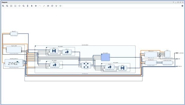

The new modified vivado project with the Customizes IP
The new vivado project with the Customizes IP

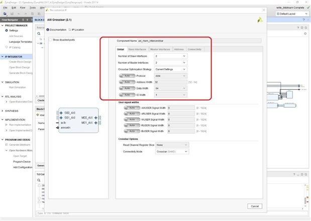

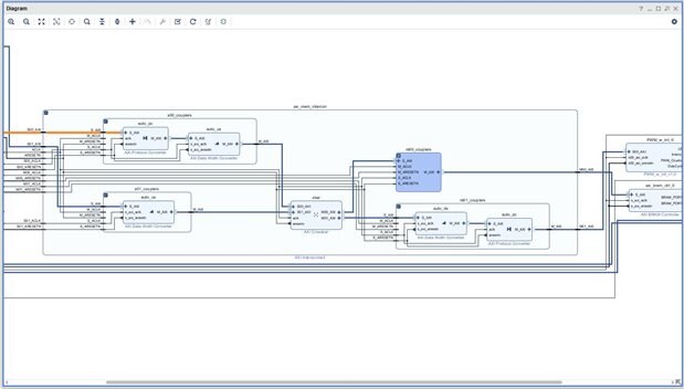

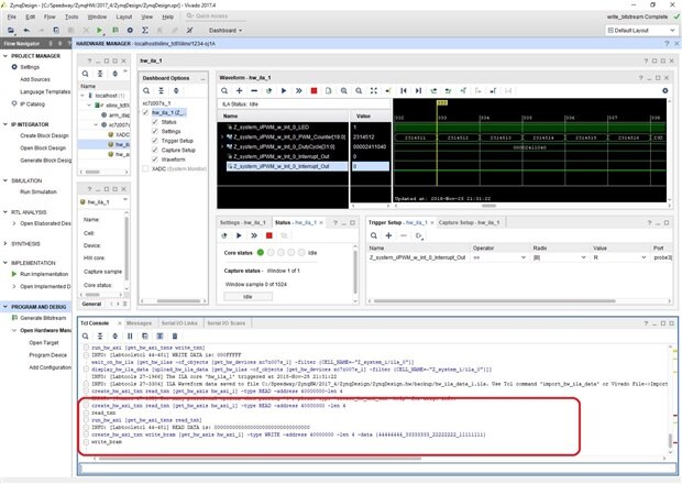

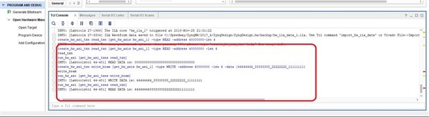

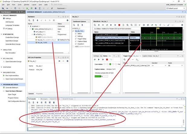

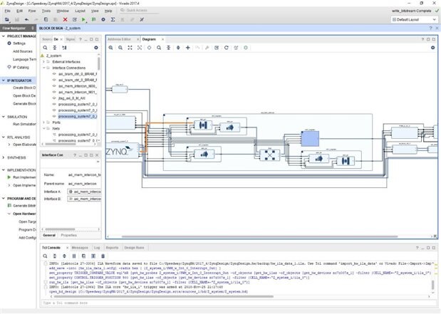

Experiment 3: Run-time Interactions with the AXI
Again, it’s often very likely that hardware engineers will not have software code available when they are ready to test their IP. For this reason, Xilinx has created the LogiCORETm IP JTAG-AXI core. This experiment shows how to interact with the JTAG-AXI core. We’ll perform AXI transactions through the AXI JTAG Master via TCL commands to perform run-time interactions to test the IP cores. Currently the software is running from the PS and sending commands to our peripherals through the AXI Interconnect.
Playing with the hardware final design and looking into signal flows between the ip cores
Using tcl scripting to write to the ILA core.
Adding parameters to the ILA core via TCL scripts to test the built hardware
