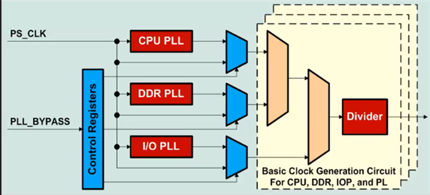

          Minized is a Processesor First device , which means the PS (Processing System-Our ARM) starts at first and will configure the PL(Programable Logic - Our FPGA) such as the clocks required for PL are generated by PS PLL(Phase Locked Loop) for instance.
Moreover,the PS system is Hard IP(Intellectual Propery) meaning that the PS blocks are already there on the Silicon but the Peripherals and the Configurations(how PS should run) is selected by user by including the PS IP which generates the BitStream which is responsible to reflect that Configuration in PS.
for eg: Consider above Diagram,we usually set the CPU frequency,DDR frequency and I/O frequency in the Configuration window , vivado will generate Bitstream such that the Multiplexers are activated appropriately and the Divider  may also be altered. By Disabling Clock to PL the Mux reroutes such that No clock reaches PL

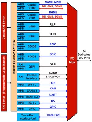

3.Why we select some peripherals in MIO configuration to use through MIO and other as EMIO
MIO (Multiplexed I/O )pins are the pins that are connected to PS gpio pins where as  EMIO is Extended-MIO which refers to PL pins.All peripherals cannot be connected to MIO as there are just 54 pins available (as shown below) , so based on the preference and some timing Constrains (for Eg:QSPI,USB) the Multiplexer maps 54 pins to the peripherals based on the data in Bitstream file which is generated by vivado from pin assignment in MIO configuration given by the User.
Usually when Assigning the MIO pins to peripherals in Configuration page , it is preferred to assign from top peripherals to bottom.
But the First Assignment should be made to QSPI (or SRAM or Flash meory) as it is responsible for Booting PS(remember PS starts at first before PL so that we cannot use QSPI/flash using EMIO ) and USB at Next is prefered as the EMIO doesnot meet the Timing Constrain imposed by USB protocol.
Base on this Criteria when we completed using MIO pins we can use the Peripherals through EMIO(their Access time is bit Slower)
Note:Gigabit Etherbet is routed through EMIO only.
4.Can you select different clock frequencies for the CPU, DDR clock , is there any criteria to be met ?
          All the Clocks are generated from a Basic Clock signal Input Frequency (usually 33.33 MHz) and this signal is used to generate the DDR,CPU & IO clocks by using DDR PLL,ARM PLL ,IO PLL respectively for each of the Clocks.Usually DDR PLL,ARM PLL are follwed by a Divider by 2 block hence we need to set the DDR,ARM PLL to run at 2*Desired Frequency.
Note that PLLs generate Clock signals that are Integral Multiple of Input Frequency based on this Criteria we can set different operating Frequencies as Desired.
