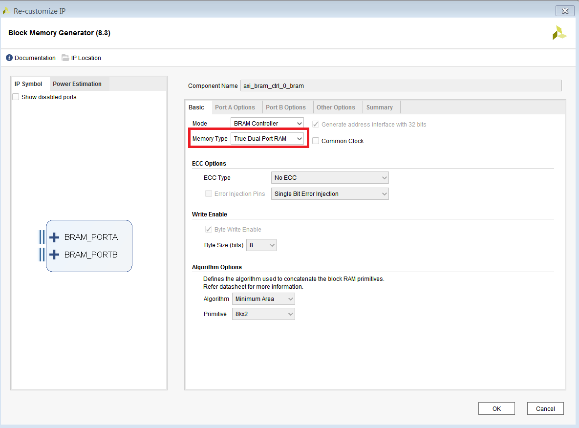

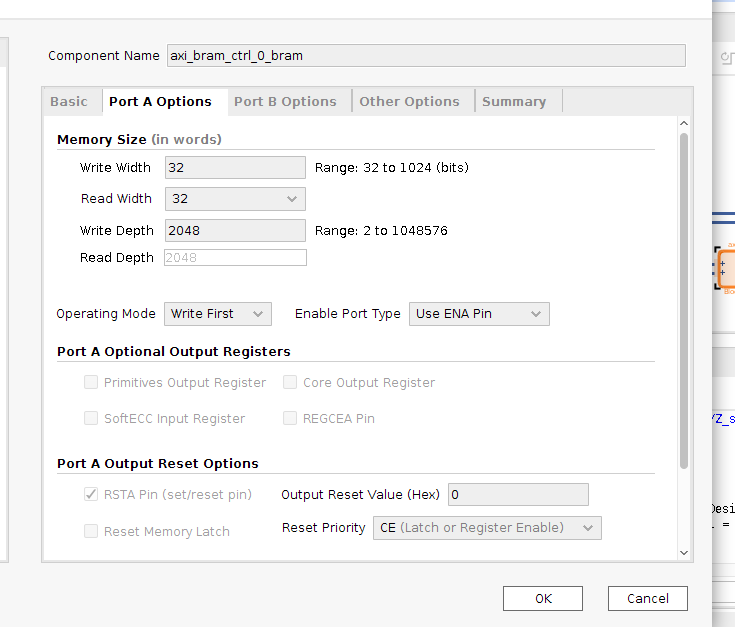

In minized we  implement it on PL fabric by using BLOCK MEMORY GENERATOR IP which creates the space (for bunch of data in blocks) and also the Controller where we selected Dual Port so that we can Read Data from One End and Write Data into it from Other End (more flexible than a FIFO) and also use it as a DDR for PL blocks to Process Data.
1.)In your Existing project just go for add IP and type "GENERATOR" and select the "BLOCK MEMORY GENERATOR IP"
Configure the Controller as you wish based on your Requirement , For instance I used these settings :

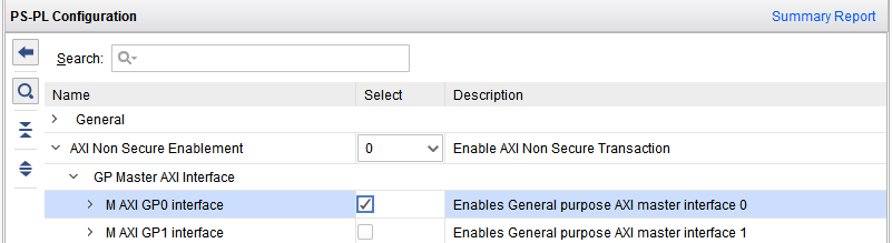

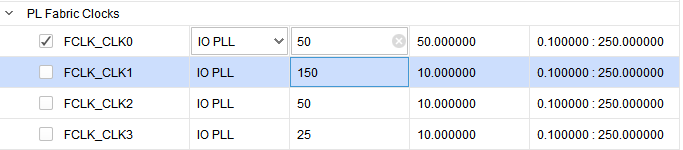

a.)Reconfigure "ZYNQ7 PROCESSING SYSTEM" ip block to Enable Fabric Clock 'FCLK_CLK0' in 'Clock Configuration' section for PL (every system needs clock Isn't It) and
b.)Enable 'M AXI GP0 Interface' in 'PS-PL Configuration'

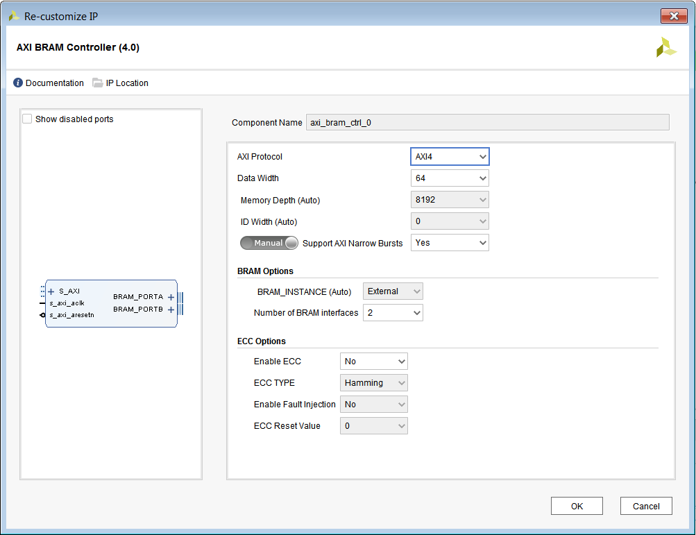

3.)Add Another IP "AXI BRAM CONTROLLER" and configure it based on above settings (for Instance)as shown below  :
What Is this AXI ?
AXI is simply a bus Standard in which there will be a master and slave , the master generates the control signals to decide when to transfer or allow slave to send Data , we use multiple masters and slaves by means of AXI interconnect(we will see it).
What is This AXI BRAM CONTROLLER used for ?
It acts as a Bridge to connect PS to BRAM Controller, since we are using AXI bridge we need to make sure BRAM Controller to understands  AXI's language , so we add this IP to our Design.

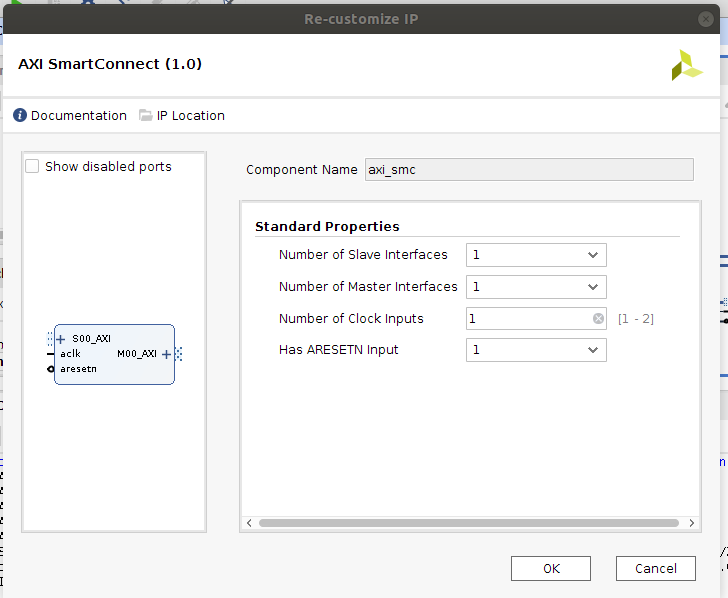

4.) Add 'AXI Interconnect' (If you got More Devices) or 'AXI smart connect' (for single device) IP in your Design to connect the Master AXI of PS connect to the above PL blocks seen as Slaves .In my case i sort for AXI Smart Connect (because Small Work Isn't It image):

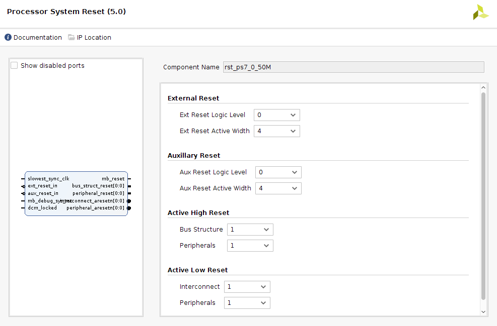

5.)Add "Processor System Reset" IP which is neccesary to prevent crazy things to happen and Synchronize it by reseting PL blocks to some known state

On starting the minized the "Processor System Reset" resets the PL,AXI(other peripherals if any) and maintain them in a predefined state until PS starts up and running.

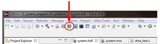

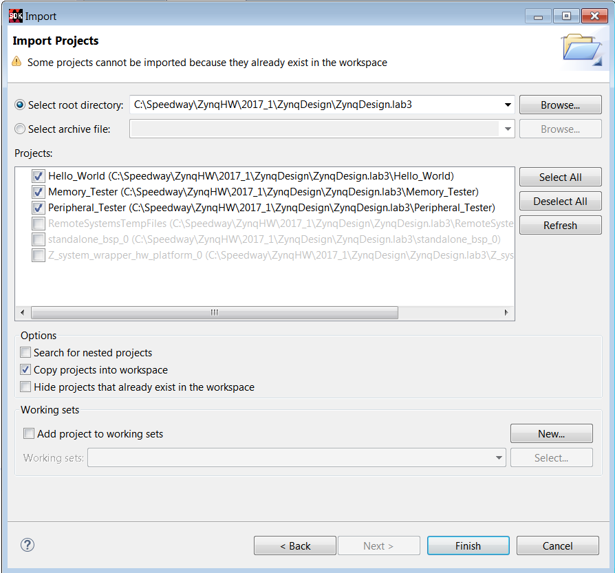

1.)In SDK, Create a New BSP -> Import your previous peripheral projects for using those devices such as UART for serial communication
2.)Create a new application project (File ->New -> Application Project)
3.)Enter BRAM_DMA_Test for the Project name and select Use existing for the BSP. Click NEXT ->Select Empty Application ->Finish.

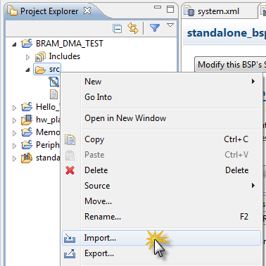

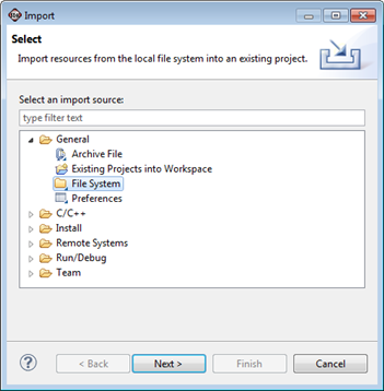

4.)Then Import the BRAM program code(attached below) into your Project src by:
Select the Path where you stored the "dma_test.c" attached here and select this file -> Finish

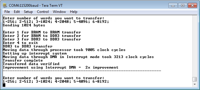

  • mu.udhay
    mu.udhay over 8 years ago in reply to DAB +3
    Hi DAB , thank you for the Remainder , I placed the screen shot of my test results below: As we can see by Increasing the Block size of transfer through DMA we are getting higher Performance over transfer…

  • mu.udhay
    As we can see by Increasing the Block size of transfer through DMA we are getting higher Performance over transfer through PS with upto 22x , huge PS computing time can be saved by using DMA.
